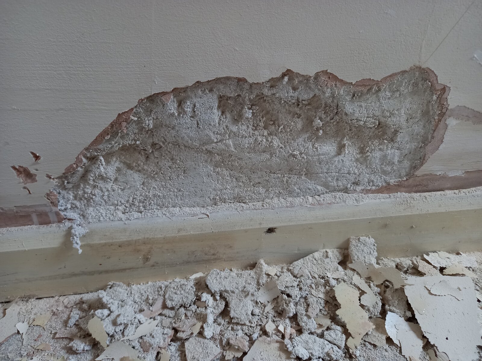

Anyone know what this is?

It's beneath the skim coat.
Hopefully not as per my suspicions (the dreaded A word) :-/
It looks a lot like one of the light weight base coats ,a grey version of carlite browning .I stripped several rooms of the stuff in the last few years.
