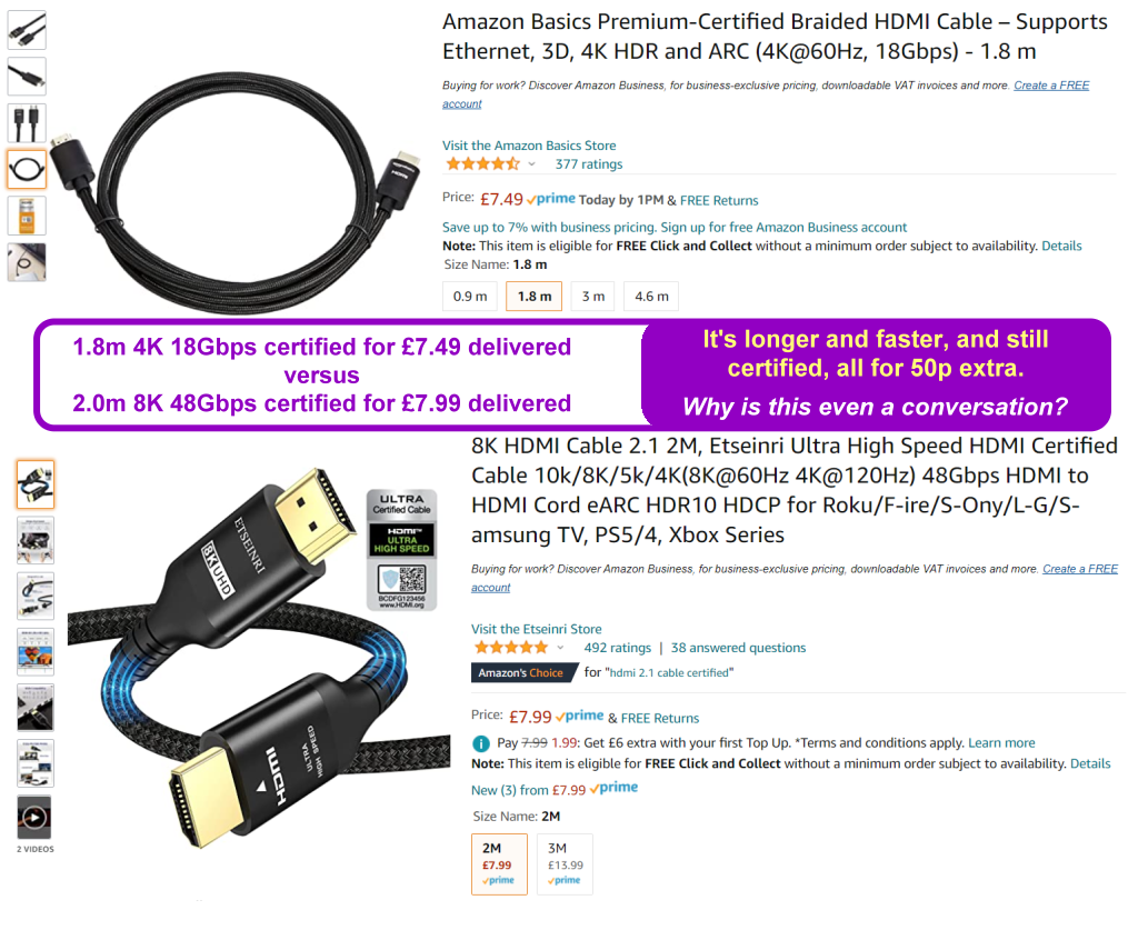

Due to the resolution and frequency limits of the PS4 Pro, you only need a 'Premium High Speed' cable to support 4K @ 60Hz.
Though an 'Ultra High Speed' cable probably wouldn't hurt! ;)
...as long as it's certified of course!
Maybe I'm missing something here, but the two cables linked are just 50p different in price. £7.49 vs £7.99. I had a single portion of cod and chips last week that cost more. Are you really debating the prices?
