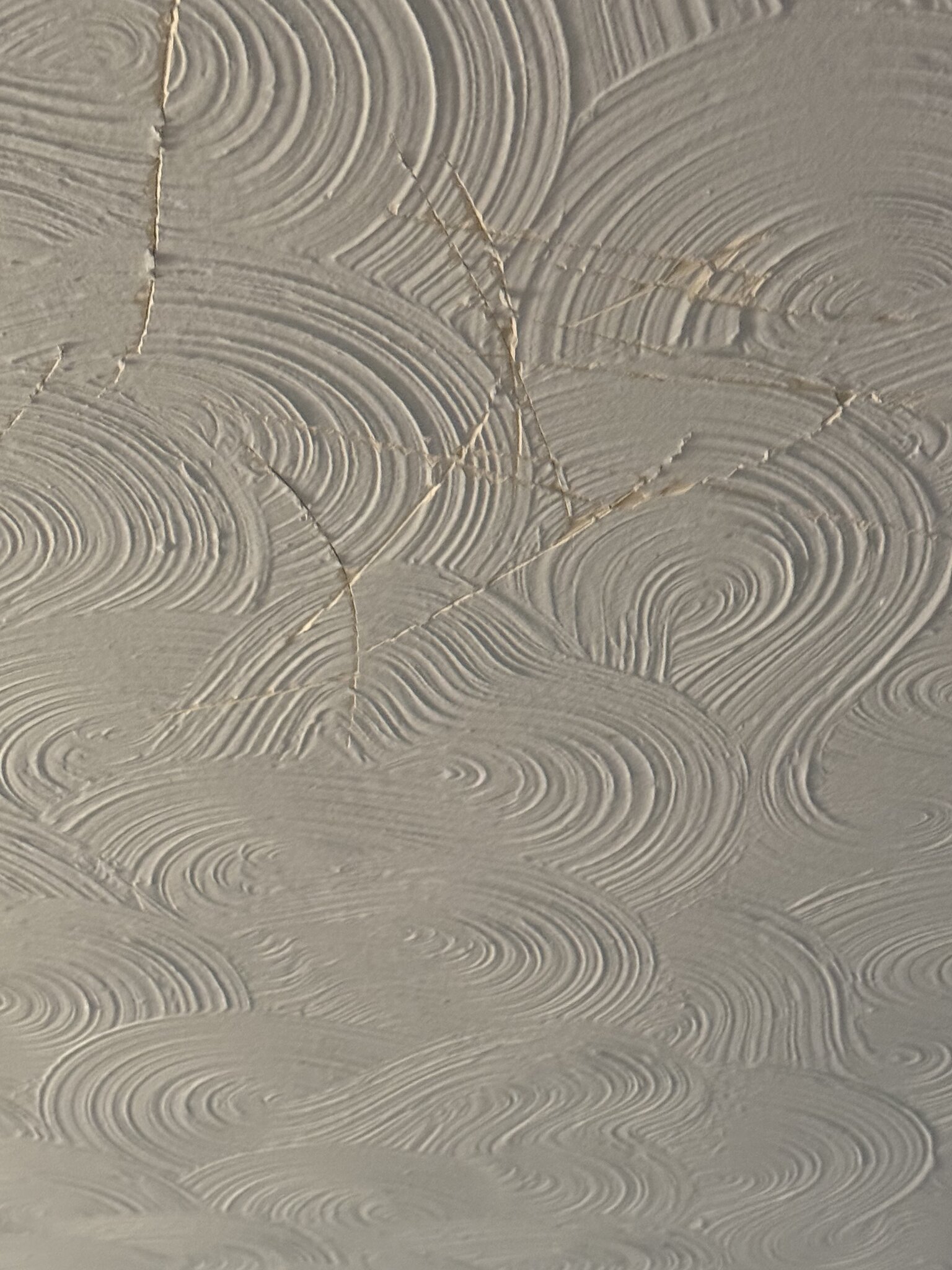

I don't think is has asbestos in it.

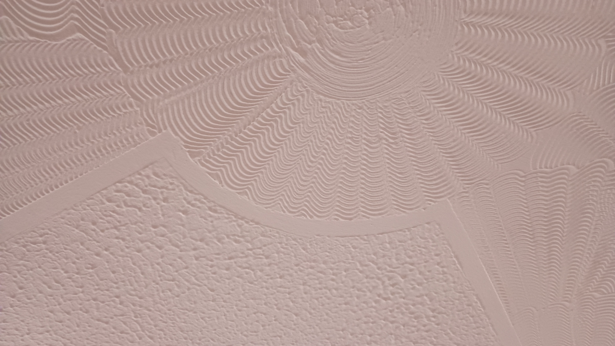

That's scroll pattern and that was not being done in 1984 ish when asbestos was take out of artex. Last company to have take asbestos out of the material was suretex in 1986.
Asbestos in artex looks sugary and sharp. That looks creamy. Don't mean I'm right I know. I've been told it can be trace amounts still in factory for a few years. Hum?
I'd be very surprised if that had asbestos in.

I agree with the above. We have both varieties, I've had samples from all rooms tested. The stuff with asbestos has sharp peaks, the stuff without just looks like thick paint, as yours does.

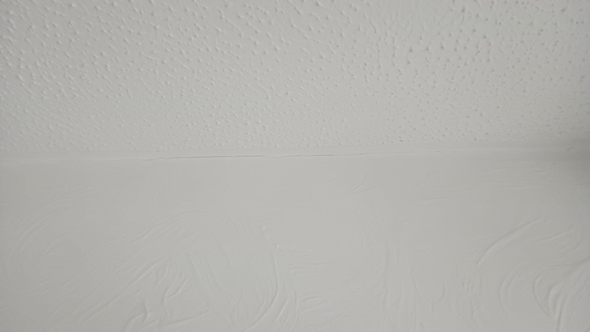

Some samples I've had tested from my house...
Definitely contains asbestos:
Walls (swirly pattern) definitely DON'T contain it, can't remember if the spikey ceiling was tested but it was all artexed at the same time so hopefully not:
DISCLAIMER: Definitely DO NOT rely on the appearance as proof of not being asbestos. But I'd say it indicates that you may have had scam advice so get some proper testing done.
Among others. Check accreditations first.
If it's asbestos you may see some tiny fibrous sparkly bits in the sample as you bag it. Way smaller than a human hair, almost glittery.
