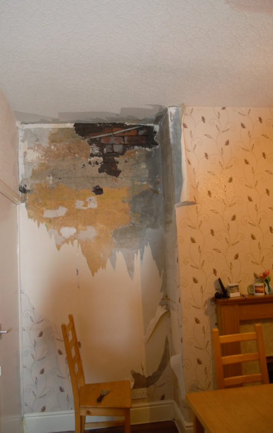

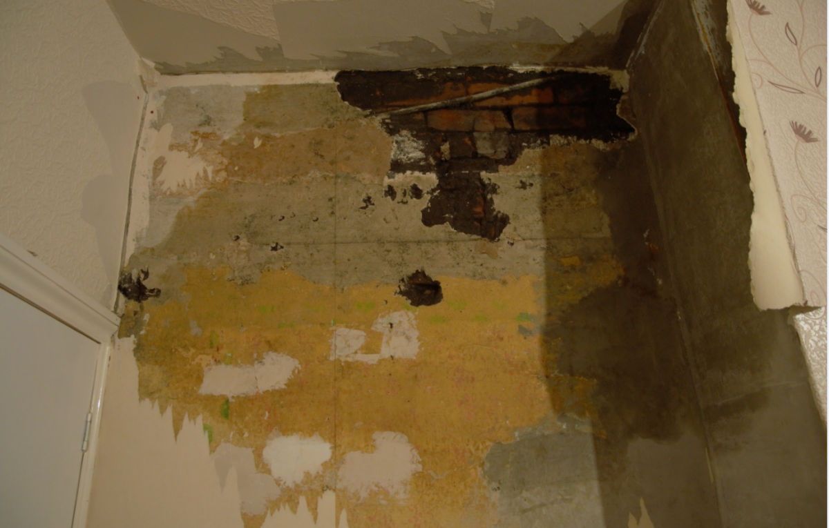

The story, my neighbor has a leak and it got so bad that finally I noticed it.
I stripped down the wallpaper and underneath I found crumbling cement or what, I started to take it away and the a doubt struck me, could this be asbestos? Any idea?
I am panicking now, here two photos I took

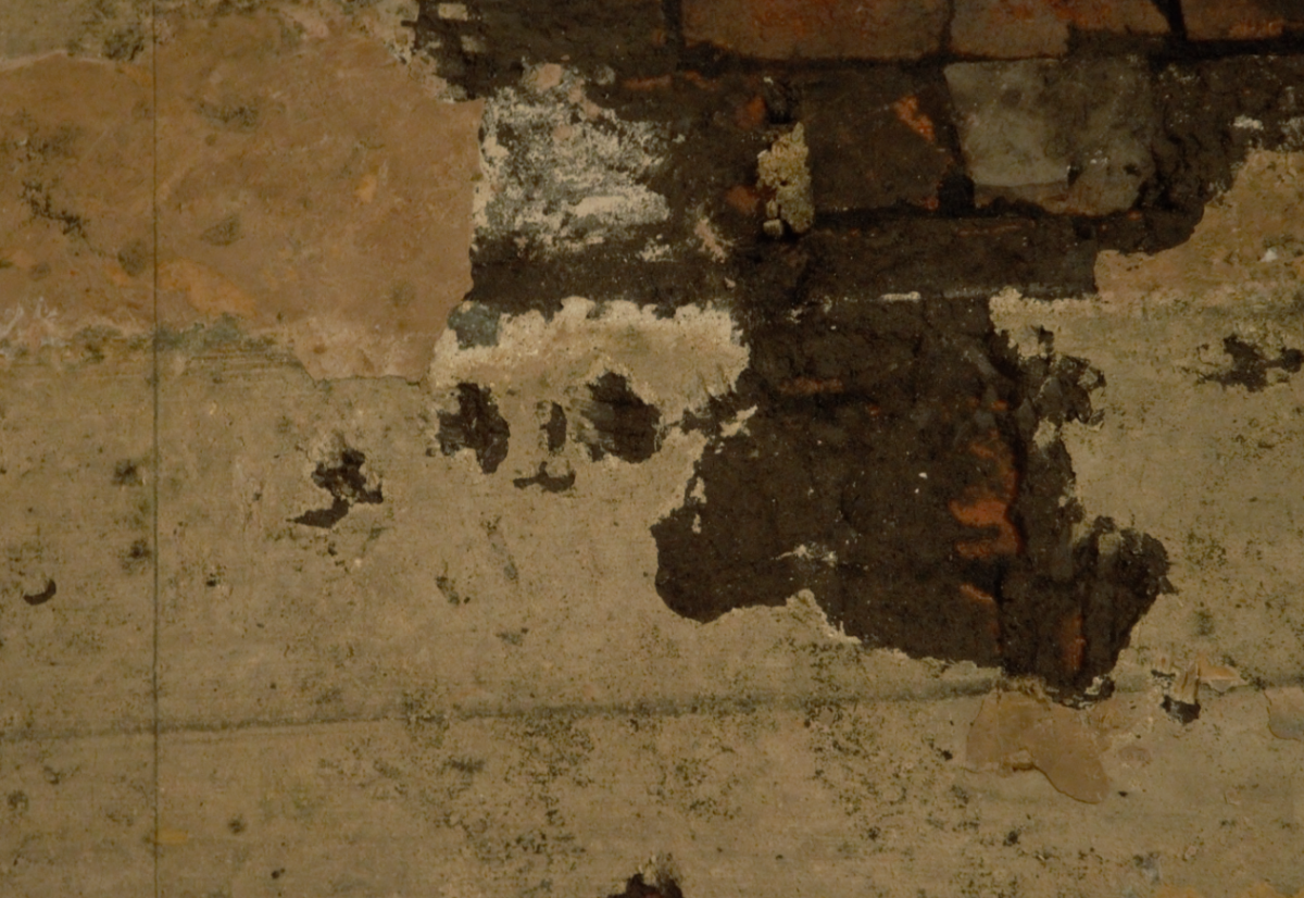

I would be very surprised to find asbestos plastered on in a domestic situation (only used in commercial situations around pipes tanks etc and usually white / light grey in appearance) unless it is artex which is white and will be a fairly thin coat which it does not look like. From the photo to me it looks like a weak cement render.
If it worries you still it can be tested even looking directly there is no certain way to identify asbestos, even less from a photo, but I don't think you need to panic.
Thanks! I will get that tested anyway but now I am feeling better :)
As the wall is all wet, do you think it's a good idea to take it all down or should I wait for it to dry and put cement/mortar on the holes?
It shouldn't be asbestos on the wall like that ,it could be old lime plaster it looks like there was something going thru the wall and it has been taken out and bricked up (badly). What is other side of wall? What is that pipe in the wall Is it steel or lead, or copper?

As you can see from this photo it's all wet and it's coming down.
I wonder if taking all the plaster down would be a good idea, I have also noticed that the brownish thing between the bricks is coming off easily. Should the wall be repointed?
What's above that area is there a bathroom around that area? That pipe may be a water pipe and may be leaking, check it out...Forget about repointing till you have found out the source of the damp.
There's no asbestos there. Lead pipe is redundant gas lighting. I hope your neighbour is compensating you for the damage?
Wait for it to dry before you do any repair, to be sure the source has been identified.
