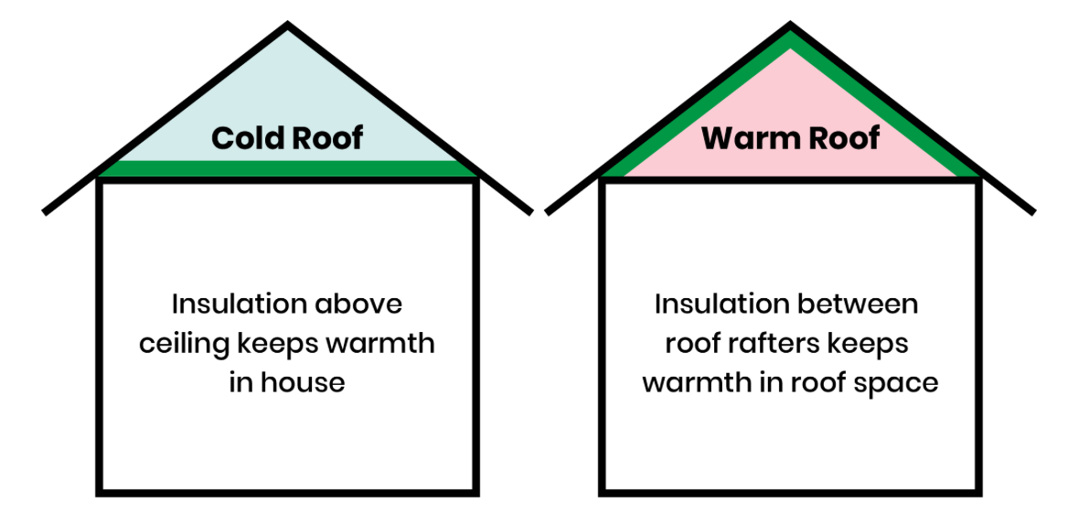

I have to say it's confusing because if you look at the regs for loft floors it indicates a minimum 270mm depth is needed for say earthwool or 150mm for PIR board. Why do the regs look for such thicknesses if it's not a physical requirement in reality ?
If you just have a open loft/attic then the floor (or really the ceiling insulation of the room below) should have 270mm of loft insulation material in new builds (or equivalent). If you are converting your loft/attic into an habitable space then the roof requires to be insulated with the appropriate materials to achieve the prescribed U vales of the building regs and floor insulation for heat retention is irrelevant
Ok thanks and clear now. For the floor area, I'll go forth with 150mm PIR board. Some earth wool making sure a slither of gap is available for air flow, with 22mm caber board flooring ontop.
but you just said that you're going to convert your loft to a habitable room one day..
So if you're going to spend money buying and installing insulation, fit it to the ceiling of the loft not the floor of the loft. This way you only buy it once and you still end up with a continuous warm envelope for your living space
Builders do cold roof because it is easy, quick and cheap. Warm roof is slower, harder to get right and more expensive. In both scenarios the roof insulation joins up with the wall insulation to give a continuous insulated layer for the inhabited space
Based on the warm roof scenario, can i still use 150mm pir to insulate the roof space?
