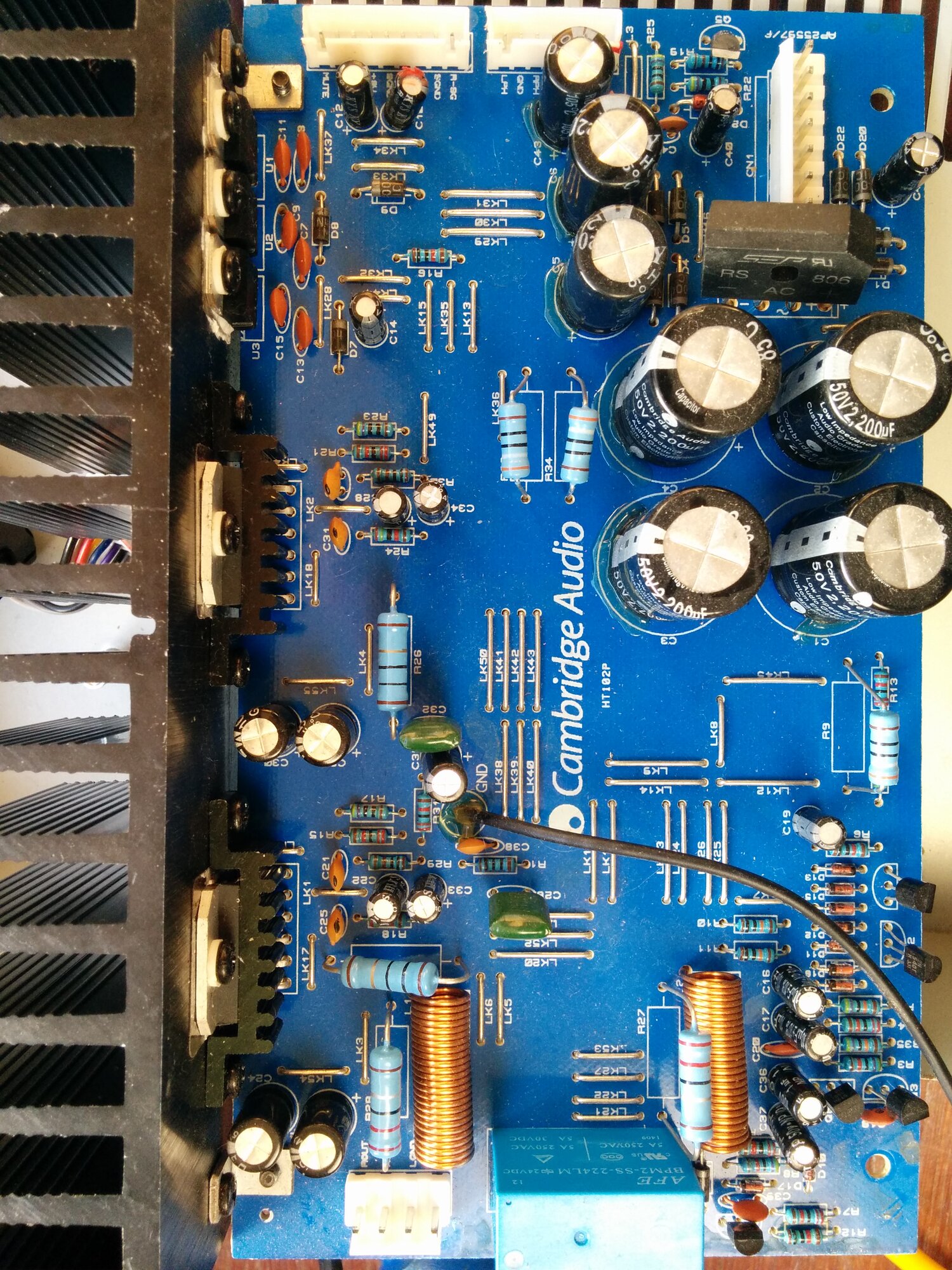

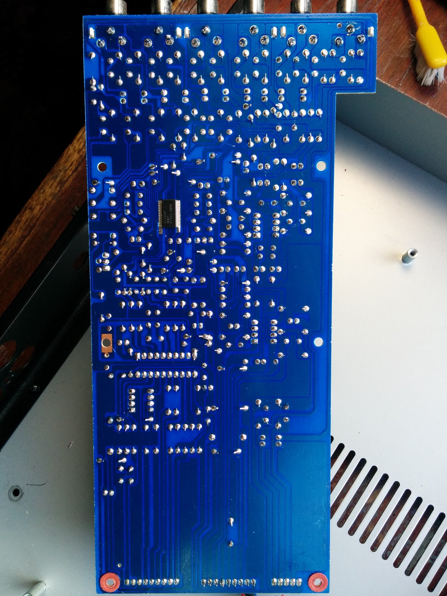

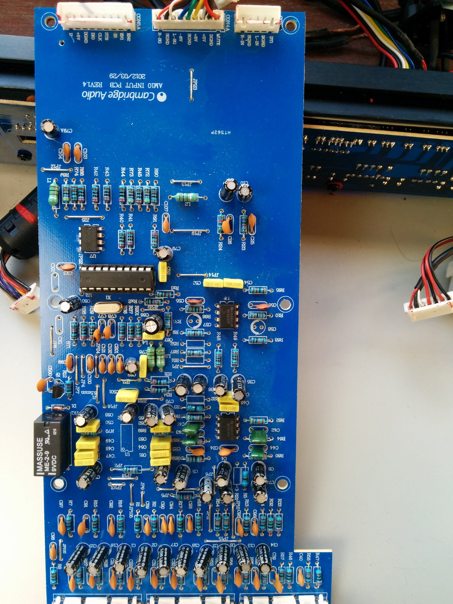

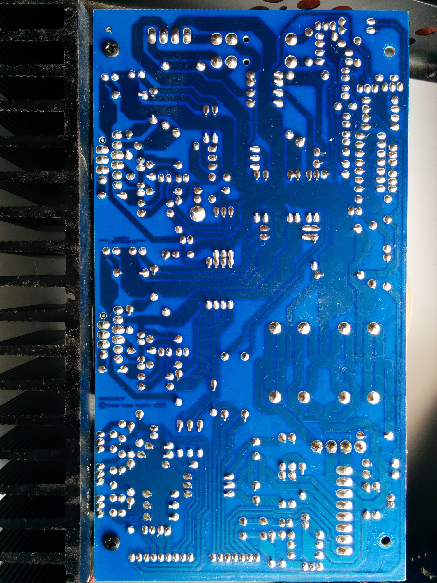

If you can post some good quality pictures of the PCB, we can have a quick nose around! :)

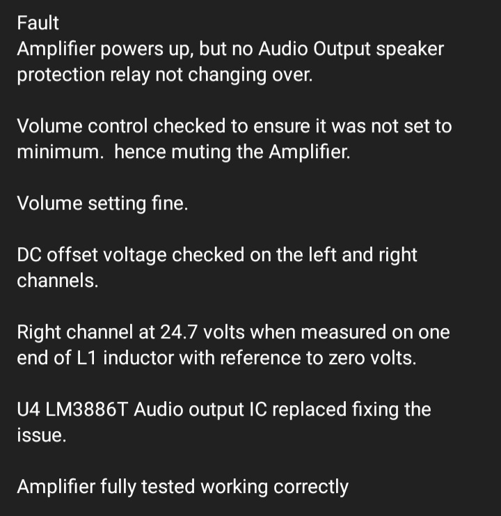

Was looking to see if Capacitor falure was causing voltage regaultion increase and found this horrible video showing a similar issue to yours.
For them it needed U4 a replacemnt LM3886T Audio output IC.

Here's the video description:
...and checking the DC offset on the output could be interesting! :)

Hope to take some pictures fairly soon, though there is nothing obvious to my untrained eye, caps not looking blown as one might imagine for a relatively newish model from a reputable manufacturer. Power amplifiers haven't vapourized their thermal paste.
