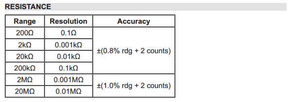

That's what it says.
http://www.farnell.com/datasheets/2169216.pdf
"autoranging" is indeed the term for a multimeter that switches between ranges automatically. Note that this does take time and some meters are faster at selecting the range than others.
That meter should be fine for measuring most normal resistors, though you can certainly buy resistors that are too high or too low value for it to measure properly.
