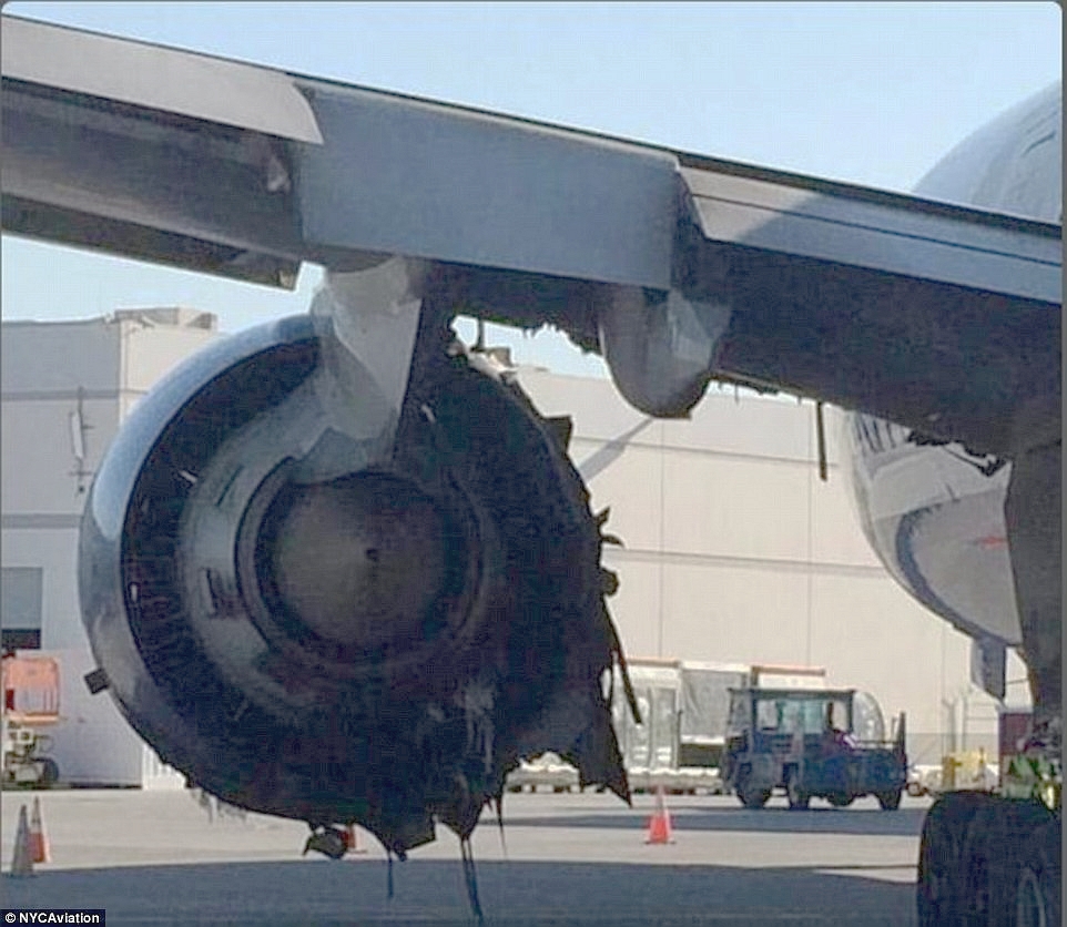

A different angle - 'Lightened' the images to show more detail, the big compressor fan looks ok.
Possibly something(s) / shrapnel exited the casing in the 7-8 o'clock region.
I wonder if there was a combustion chamber failure... Interesting innit ?

A possible cause is the failure of a high pressure turbine blade. These things are sometimes made from a single crystal of nickel, and rotate at very high speed, driven by high temperature gasses. Consequently if one breaks it could easily fly out the side of the engine, and cause a catastrophic engine failure. As said, they are incredibly lucky this did not happen during the takeoff itself, or in flight, given that the wings are giant fuel tanks.

Looks like HP Compressor - Disk failure.

  • British Airways flight 2276, a Boeing 777-200ER, equipped with two GE90-85B engines, registration G-VIIO, was operating under the provisions of 14 Code of Federal Regulations (CFR) Part 129 and was enroute to London - Gatwick Airport (LGW), Horley, England.
  • There were 157 passengers, including 1 lap child, and 13 crew members on board. There were several minor injuries as a result of the evacuation (mostly abrasions).
  • The flight data recorder, cockpit voice recorder and quick access recorder have arrived at the NTSB Vehicle Recorder Laboratory and are currently being downloaded.
  • On Tuesday evening, the airplane was photographed and the runway debris documented by FAA and airport officials before airplane was towed to secluded area of the airport (in order to reopen the runway).
  • Initial examination of the left engine revealed multiple breaches of the engine case in the area around the high pressure compressor.
  • Examination of the material recovered from runway found several pieces of the high pressure compressor spool (approximately 7-8 inches in length).
  • Initial examination of the airplane by NTSB revealed that the left engine and pylon, left fuselage structure and inboard left wing airplane were substantially damaged by the fire. This damage will be documented over the next several days.
