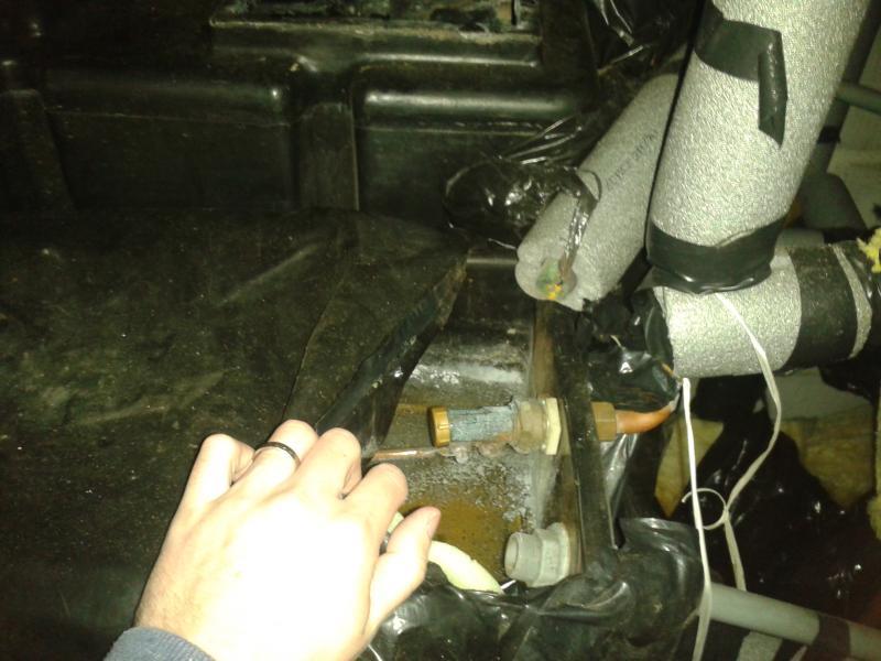

A coal fired back boiler does not have as manner tank. If you have water coming out of your hot tap the boiler should be full. Assuming of course your boiler is connected to your hot water cylinder.
There should be two large pipes on one side of the cylinder, these are from the back boiler and the top one should get warm when the fire is lit.
You need a good roaring fire and there should be a Damper that will need opening to pull the heat behind the boiler. The damper will be found toward the top of the fire opening and will normally be pulled towards you.

If it's connected to the cylinder and cylinder is full then no problems. If it isn't connected to cylinder it should be drilled to remove dead water.
Jeff

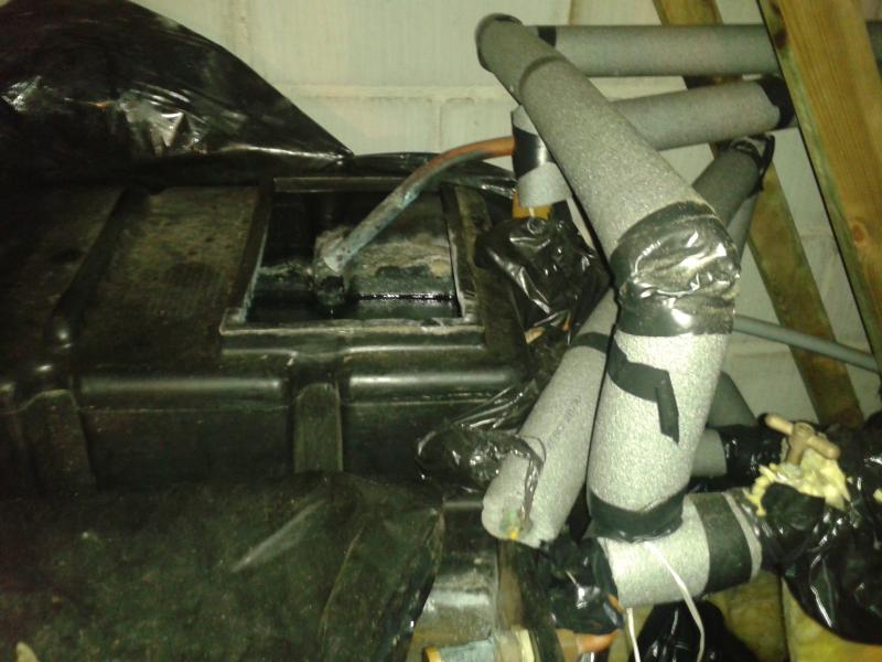

I went into the loft last night and found a smaller tank which is a start.. It was full of water but there was a pipe that looked like it had something over the top of it... However this was out of the water at the very top of the tank so not quite sure what this would do.
I'v aattached a couple of pictures of the tank and the capped pipe. The tap that is seen in the picture is open also.
Any suggestions?
Just an update....I have had a fire going this morning and noticed there was a metal plate infront of a hole which I believe is the back boiler in the fire place...I removed this plate out the way (our dampener is broken open) and it seems as though the water started to warm up...one of the pipes going into the immersion was warm too.
The fire did go out after about 20 minutes...as this is something I need to learn to do properly haha. So we didn't get much heat, but it certainly changed temperature.
Does this sound as if it is all working okay? It looked promising to me...
