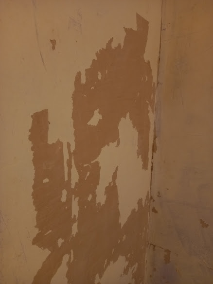

I have removed some wall paper.
A thin coating came off the wall too, in small pieces and in large areas. I guess this is the skim coat of plaster.
How should I deal with this. Should I put another skim coat over the whole wall, or just where the original skim coat came off.
Can I paint directly on the skim coat, do I need a primer or undercoat.

It looks like the old emulsion came off, rather than the plaster.

spot on - there's no signs of any plaster coming off - skim or backing.

Yes it does look like it is peeled paint. At least you saved me messing around with the other walls
So, for the remaining walls, would I use a patching compound like Easyifill 60 or Polycell Filla to level of the dips in the paint, before painting it again

The chimney breast in the corner has a vent. Is this chimney breast vent supplying through venting from this floor only or is it venting a flue from a chimney breast in the room below?
The marks on the walls that are blowing the paint could be chemical smudges from the old, unswept chimney flue?
I wouldn't use any Easyfill etc. until you have more idea of why the paint has blown.

Chimney breat is only on the first floor, it has been removed (I guess) on the ground floor.
The flaking paint is on most walls in that room, probably the most around the window.
There was wallpaper on the wall before, which I removed. Probably 2/3 of the peeled paint was already there underneath the wallpaper, and I about 1/3 came off with the wallpaper that I took off
