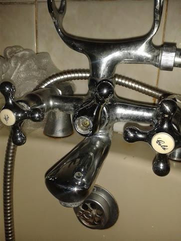

The lever to redirect the water from the taps to the shower head is loose. I have taken the screw cover off, removed the screw and tried to pull the lever off but the lever won't come off. I don't want to try too hard in case I break it.
I'm assuming that there's a rubber washer in there somewhere.
Any advice would be appreciated.
If you have removed the screw it will pull off the splines. Use some WD and prise it off with a large flat blade driver or something.
Jeff

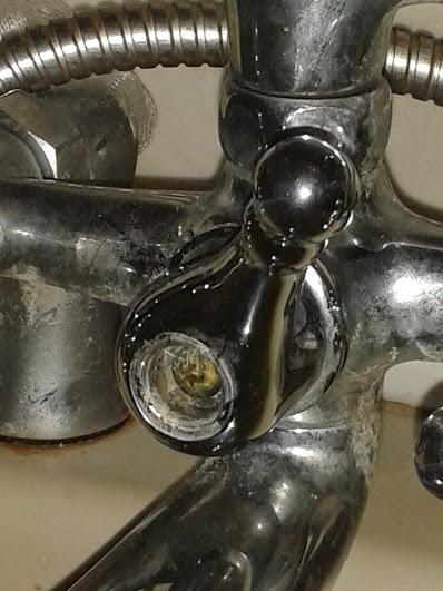

With a bit of wiggling I managed to get it off.
It looks like a brass pin has broken off.
Can you get a replacement part or do you have to buy a new tap?
