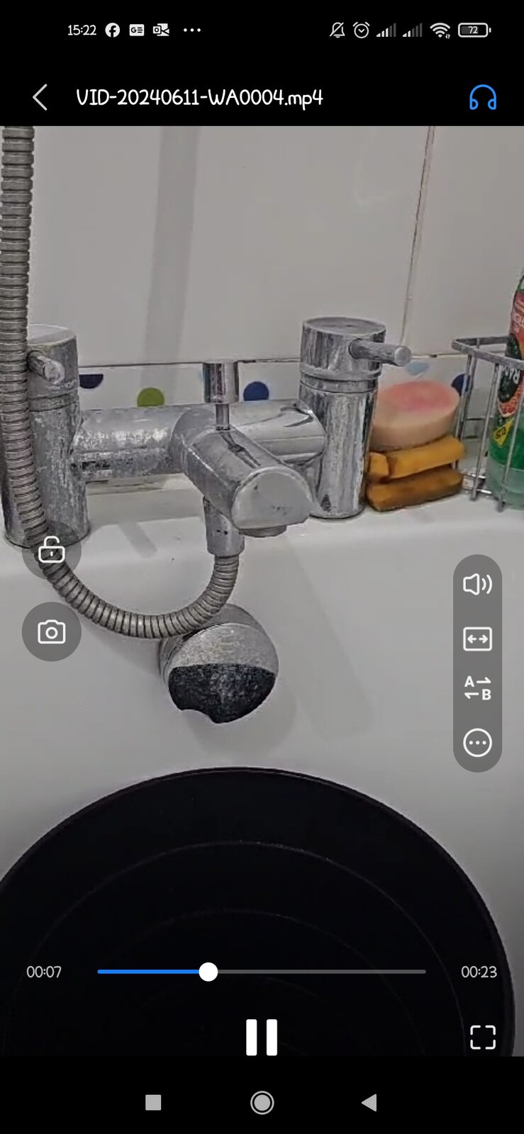

Hi
Water dripping from the outlet.
Could anyone please let me know which part need to be replaced? Thanks
If taps are closed and water continues to drip from the spout ,non stop, then one or both of the tap valves are passing and need replacing.
Often fitting a new complete tap is worthwhile if the tap is old.
