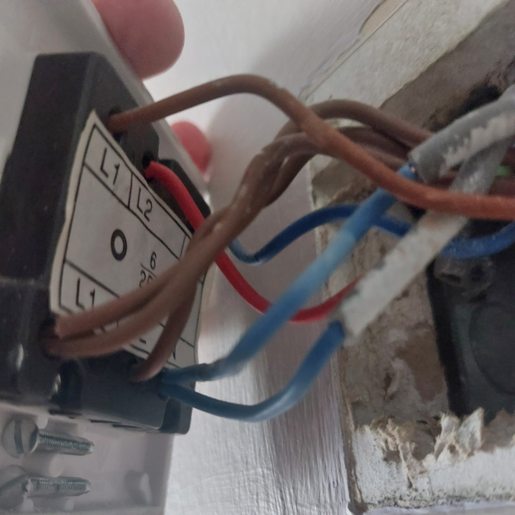

Bathroom fan switch

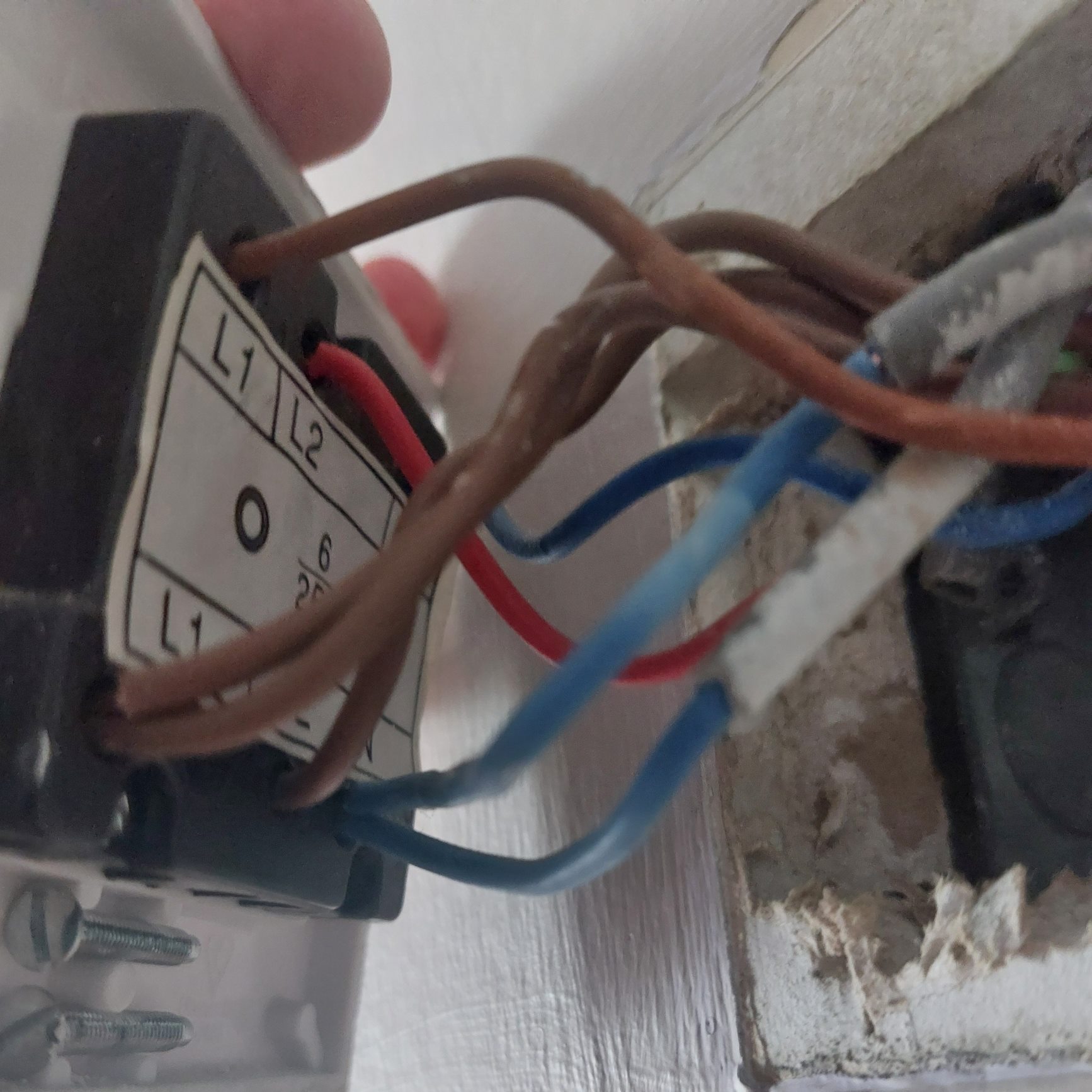

Adding 2 more photos of fan and switch wiring

didn't know that rule.
But that's not an intermediate switch.
probably a wiring error at the switch.
Start by seeing what colours are present at the fan if easy.

Is that brown and red wire in the same terminal hole ? Take one out.
To me a timer fan has been replaced with a normal fan
That's the problem in the orange circle, the 'permanent live' and 'switched live' should not be connected in the block together. I'll guess the brown is permanent however I can't be certain, the damaged blue requires repair in some way.
