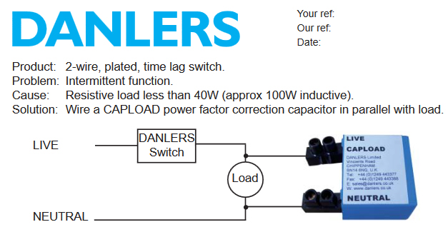

I have found LED bulbs a problem, but the problem has been flashing when off and shimmer when on, flashing stopped by adding load capacitor load-capacitor.jpg shimmer stopped by changing to a larger bulb G9-comp.jpg but the large bulb is not strictly legal to sell in the UK, as no wattage marked, or lumen marked, but cured the problem, however I have a draw full of bulbs, where I have either kept spares in days of tungsten, or swapped due to flashing or shimmer.

Sorry, room with problem had an electronic switch without a neutral. but same switch works A1 with standard single BA22d LED bulb, only with the G9 bulbs was there a problem.
Swap one bulb for tungsten and all worked A1, both flashing and shimmer, the flashing easy enough to get around with a load capacitor, it is the shimmer which is more of a problem.
The light switch has a relay that can be heard switching on/off, so I also have no idea why the shimmer when on. The good G9 bulbs have a large smoothing capacitor after the full wave rectifier which explains why they don't shimmer, but why with just one tungsten G9 other 4 LED G9 stop the shimmer is beyond my ken.
There is likely some interaction between switch and lamp, but only way to cure seems to be trial and error.
Ah! I suppose that using "an electronic switch without a neutral" to switch an LED load is "asking for trouble" (much worse the capacitive/inductive coupling in long cables) - with incandescents, one could get away with the inevitable small current through them when 'off', but with LED lamps/bulbs, it depends entirely what is inside them, and in some senses you're lucky that you didn't also have problems with the B22 ones!
I suppose it called be called an 'interaction' but the issue is surely likely to be the small current through the LED light/bulb (as a whole) due to the no-neutral electronic switch, with some LED lamps/bulbs flickering as a result but others not (quite possibly due to some internal 'bypass capacitor'). However, as you say, you're unlikely to discover 'which is which' other than by trial and error.
To avoid the uncertainties and hassle, I think I would probably do everything I possibly could to avoid using "no-neutral electronic switches" to switch LEDs! Indeed, I already do everything I can to avoid using 'electronic switches at all' - when I want electronics-controlled switching, I always try to use the electronics to drive a relay.
