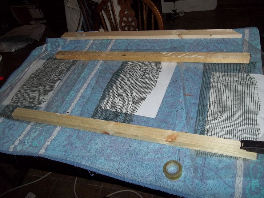

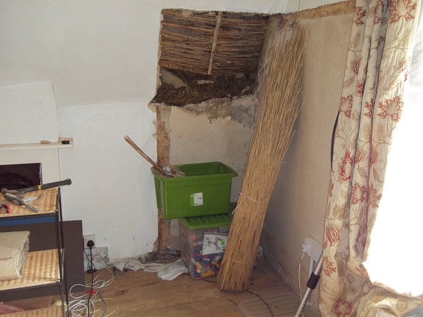

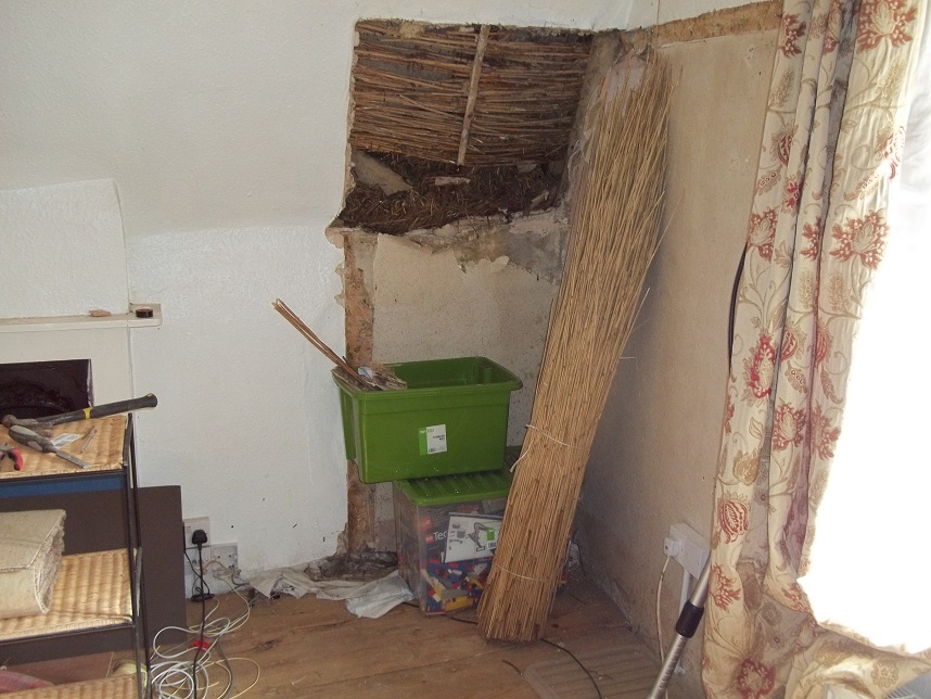

The previous owner had built a DIY wardrobe apparently to hide and maybe support a bulge in the sloping ceiling caused by a broken rafter under the thatch. The rafter is probably original and around 500 years old.
It has to be lime plaster with horse hair on reed ( conservation officer ) but the original reed was encased in cerment when the wardrobe was built.

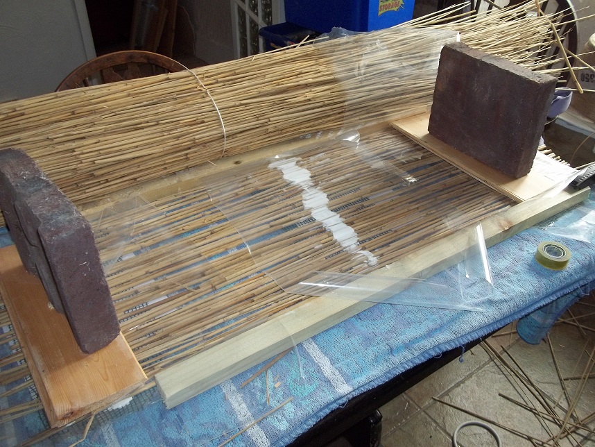

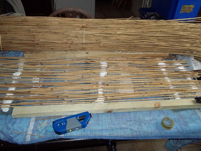

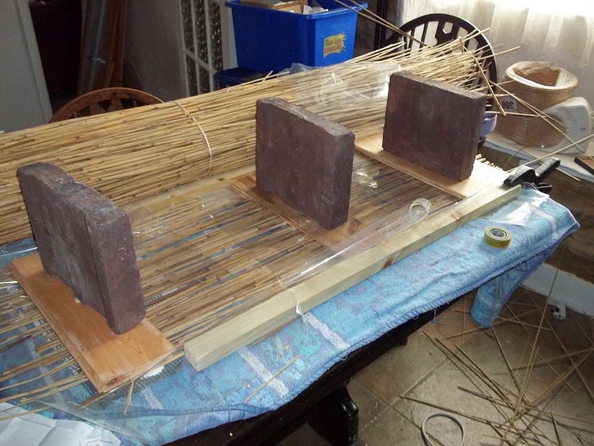

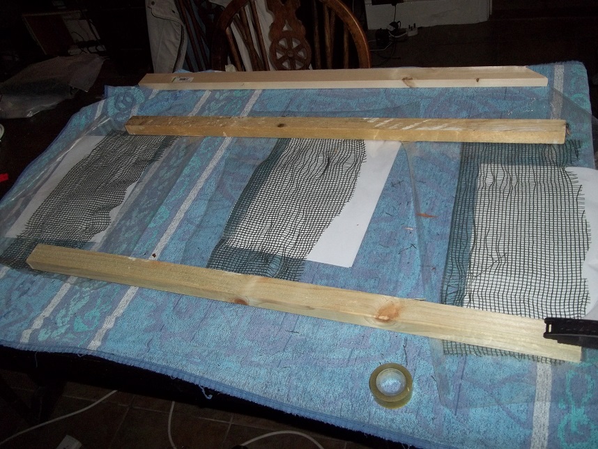

Rather than pinning each new reed in place individually I am hoping this mat of reeds glued to netting is going to be satisfactory.
reed pad_0.jpg reed pad_1.jpg reed pad_2.jpg reed pad_3.jpg a good read (reed).jpg

The ceilings are all reed and lime plaster, the exposed reeds had a covering of lime plaster that had detached itself from the reed. Bit odd that the plaster that was in the wardrobe had become weaken while that outside the wardrobe remained firmly attached to the reed.

OK is it possible that the retro fitted Cupboard caused a localised increase in Condensation within the Cupboard, this in turn has adversely affected the roof structure?
Just a thought, given that Cupboards on external walls attract Condensation, especially in shall we call it "older properties"

That does seem to have been the case here as the plaster that was within the cubboard and on the other wall is noticably different to the plaster on the rest of that wall.
One thing that is annoying me is that had I tackled this bulge before the roof was re-thatched then the broken rafter could have been straightened and sistered against a new rafter.
