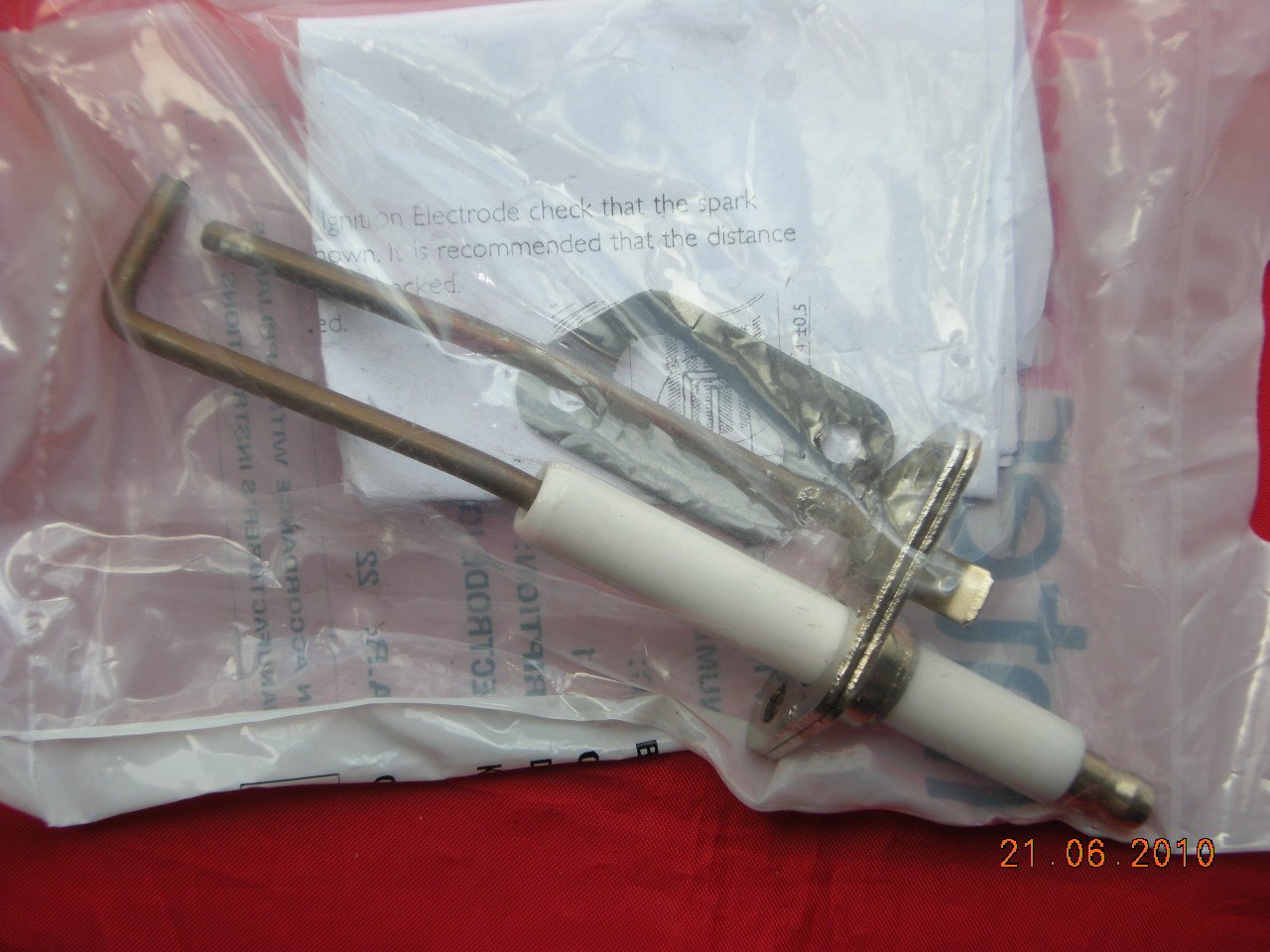

We have a Baxi Duo Tec Combi which was installed in the house when we bought it almost 5 years ago now.
Its been faultless all of that time, until early December 2013, when it began losing pressure and cutting out.
Luckily we have boiler cover with Domestic & General, so I called them they came out, and it turned out the pressure expansion vessel was knackered (technical term)... it was replaced, and all was fine again.
Then, few weeks ago, the boiler hadn't come on one morning, and there was an E133 error - looked on the control panel cover which said it was a 'gas supply fault' and could possibly be corrected by resetting the boiler.
Did that, and it fired up. The problem has gradually been occurring more often, but always firing up with a reset, until tonight - it just wont fire up.
Have just rang D&G/Baxi, and have an engineer coming out on Wednesday this week to try and sort it, so not looking for ways to fix it, as I realise its a gas issue.
Is it potentially a big job, and something that may re-occur? Two faults in the last month or so, just hoping this isn't going to become a regular thing, and the boiler is heading on its way out.

Could be a couple of different things but the most common E133 faults are preventable if the boiler is serviced regularly (and properly). When was yours last done?

I had a similer problem with my duotec 28he about 2 years ago. error code 133 and failing to light.
the Boiler service guy said it was the igniting electodes had moved out of place and just needed to be straitened out, which he did as part of my service. :)

Engineer called today, and fixed the boiler - it was the ignition electrode, which he replaced with a newer version, like the one here..
Said the newer part was made of stronger metal with less likelihood of the gap changing, and also with the return bar going over the top, if it did move, it still had more chance of maintain a contact for the spark.

Most boiler engineers know an on the spot fix for electrodes. But changing for new is always better if they are on hand.
The tips should be nice and square to the end, just like a car spark plug.
