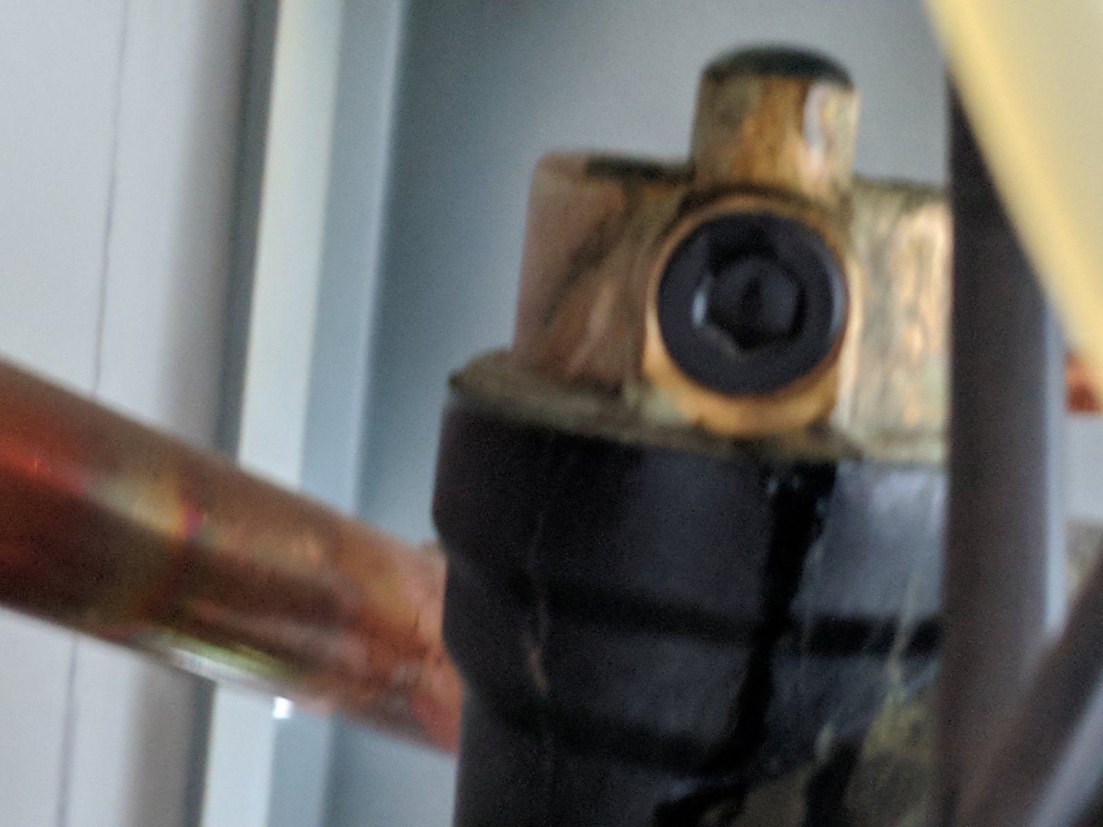

The automatic air vent attached to the pump housing is leaking. Now there's supposed to be a bleed nipple screw in the top but there isn't (no idea where it's gone). So I bought a new AAV and just used the screw from the new one and it stopped leaking
However it occurred to me that perhaps I should replace the whole part as the AAV is obviously letting water through when it shouldn't (albeit a very small amount).
Just wanted some advice on diy-ing this job. I was thinking of closing the flow and return isolation valves. There is a magnetic filter on the return so would close the isolation valve there for the return side. Then release water from the magnetic filter to empty the boiler. Then replace the AAV, open the valves and fill her up to pressure
Was wondering if this is the right way to do it? Presumably the Loss of inhibitor would be negligible? Or should I drain the whole system?
Also can I just unscrew the AAV with a wrench?
Believe it or not I have done. But just wanted your opinions because there's nothing better than real world experience i.e. is it ok to isolate the boiler in the way I described. Also do you use a wrench to take off the aav.

Yes just drain the boiler, if it's a threaded tapered connection you'll need some PTFE tape on it before you screw it on again. If it's a union then not necessary

really you sure so you don't use the oring then , I've never put ptfe tape on it and i see these boilers everyday ;)

Isolator valves on some filters and a lot of boilers are prone to leaking when closed/opened.
You've landed lucky if they're not leaking after doing a repair.
Ok so I read the manual.
Drain using the isolator valves and drain off point near the pump.
Use aav removal tool to remove aav. Replace O-ring if necessary
HMm but not sure I want to use drain off point from boiler in case it doesn't seal fully afterwards. So I might stick to my original plan and drain from magnetic filter

sorry thats b@llocks

;) , use the iso valves and drain off (y) , I'm on the right side of the bed now :ROFLMAO:, at least you read the manual . don't worry you can thank me later :p

Hi AGAS. Don't apologise, your entitled to your opinion.
I based my statement on my experience. Maybe they're more reliable these days as I never shut them anymore to save the hassle. I had to change a return isolator on a potterton promax that was weeping
from the ball last week which would be the same as the ones in the thread title I would imagine and yesterday I had a vokera unica that started leaking from one of the ch isolators after I had changed an AAV. I never even touched it and it started leaking. That's just in the last few days!
Maybe all the systems you work on have shiny new boilers with crystal clear water running through them ;)but around my way that ain't the case.
