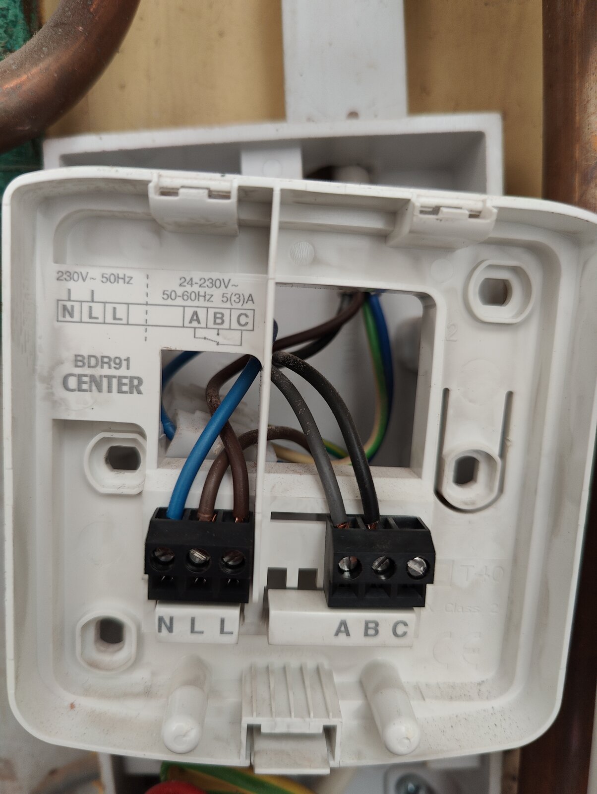

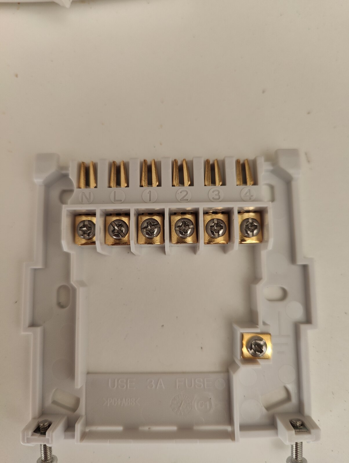

Hi all,
Hope you can help,

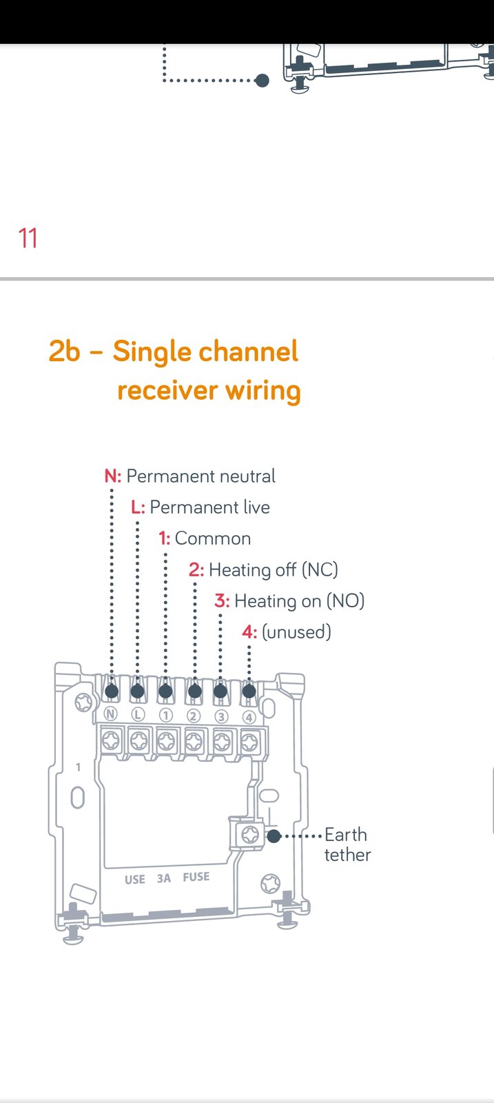

Trying to change an old BDR91 to a Hive Mini system on a Logic Combi 35 Boiler. The wiring diagram doesn't seem to help. Currently the N and first L are going to a fused switch below the boiler. The Second L, A (Gray) and B (Black) are going up to the boiler.
I assume N and L1 go in N and L on the next, but can't work out the rest. Is L2 for slot 1, A for 3 and B for 4?
Thanks in advance for any help!
Tom

'N' on BDR91 to the 'N' terminal on the Hive Mini backplate
Both 'L' s on the BDR91, to the one 'L' terminal on Hve.
Grey 'A' wire on BDR91, to the '1 - Common' terminal on Hive.
Black 'B' wire on BDR91, to the '3 - Heating On' terminal on Hive.
Thank you so much, I really struggled with the two live thing, couldn't find any other posts with that, sorry if it's a repeat!
I really appreciate your help, its working perfectly!
Have a lovely weekend friend :)
