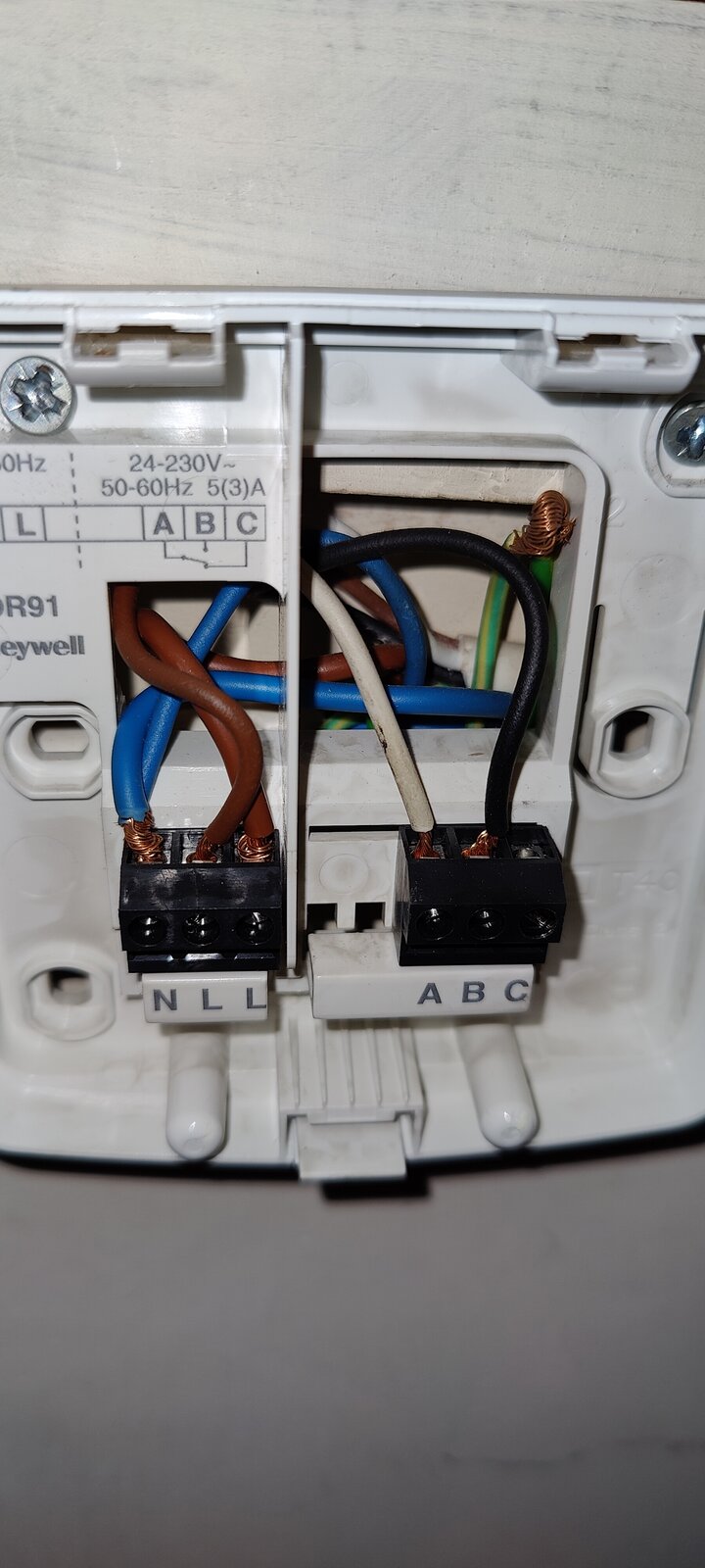

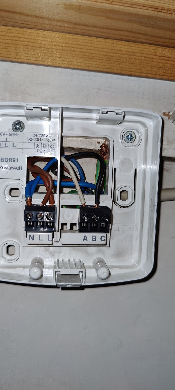

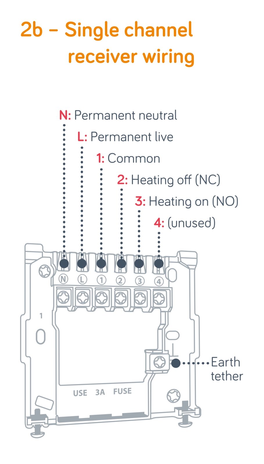

I am looking to change my Honeywell BDR91 and CM921 to an Hive Receiver and Thermostat.
Correct me if I am wrong but as I understand.
N to N
L to L
A to Common
B to 3
And My earth wire to earth tether.
What about the second L from the hive?
Would appreciate the help.
You also have x2 N’s, so will be powering something else, like the boiler. Might want to not have as much copper exposed either. Sleeving brown if A and B are 230vac would be good practice too.
one of the Ns are from the fused switch and other from the boiler and is connecting at the Receiver
So would just put the 2 in the same N port.
Yeah, I did think there was too much copper exposed so was planning to sleeve it.
Thanks for your help guys.
