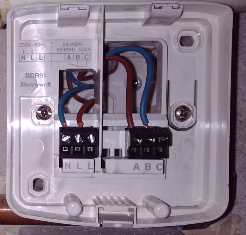

Hi all!
Our old thermostat controller isn't working anymore, so we are looking to do a DIY upgrade from the old Honeywell BDR91 to Hive. We would appreciate some advice from the experts on this forum!
We have a "Vaillant EcoTech Pro 28" combi boiler, and I have attached the current BDR91 wiring.
Based on other posts in this forum, I believe we will need to do the following for BRD91->Hive:
  • Left blue wire in N -> N
  • Left brown wire in L -> L
  • Right brown wire in A -> Hive Com,1
  • Right blue wire in B -> Hive heating,3
Does this sound correct? It seems simple, but we are confused about whether we should have some extra earth wiring for the Hive earth tether?
Hive unit we have in mind (I think it is correct?): https://www.amazon.co.uk/Hive-Heating-Thermostat-Professional-Installation/dp/B011B3J6KY/
Please let me know if you have any other questions/advice :)

That is correct. Use a pen to mark the wires before disconnecting, as the left and right set are NOT the same, mixing them up will very likely cause expensive damage.
Power must be disconnected completely before doing anything, usually at a switch adjacent to the boiler. Switching off at the boiler itself is not sufficient.
The earth terminal is for any earth wires that are there, which are probably joined behind the existing BDR91 plate. Or some useless type has cut them off.

If we take off the BDR91 plate and don't see any earthing cables, what do you recommend we do? Just, ignore it?
Thank you so much flameport, this is re-assuring, so I think we will try and give it a go soon!

The Hive doesnt require an earth, the tether is simply there to park any existing wire it does not connect to anything, you will see some posts with L&1 linked, do not do this with your set up, A&B to 1&3 either way roud it wont matter
