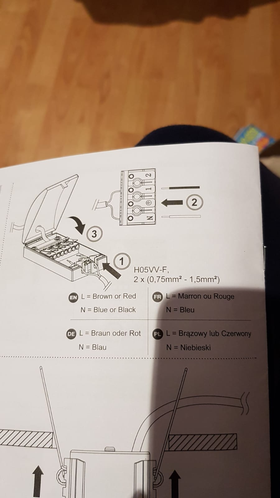

According to the manufacturer instructions for installing the down lights it says that you can use 0.75mm - 1.5mm cable for the lighting, I have already put the lights in (coming from a 4 terminal junction box) and connected them together via 0.75mm flex rated at 6A, and assuming that’s ok (please say so if it’s not) my question revolves around the first light in the sequence (the one coming from that junction box) can this cable also be 0.75mm flex? I’m asking because I read somewhere (can’t remember where) that all the cables coming from a JB should be of the same size and although I could fit 1.5mm T&E in the boxes that attach to the down lights I would have to cut away some of the plastic casing to make that happen.

The flex currently wired between the down lights is 2 core, I'll attach a picture of the installation booklet page and and the wire coming from the back of the mirror is 3 core.
As for the junction box it is in the lift and my loft is only a crawl space, so yes technically it's accessible, but it will be attached to one of the rafters

The only bit of wire that can be 2-wire is the (supplied) short bit from the downlight to its terminal box.
All the other cabling must be 3-core and the third core connected to earth, all the way through so you can test earth at the last light in the string. You'll need an earth there to do your final testing before energising the whole enchilada.
Did you not wonder what the earth terminal on the junction box might be for?
Well I did wonder... that might seem like a silly statement and I have no issue with being told something is incorrect, and your right I didn't specify how many wires the lighting flex had (my apologies) but going by the installation booklet it only shows 2 wires (a live and a neutral) despite there being an earth terminal in the terminal box it doesn't mention an earth wire in the picture nor in the description of the wire colours underneath it, it's not a major job to replace the cable with 3 core though, so I'll make that a first job tonight
