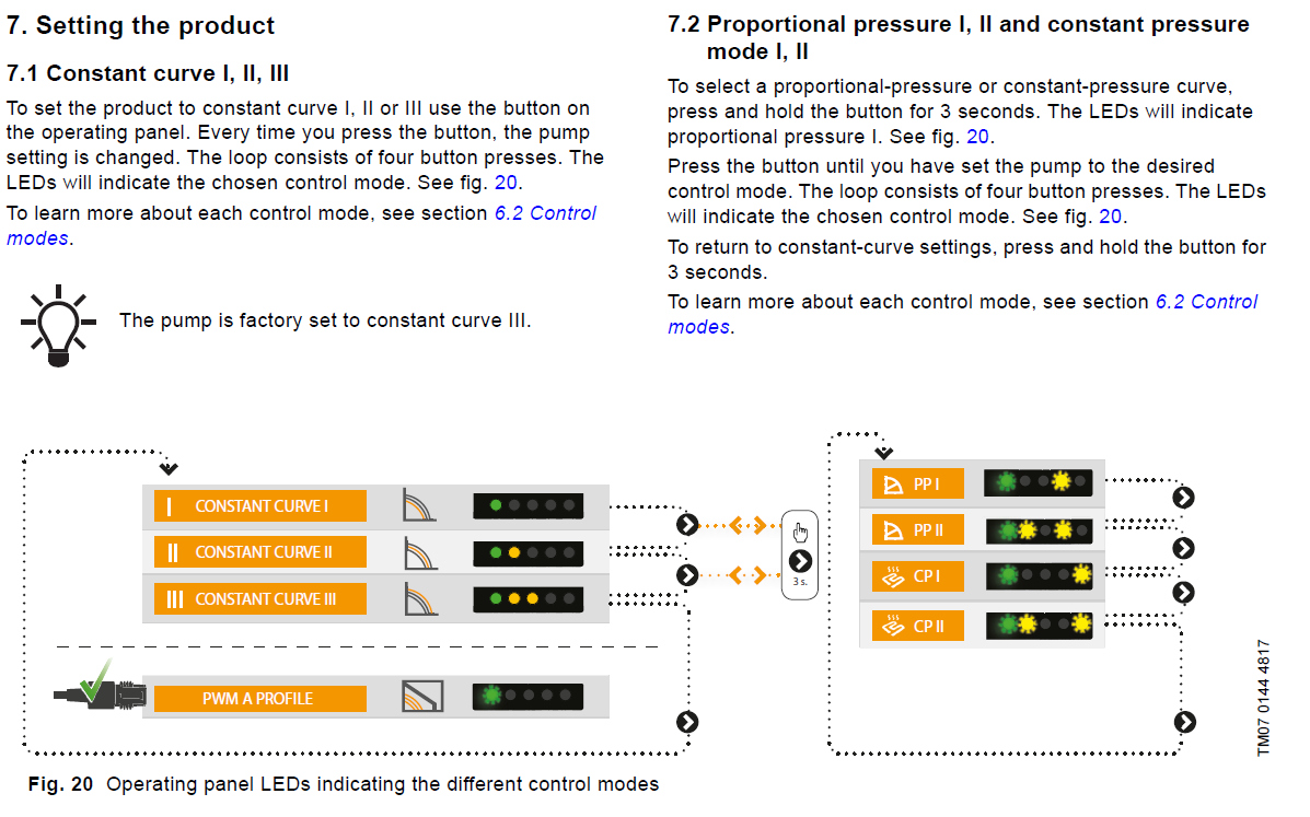

Everything is working almost perfectly. We did have the pump replaced, as prior to this, we experienced some random banging noises and hot water going up the vent pipe into the expansion tank and subsequently causing more air in the radiators. The only question I have is what is the best setting for the UPS3 pump. I am by no means familiar with the terminology mentioned in the Grundfos documentation.
There are "constant curve" settings (1,2 and 3).
There are "proportional pressure" settings (low and high)
There are "constant pressure" settings (low and high)
Currently the pump is on "constant curve" 2 - this was the setting chosen by the installer a few weeks ago. We occasionally still get slight expansion of water through the vent pipe in the loft into the expansion tank, but nowhere near like it was with the old pump - so far once per day, but not much water. I'm reluctant to try different speed settings without an understanding or appreciation if they will improve things or not. The pump is quiet and all radiators get warm.

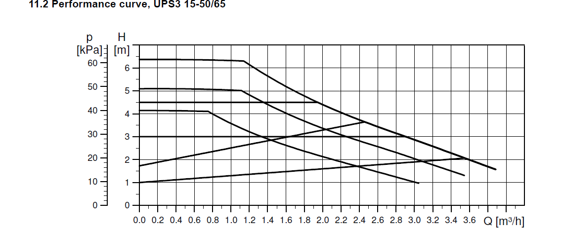

You shouldn't get any expansion into the F&E cistern, its certainly not inevitable.
The UPS3 is one of the most powerful 6M circ pumps you can get, CC2 at 5.2M should not be required for a 6 rad system, even CC1 at 4.2M is probably not required.
Suggest changing to CC1, (4.2M), if rads all still getting hot then suggest changing to CP1 which at a constant 3M should still be quite adequate, if everything still OK then give PP2 a go and see how you get on, leave the towel rad valves as is to act as a bypass. You may be OK on PP2 but unfortunately Grundfoss rarely seem to get these PP settings right, they are normally too low, a pity.

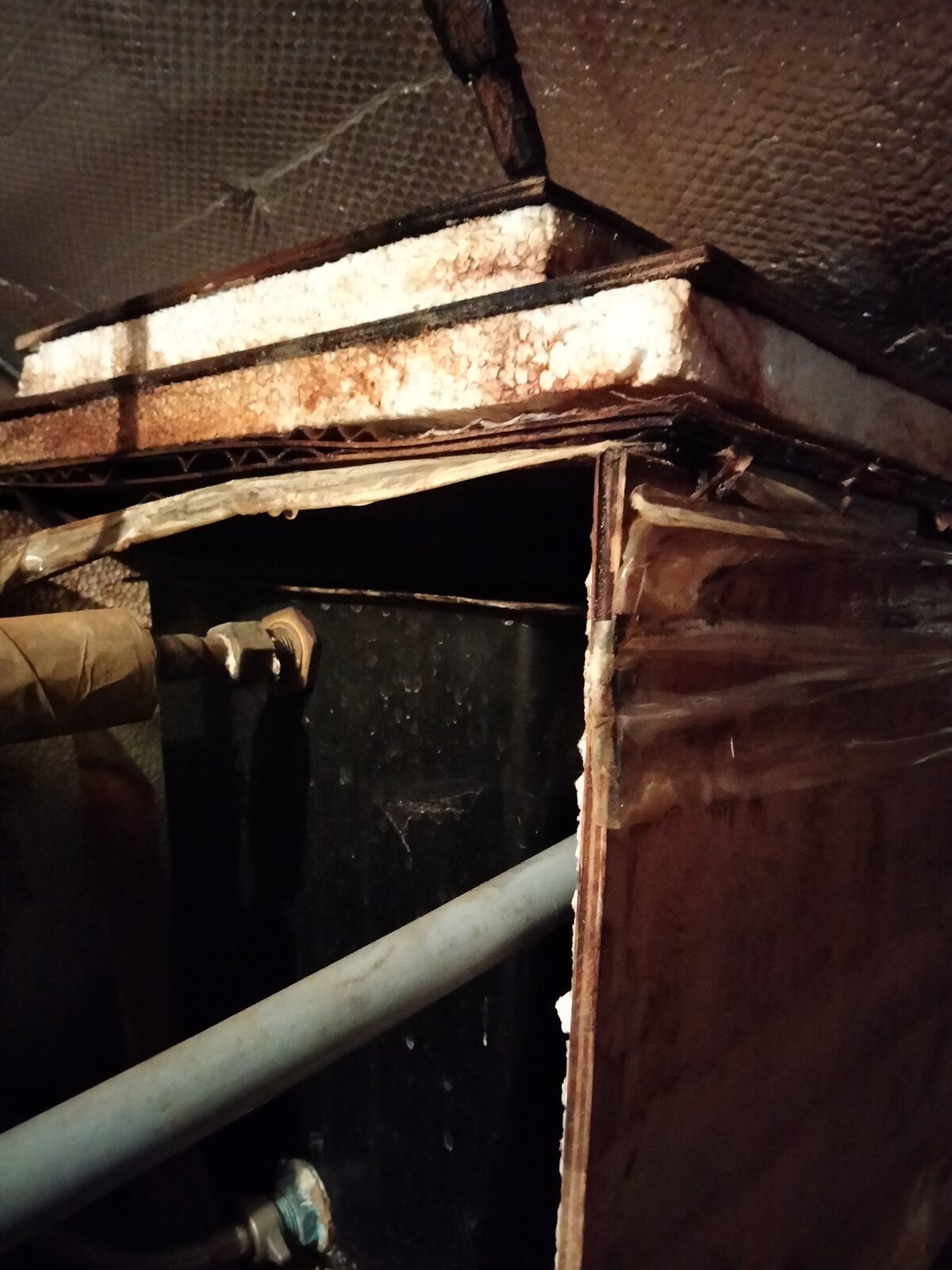

Pic 1 - this is how I choose CH, HW or both. This panel lets me set timers etc for each. Don't know where the 3 port valve would be.
Pic 2 - upstairs in loft showing part of expansion tank - the wooden surrounds been there for years
Pic 3 - bottom part of expansion tank

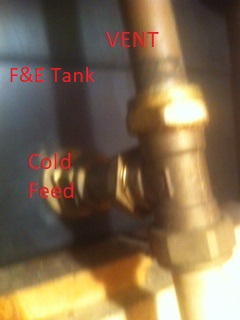

Pic 4 - vent pipe coming out of cold tank into expansion tank

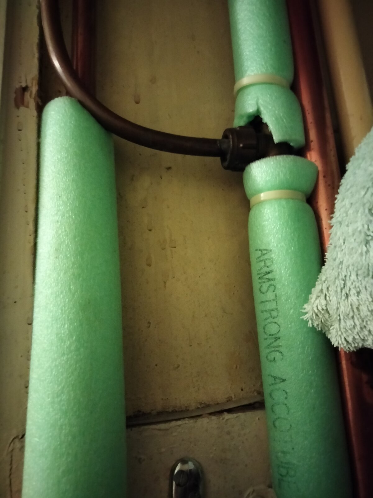

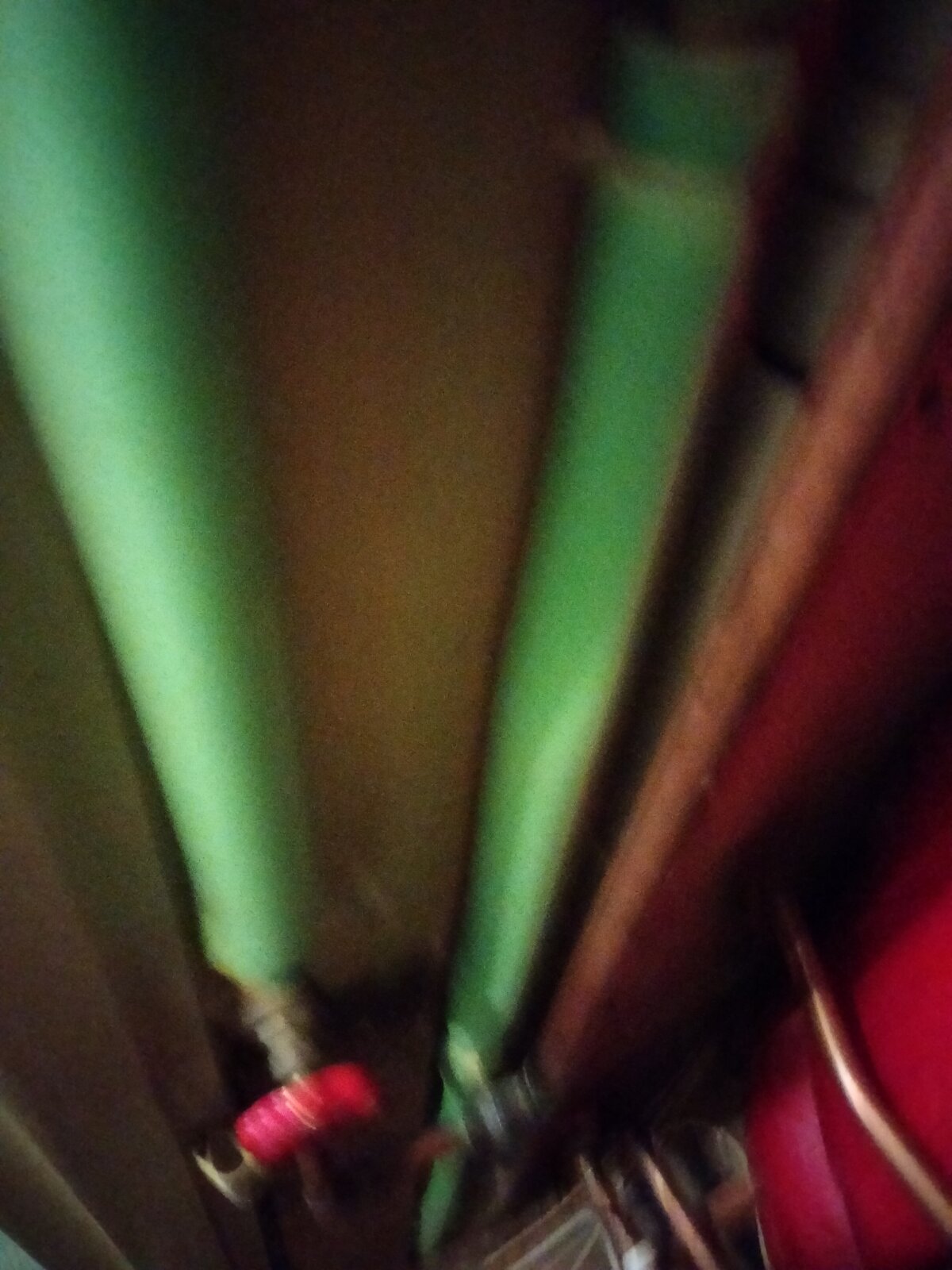

Pic 5 - cold feed coming from loft into airing cupboard. Cold tank is very close to expansion tank - maybe 6-8 inches apart from each other

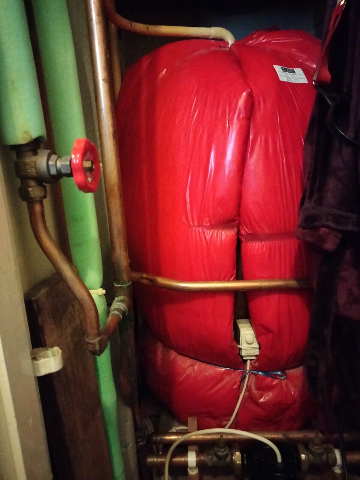

Pic 6 - hot water cylinder in airing cupboard
Pic 7 - Grundfos pump just in front of hot water cylinder

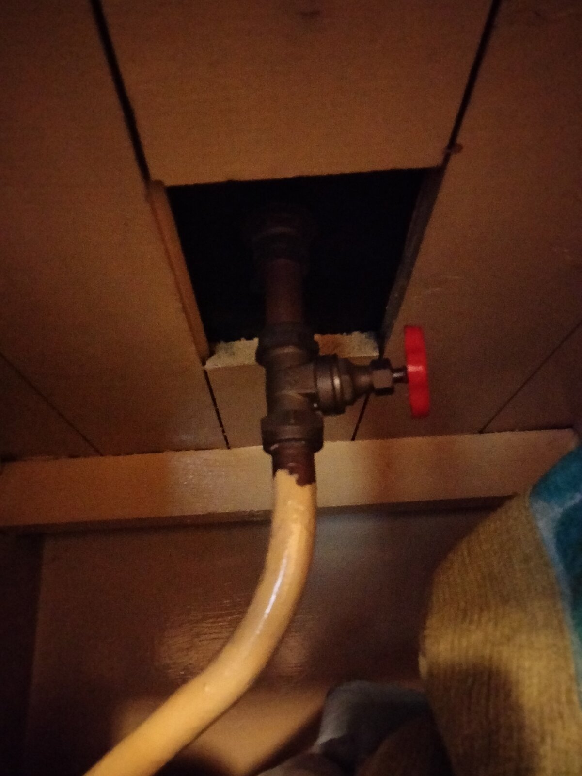

Not clear to me as yet, can you see or show where the pipe (called the cold feed) coming from the bottom of the F&E cistern joins the system, this is the pipe shown in pic.3, where does it tee into the system?, its also a ss flexible??.
The ss flexible pipe seems to go underneath the cold storage tank and then is out of sight. My best guess based on where it disappears is that it is connected to one of these pipes coming down from the loft directly below the cold storage tank. The 3 pics go from the top of the airing cupboard to the bottom.
The red wheel at the bottom is almost fully open. IIRC that has something to do with the hot water for upstairs tap in bathroom sink - but not sure. We have an electric mira shower.
I don't really mess with these things as everything's been working fine. We have the boiler serviced each year through a company called North West Heating Ltd. This system has been like this for at least 15 years (possibly longer). The Icos boiler was installed end of 2007.

CP1 at 3.0M is obviously cheaper (by a few watts) to run than CC1 at 4.2M, so long as it satisfies your heating requirements, the problem now is that the ABV was (if properly set up) set to open at ~ 4.1M whereas it will never open now at a constant head of 3.0M, it can be set to be constantly open a little but CP settings should really not be used with a ABV.
