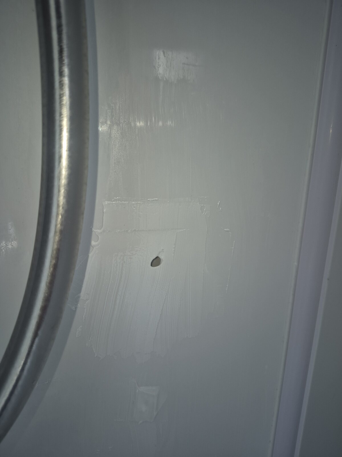

Anyone recommend a link to a product for a small hole in bathroom wall pvc plastic panel, size of a one pence coin.
Went toolstation and spent a good 30 mins in there speaking to customer service and they couldn't find anything suitable they sold. Needed something waterproof and mold resistant
Put a none slip bath sticker over the hole.
I bought this product and used it. Tried 3 or 4 times and it just seemed to fall through the hole. This is a picture of it after 3 or 4 coverings of it. It's the same size as it was to start with. So what do I do?
Maybe I should just and fill up hole with Stixall up, and smooth off with a filling knife. Hopefully it's just a little pocket behind the hole that will fill up quickly and not a totally empty space? What do you think.?
Try a white screw cover for furniture or such like with some clear/white silicone to hold it in place.
Pump it full with silicon then smooth off when full..
It was probably stuck on anyway..there may be some voids yes, but, not completely...worth a try!
