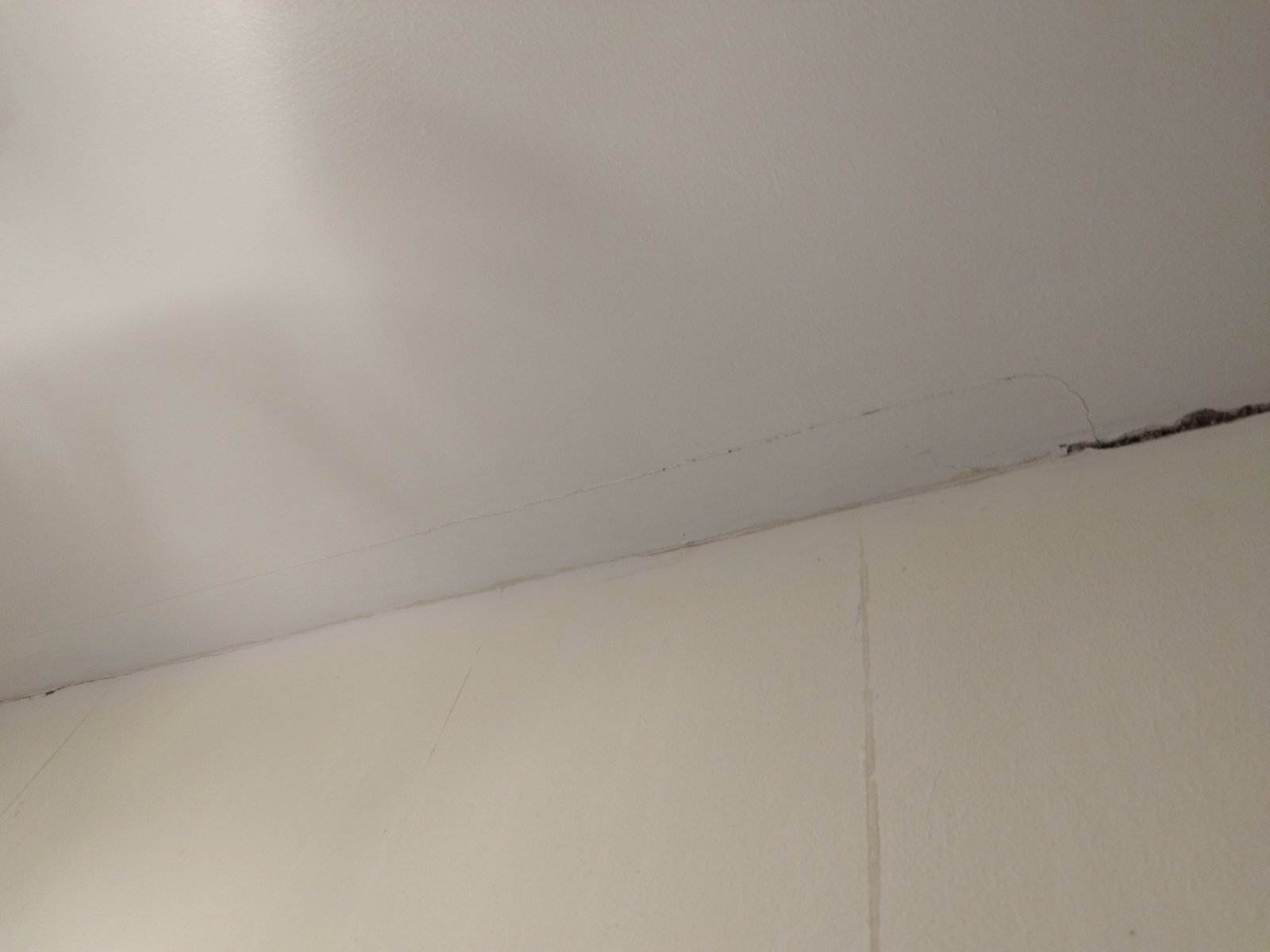

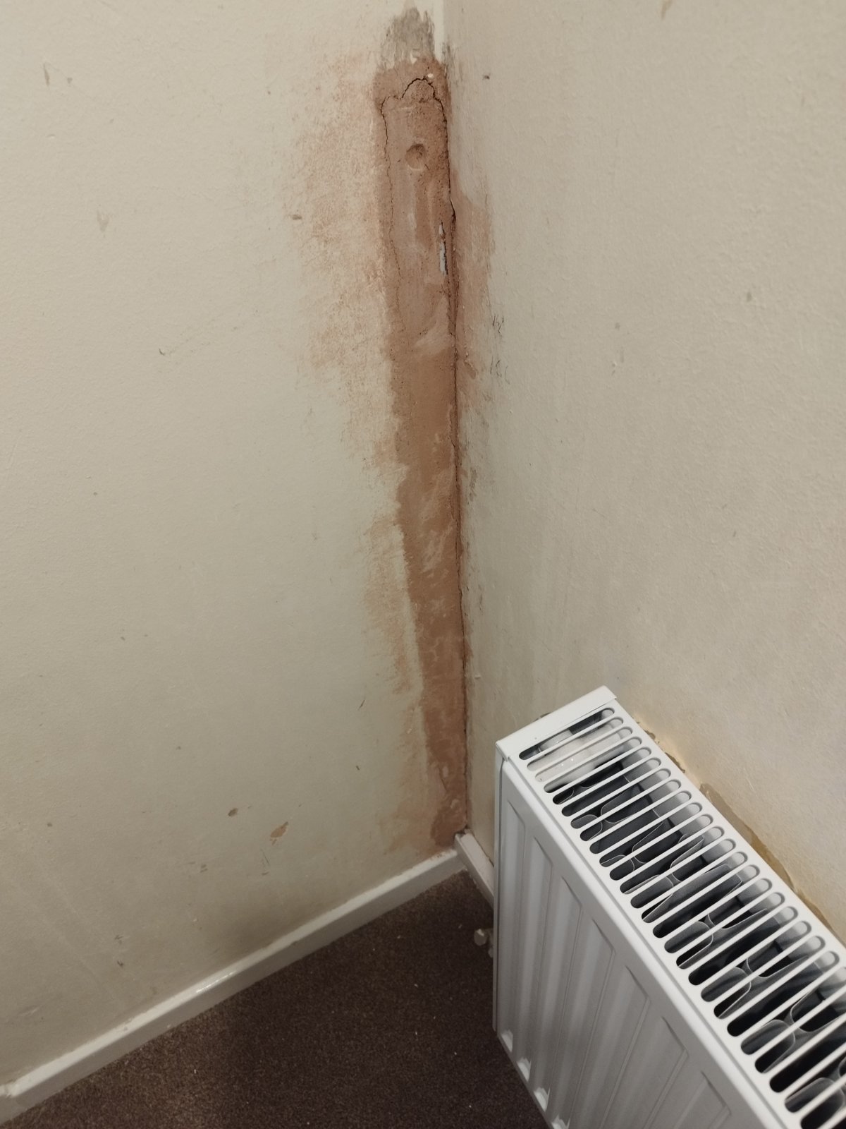

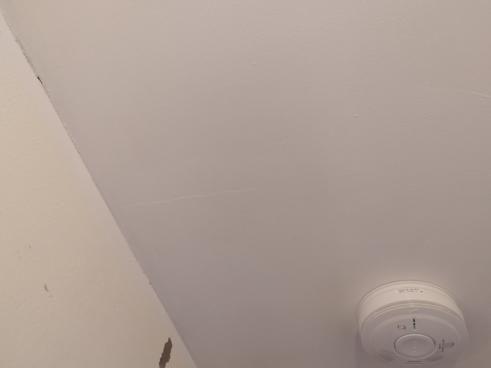

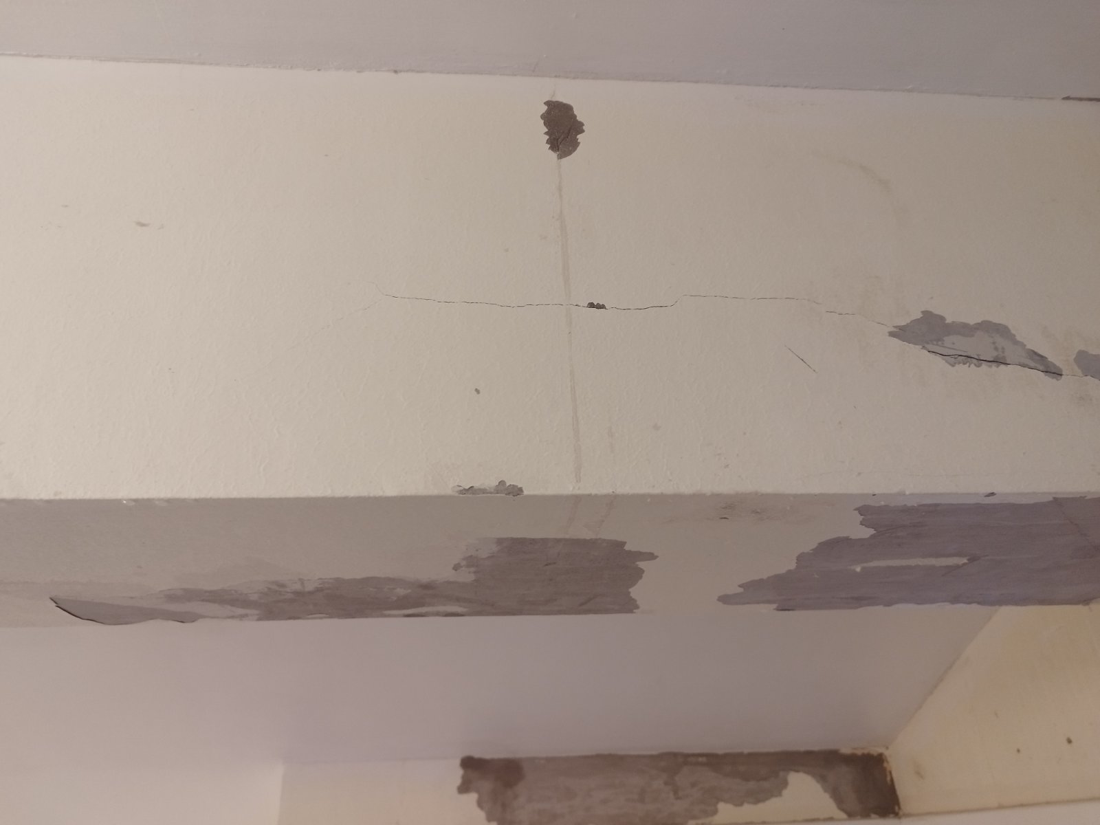

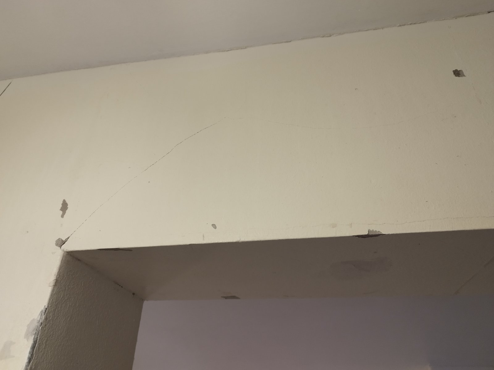

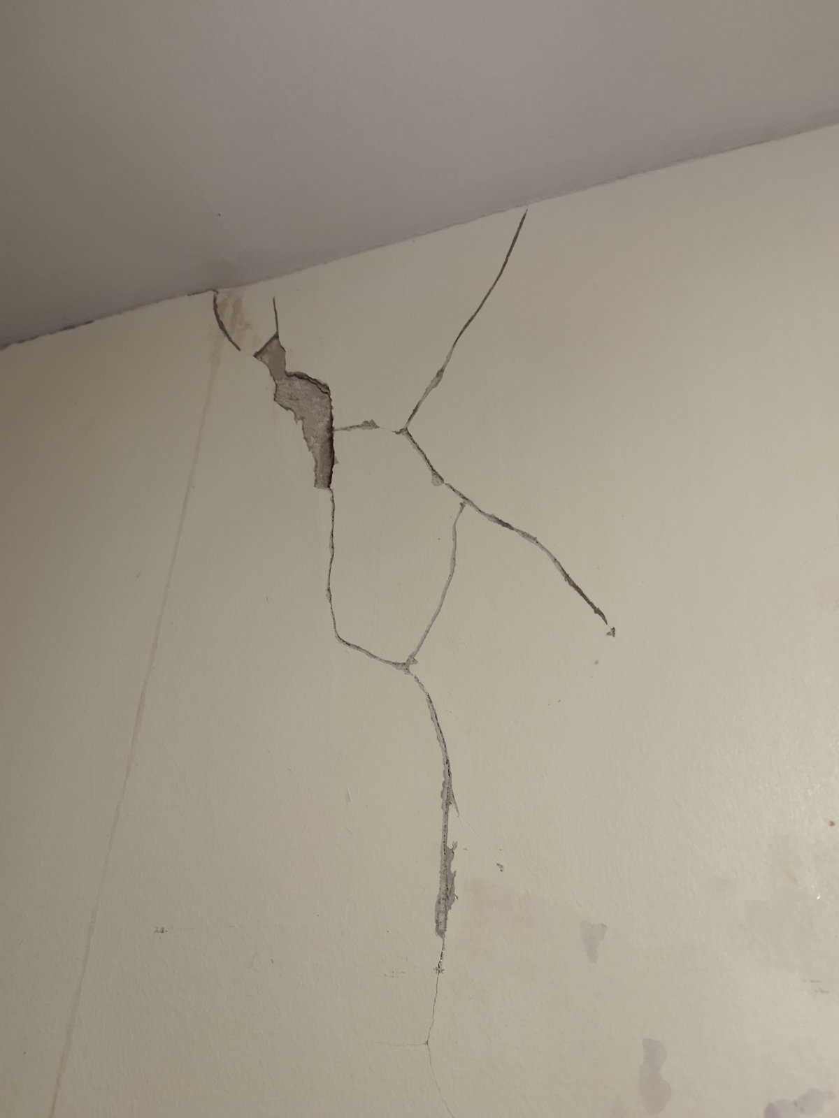

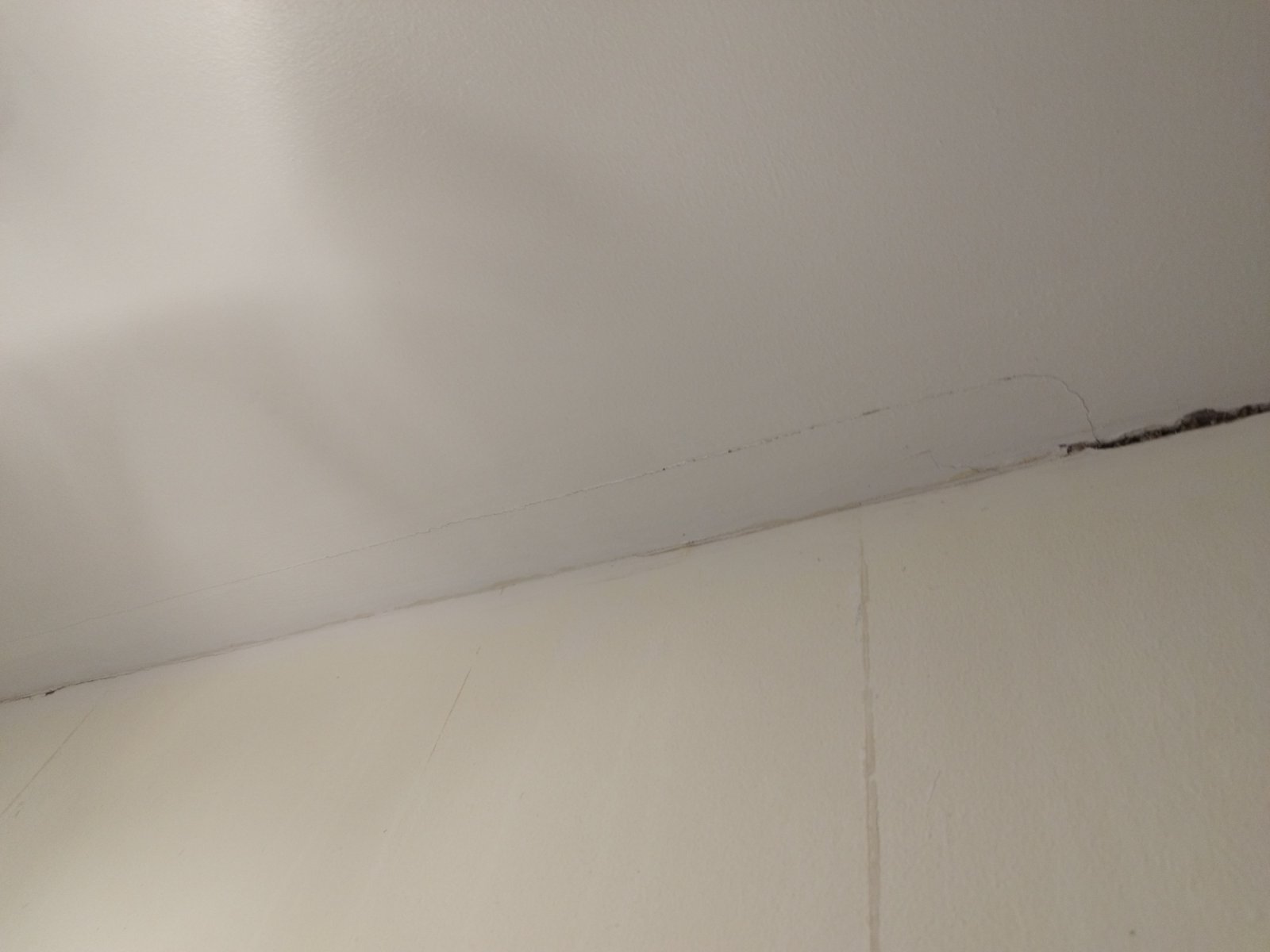

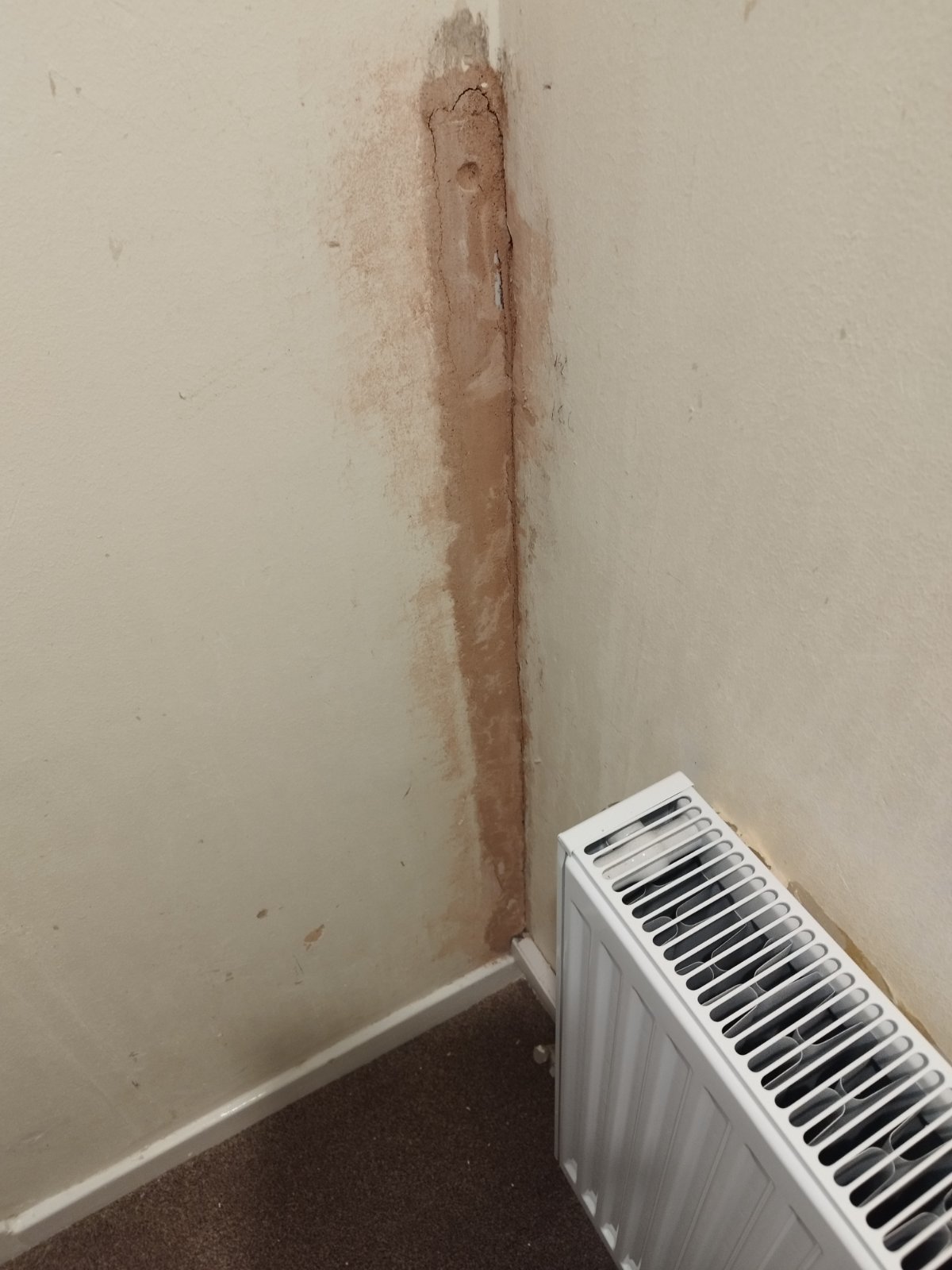

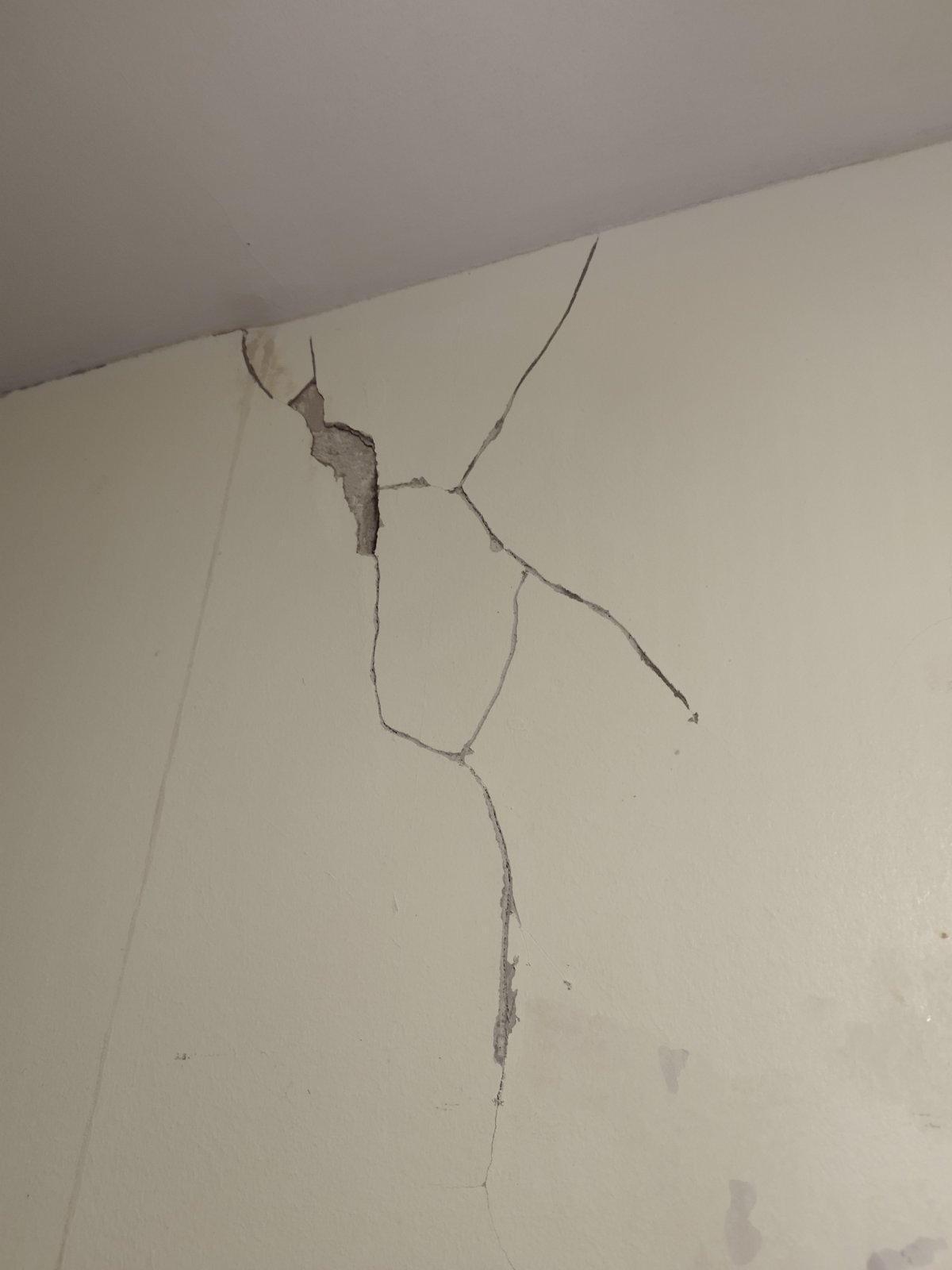

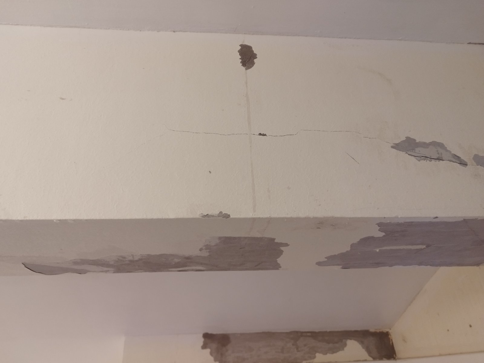

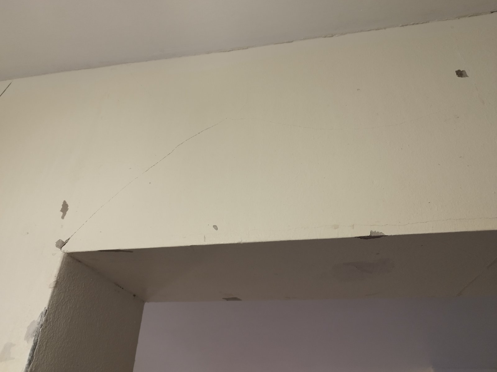

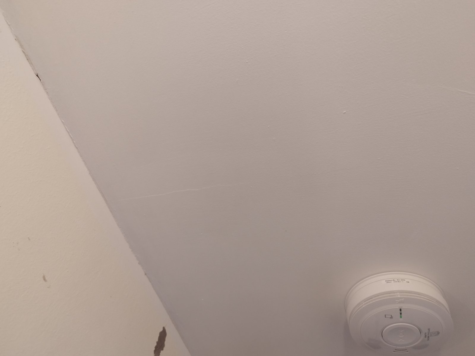

Removed lining paper on halls stairs and landing because of mould issues. Hopefully the problem has been corrected
Found loads of cracks & a few bits of blown plaster too. What's the best way going forward?
Repair cracks & blown plaster
Complete or partial re-board(if possible) & reskim?
Lining paper again because the wife wants it painted anyway.

Rake out cracks nice and deep.
PVA 4-1 seal joints.
Fill with toupret powder.
Sand.
Seal with Gardz.
Wallrock fiber liner.
Dry washing with a dehumidifier in the room.
Run a dehumidifier in the evening for a few hours. We run two.. one up as and one down.
See how that works out regarding mould control
Sand.
Seal with Gardz.
PVA do you mean 4 parts PVA 1 part water or other way round?
Good idea with that type of liner paper, not heard about it before.
I've never lined a ceiling before, how easy/difficult is it?
Dehumidifier had been run in room with washing, i am surprised how quickly it gets dry. Might have to invest in a smaller one for that though. No sign of mould back yet, so fingers crossed.
Wallrock is good. I did it in my living room with the premium paper, BUT it will still show bumps and lumps if your walls arnt smooth.
IF the walls are smooth with the odd crack, wallrock is perfect, you cant rip it.
