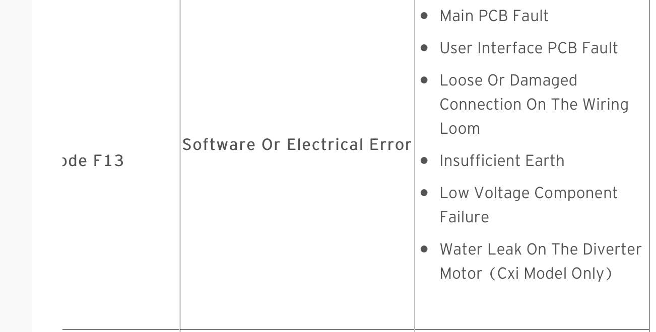

BG330 boiler code F13
1 Sep 2023
10
I have a BG 330 boiler that is showing F13. The main PCB has been replaced last month and the flue over heating switch was reset a couple of days ago. Now I have F13 showing. Any help or advice would be greatly appreciated especially as winter is in its way. Thanks again.
This is what it says from Glow Worm
