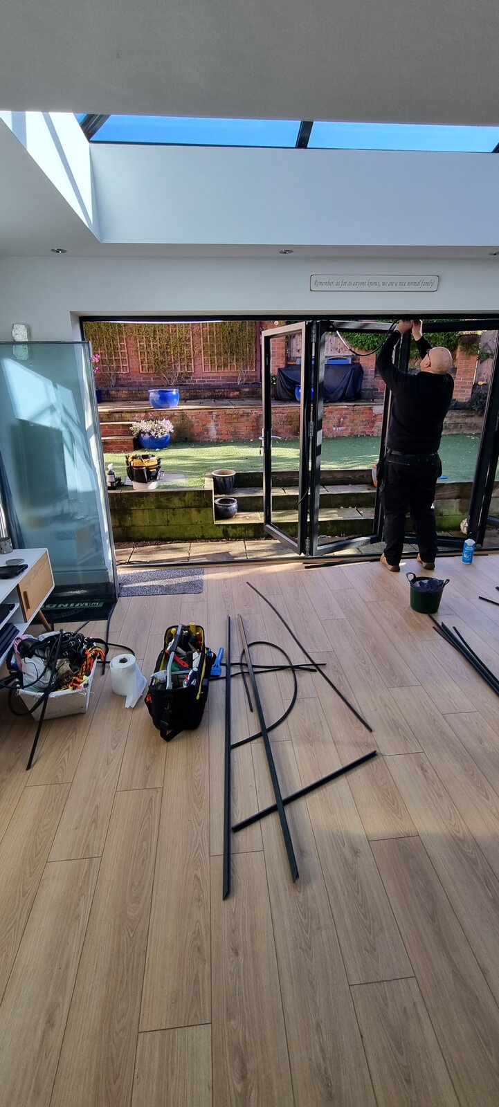

As a service engineer the problem I see is when you remove the traffic door from the left and move it to the right it would mean the handle is on the left of the door which is now on the right, you can't simply just flip the door around because you'll also reverse the rebate

This is a recent door repair I did, if you just move the door to the right then the handle will be on the left of the door, if you turn the door around so inside is now outside and outside is inside then the rebate will be wrong
So i literally need to buy a new bifold door just to make it go the other way. Seems very odd. So you have to buy 'left' or 'right' opening bifolds instead of universal and fit how u want.

Your not grasping what I'm saying, the door is rebated which means flipping it inside out will mean the rebate is on the wrong side. Your wardrobe doors likely don't have a rebate so can be swapped, internal doors don't have a rebate either

External bifold door sets are complex and they can’t swapped usually, the door handle, lock, rebate etc are all location specific
Interesting that you are having to repair what looks like a quite new installation, any tips as to what to avoid or to watch out for is it the make or the bad fitting
