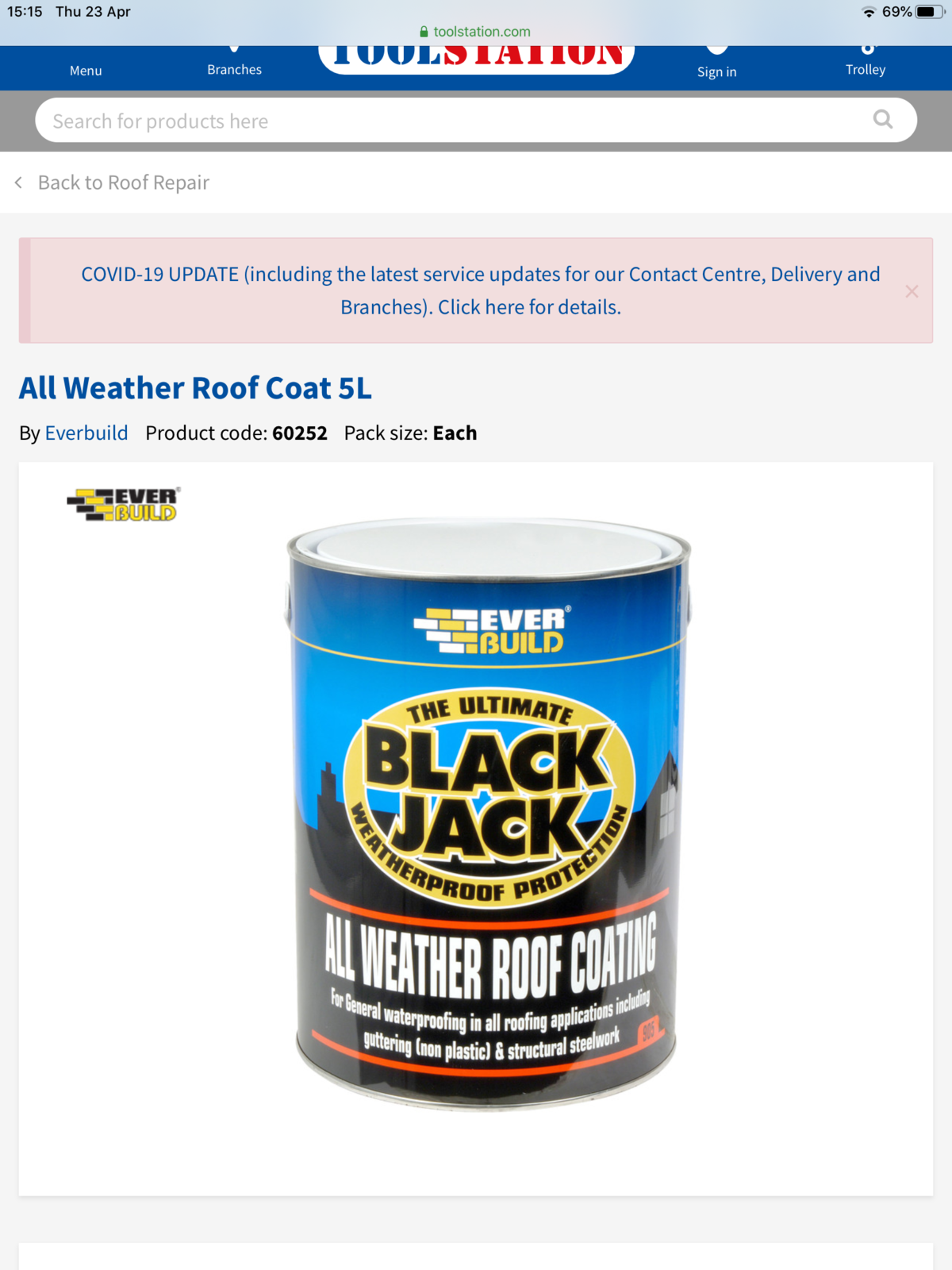

Do it yourself loads of bitumen based waterproofing for flat roofs. eBay about £25.00. Lots of colours for you to use.
So you reckon go for a bitumen topcoat as opposed to the fibreglass topcoat that the roofer has used around the skylight? Do you have an example of the kind of thing you mean?
Thanks for the help.
Just read some of the reviews on this product.

OP,
Maybe the Blackjack business will work - maybe not?
Thing is, if it doesn't work you will then have three different types of roofing materials on your roof - with a final smearing of Blackjack.
The roof needs (if you can get one) an experienced flat roofer to examine it - whoever built it did you no favors, there's a few things that instantly jump out esp the dimensions of the roof "skylight".
I cant see everything so I wont comment further - hopefully, all will be well.
If you have removed or intend to remove the ceiling below then do it, and then water test the roof with a hose - start low - & observe from below for leaks from where?

The previous business about the Blackjack wont fly. I'd suggest that you leave it alone.
