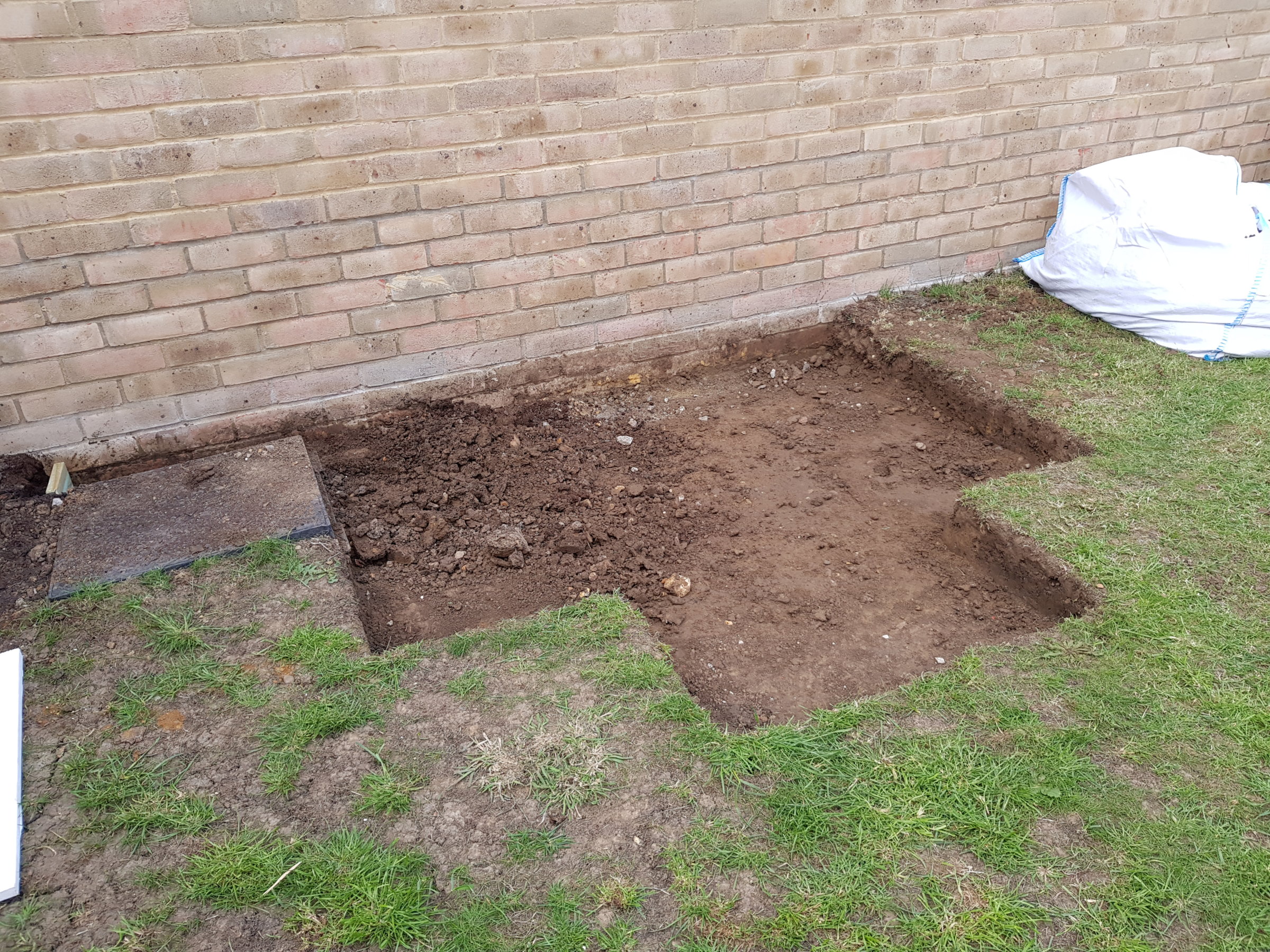

This is area I have dug out for the block paving, annoying the garden slopes and the manhole cover on the left is higher than the turf level. I am just going to make it slope a little to the right for the water run off.
You could use some concrete edging or a 3x1 slab on its edge to keep the blocks in.
