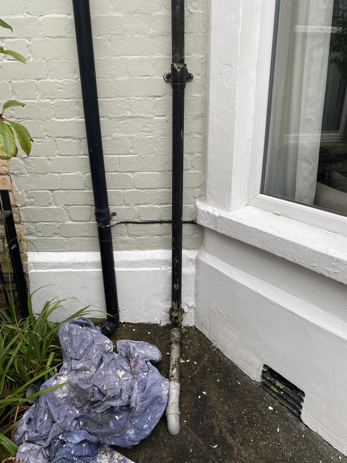

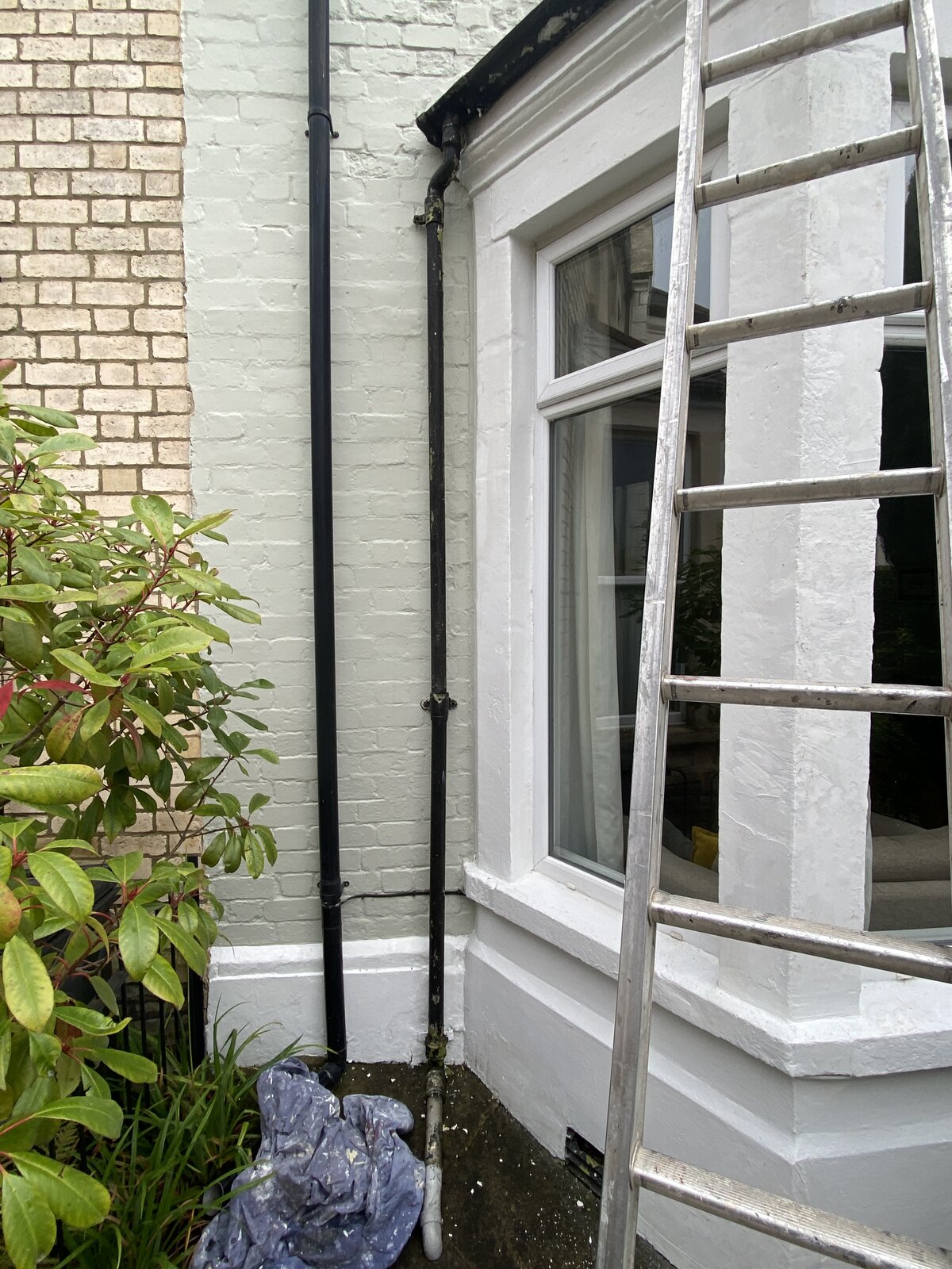

The short downspout from the lower bay roof is blocked. Evidence: water build-up and evident gunk at the opening of the pipe.

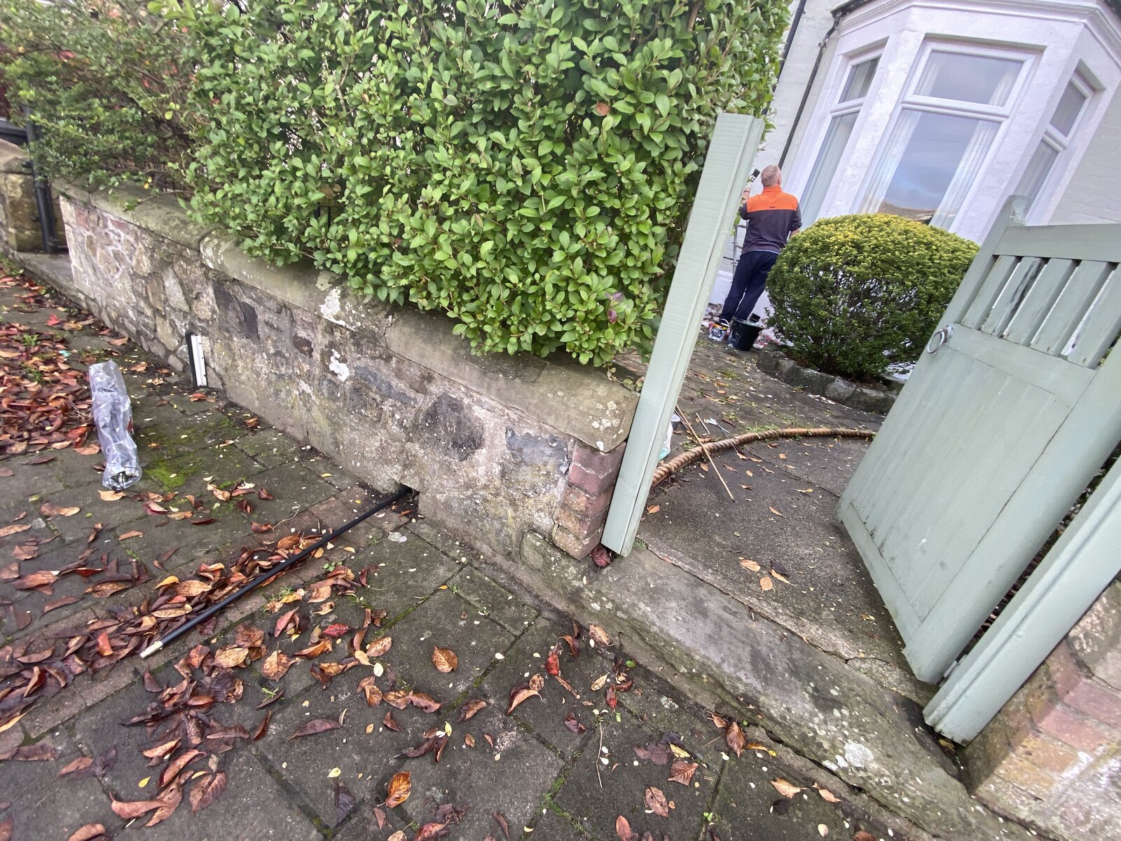

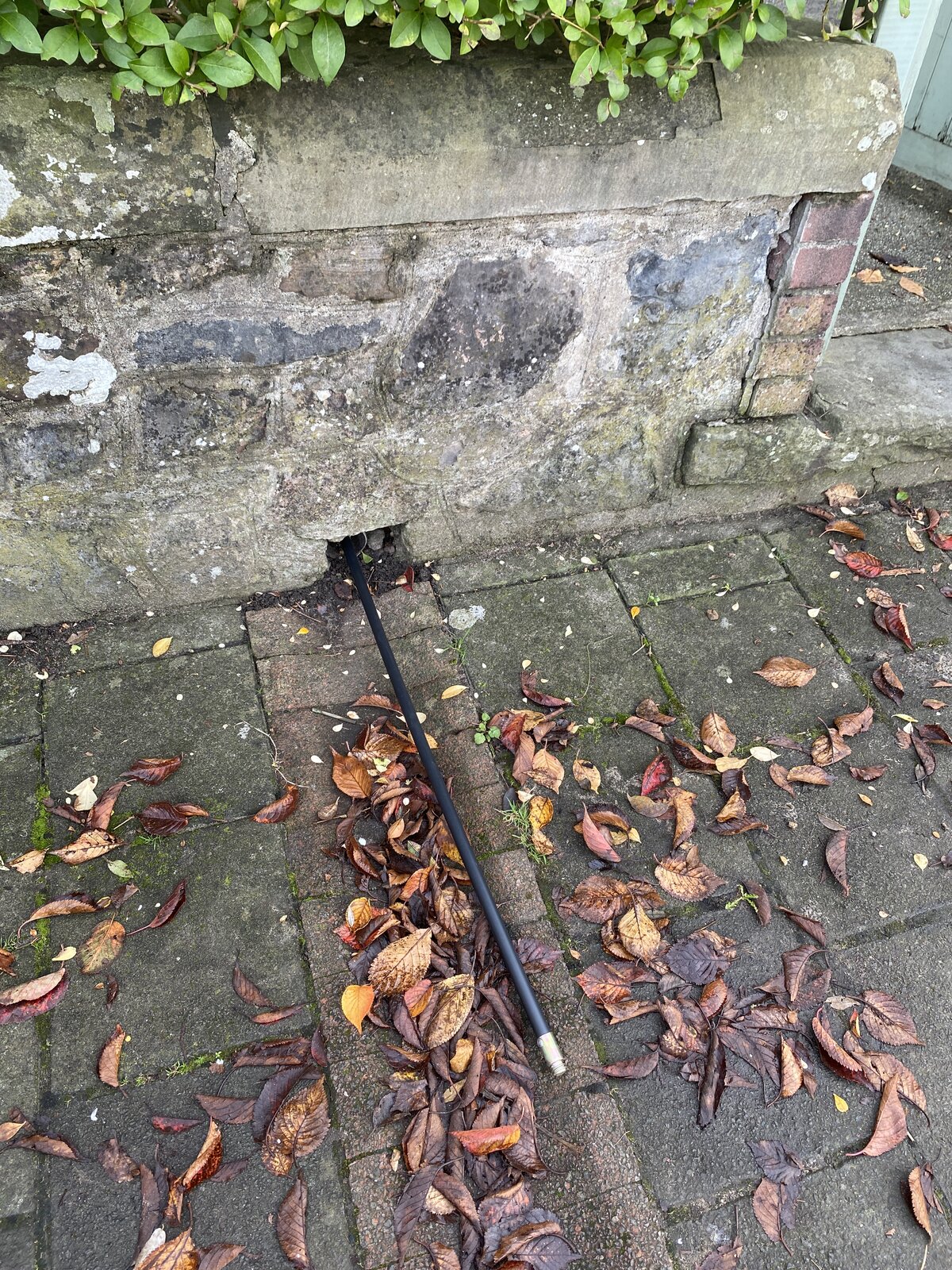

In this Victorian Terraced house, the pipe goes under the garden and exits onto the pavement. From out on the pavement, I have pushed five metres of drain rods in with no blockage, so the underground leg seems clear; it is just the vertical that seems blocked - or the intermediary bit at the bottom, which also turns.
The only thing is - due to the upper pipe dog-leg/kink, it's not possible to shove a straight poker down...
So what should I be thinking of using to unclog it? Will those flexi things with handles on the end (I believe they're called "augers") do the job, or are they mostly for internal pipes? https://www.amazon.co.uk/Amtech-S18...nsparent/dp/B01LYX9RRV/ref=asc_df_B01LYX9RRV/
I'm loathe to try loosening the dog-leg; we're talking very old ironwork here.
I'm also loathe to jet wash it, as the wall is newly painted... though this may happen with an auger, too.
Had some success previously with some flexible plumbing pipe (15mm) or the curtain track stuff.

Currently, the long downspout from the top roof exits all that roof water out on to the garden.
I'd love to get it off the property. The shorter, blocked downspout theoretically exits underground and out on the road, through a channel in the pavement.
The shorter downspout is a bit narrower.

RHS short pipe (from the small, single-storey bay roof) - pipe goes under the front pavers, out through the front wall, then there is a channel in the pavement, out to the street. Recent inspection made me aware it's blocked and leaking over onto the bay area, albeit marginally. The gutter is clear. I have shoved drain rods in from the pavement and they go all the way to the bottom of the downspout - or, rather, to where it kinks/doglegs into the ground... about six metres. In other words, the horizontal stretch is not blocked.
LHS long pipe (from the main roof) - pipe simply exits on to the pavers. I don't like this idea anymore - we do have damp issues in the bay.
House was refurbed in 2012, we took ownership in 2013. It is apparent from Google Maps Street View that, before that time, our neighbour on the left in the photo had a tall downspout (exit destination unclear) and our house did not, only one for the bay. Following the refurb, our side is the one with a tall downspout (exiting to pavers) and their side only has the short one for the bay. So, maybe my tall downspout is getting water from two rooves. The neighbour does have another neighbour on the other side who does have a downspout. I'm not sure if every house should have their own downspout, or if it's typically one-between-two.

If the RHS downpipe is plastic? chop the pipe above the dog leg and see if you can located the blockage, remove and seal back up again... not sure what diameter the pipework is, as it looks smaller than 'normal' downpipe.
You are not really allowed to just redirect the surface water wherever you want, but if you have damp, something will need doing at some point.
Soakaway would probably be the norm, but there are rules/regs for these, and minimum distances from buildings etc.
Perhaps it would be better for you to redirect water from LHS to meet under paving pipe, that way it will exit on the street gutter.
I would lift up the paving and replace the underpaving pipework with modern downpipe size, glued together and replace the RHS pipework to the gutter of the bay... also I would redirect LHS pipework to your 'new' pipework.
Its faff, but straight forward.
