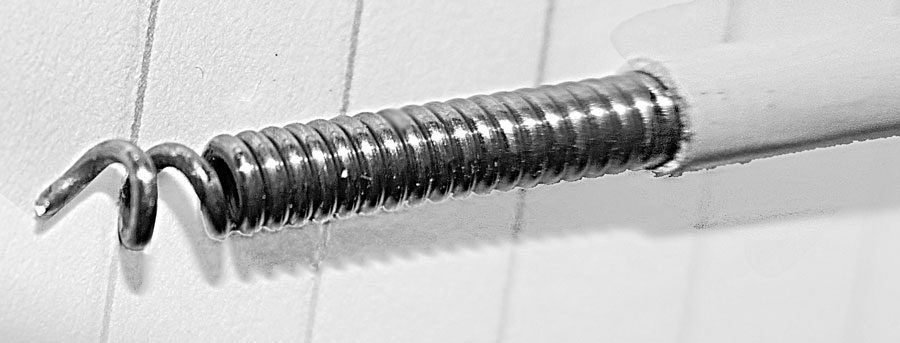

I have pushed curtain wire down the 2 tubes from the sunroof gutter. They stop dead after about 4 ft, level with where the front winker repeater lights are.
I've loosened the plastic wheelarch liner and felt up to the repeater, but can't feel the end of the tube.
Honda say it "should be there" It goes down the A pillar, they say, then to a one-way valve of some kind which is supposed to stop mud and insects getting to it.
I have tried throttle (bowden) cable, in a cordless drill, and also curtain wire with the end worked to be a corkscrew. Nothing gets attached to the metal.
I have been told people use air pressure, and also been warned against using it. If the rubber tube comes off, back at the sunroof gutter, water goes into the head lining - a disaster for the car!
Does anyone know what might be causing such an obstinate block??
The curtain wire:

I need something very bendy to shove into the end of the curtain wire, which will go round a bend. FIshin line or something. Interdental brush wire - but longer...

Bike brake cable is like the bowden cable, perhaps thinner. I can always remove a few strands and try that. A "formed" end would likely be very tight.

Yes it was the inner cable I tried. I found some bike cable which is thinner than accelerator cable, but that stops dead too, despite twisting, and kinking the very end.
Next is to melt a piece of skinny ty-rap into the curtain spring. The leading end is pokey but flexible.
The ty-rap came back with a little goo on it, but nothing much.

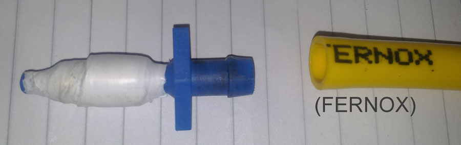

I used some bits with a foot pump, and a nozzle shoved into the gutter hole, and pumped to 20psi - and one side cleared. But the other wouldn't clear at 35psi. It's quite hard to hold a footpump, hand cranked against your arm with one hand, while shoving the nozzle into a hole. I didn't fancy going higher anyway.
I got most of the water out with the curtain wire (finger over the end etc to trap it). Then I got some sodium hydroxide liquid up the curtain wire, shoved that down (held it.. ...then took my finger off), so it's all at the bottom. Then I had some coffee...
It worked. 15 minutes late the gunk shot out at about 10psi. (NaOH rots organics).
Then lots of very hot water/Flash solution, & all flowing nicely.
Thanks all for the thoughts
Then footpump gripped the blue tube-grip - hence the black marks from its rubber..
A football/airbed pumping adapter would have worked, too.
