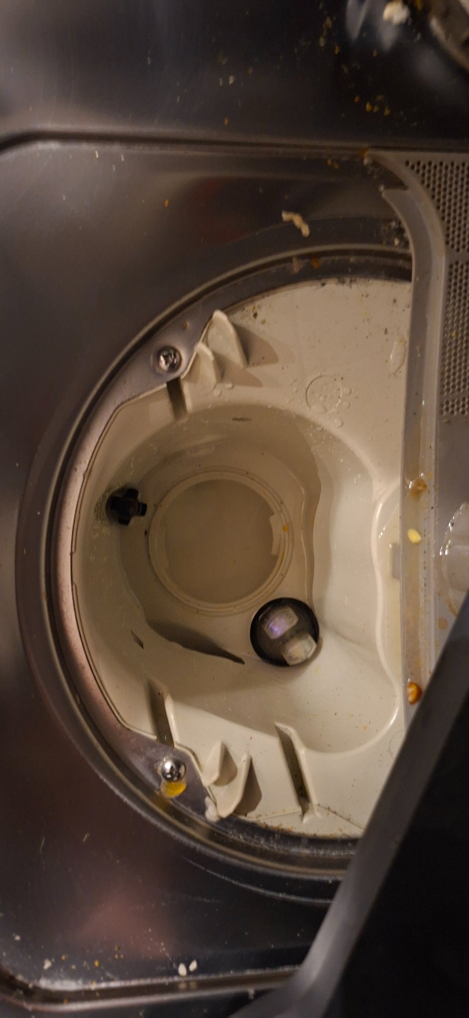

Hi guys. Long time lurker and love this forum. My 7 year old Blomberg LDV42244 dishwasher is making noises mid cycle like it's trying to start a process but then gives up after a few seconds. It happens repeatedly. See the video in the link below (you may have to turn the volume up pretty loud):
It does this loads of times, like it's trying to get going but can't quite get there. And then either it works or it moves on to a different process (not sure which). But 20 minutes later, during the same wash, it does the same thing again. The dishes come out clean and dry, and the water has drained fine. But this trying and failing noise had been happening for a month now and makes me think something is going wrong. I pulled off the water inlet and outlet pipes and both seemed fine, plus no kinks in the pipes. Haven't pulled the dishwasher out yet though. If anyone knows what's going on or can suggest some next steps for investigating I'd be very grateful. Love this forum.
Have you checked the pump impeller under filter is clear. Nothing wrapped around it
Thanks Wayners
I can't actually see the impeller motor under the filter basket. I guess it is tucked away through the hole at the bottom, and access on my dishwasher is from underneath?

Maybe.
Dishwashers are not easy to fix like washing machines and pumps are a common fault.
You might be able to remove pump and have a look.

So, eventually I took the underside off the dishwasher but couldn't see anything wrong and realised I needed a professional. So called a man in from Euronics/Keymex. He took off the front (it's a built in version) and then he took off a panel at the bottom of the front and found a hose filled with gunk (I assume leading from the filter inside). But it still wasn't heating up, and the process of starting and stopping continued. He decided it needs a new pump which is an all in 1 part. He's ordered it and will fit it next Tuesday. Total cost is about £175-£200 for parts and labour. He said otherwise the dishwasher looks fine. Fingers crossed
