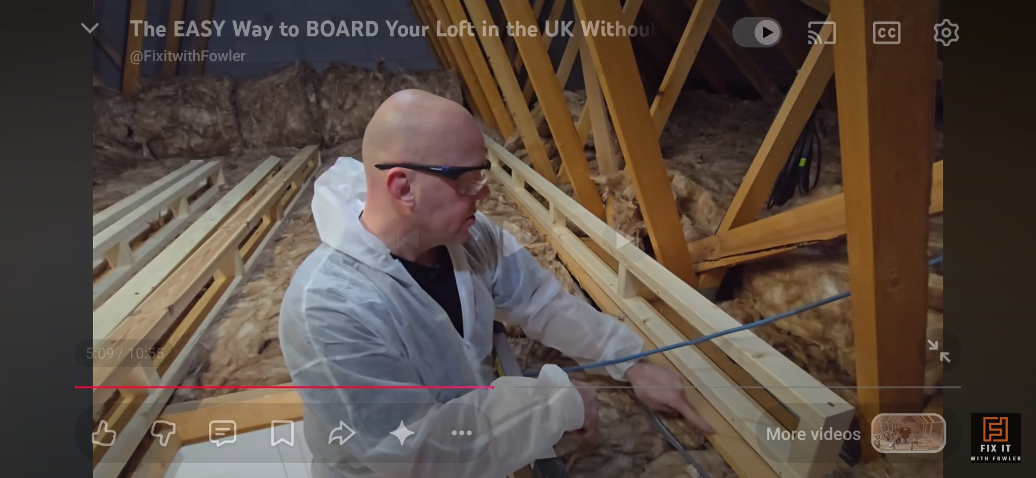

I've been on a mission emptying the loft of the previous owners/tenants stuff. Obviously didn't notice it until after the sale went through.
I want to build some supports i just don't know what size timber to use
I've attached a screenshot of what I mean
And a link to the video I watched
I would follow the line of existing joists and make sure the sit on the wall plates. Then stand C16 studs on end to the required height

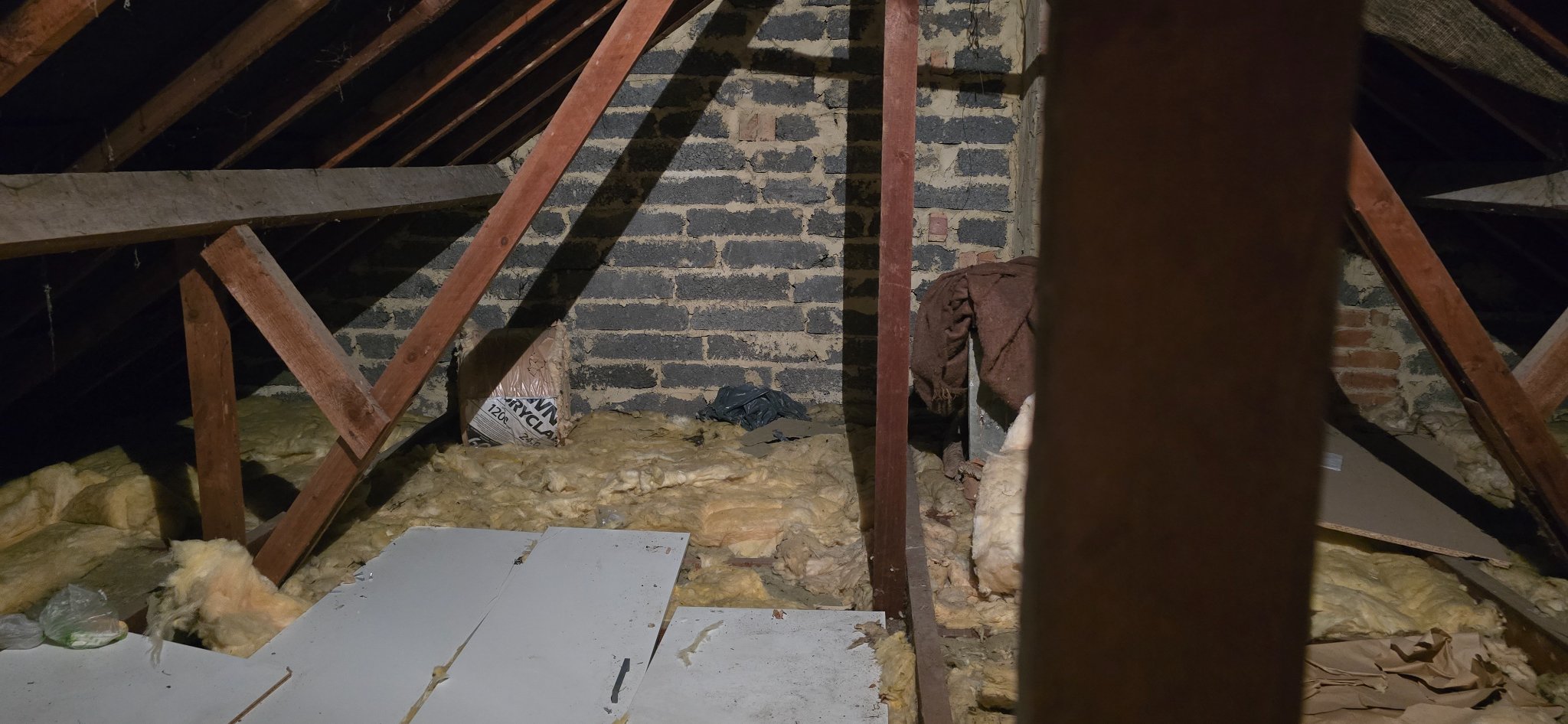

Some pics of your own loft would show us what you are dealing with.
Also, please measure the joist depth, width, and length between supporting walls.
I haven't been up there for a few days ill get some pics and measurements when I'm up there next

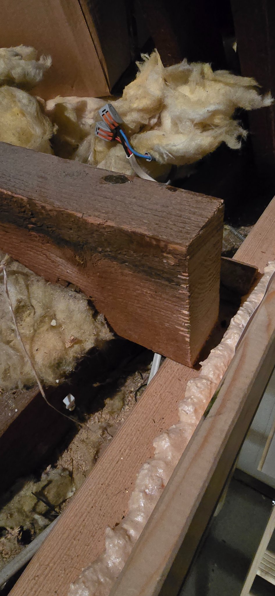

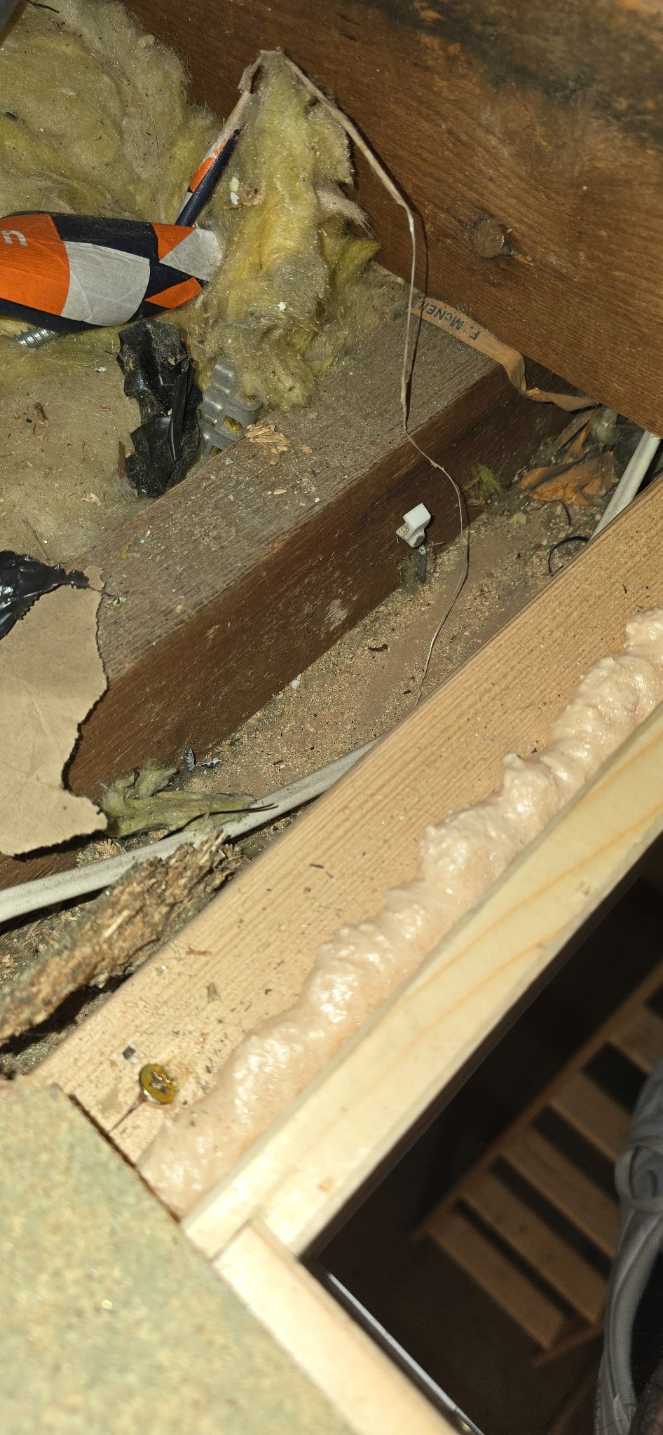

There is 3 seperate 4x2 that run the width of the house.
They sit on 3x1.5 (75mm x 38mm ) ceiling joists that are at around 400mm centres .
Your second pic looks like somebody has recently sawn the end off, and built something with expanding foam in a gap. What's that?
We had the loft hatch made bigger. And to have a pull down ladder
