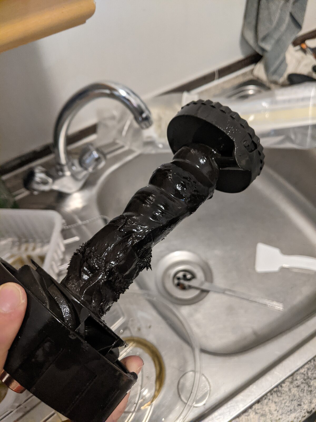

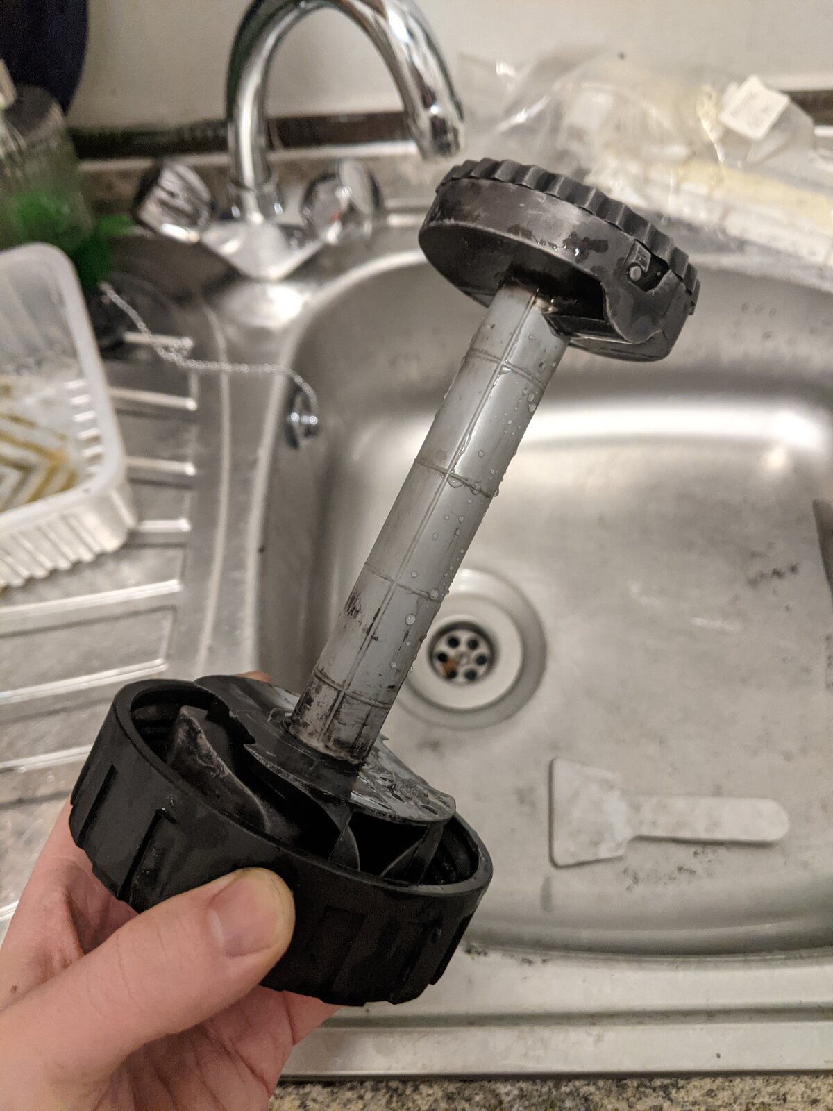

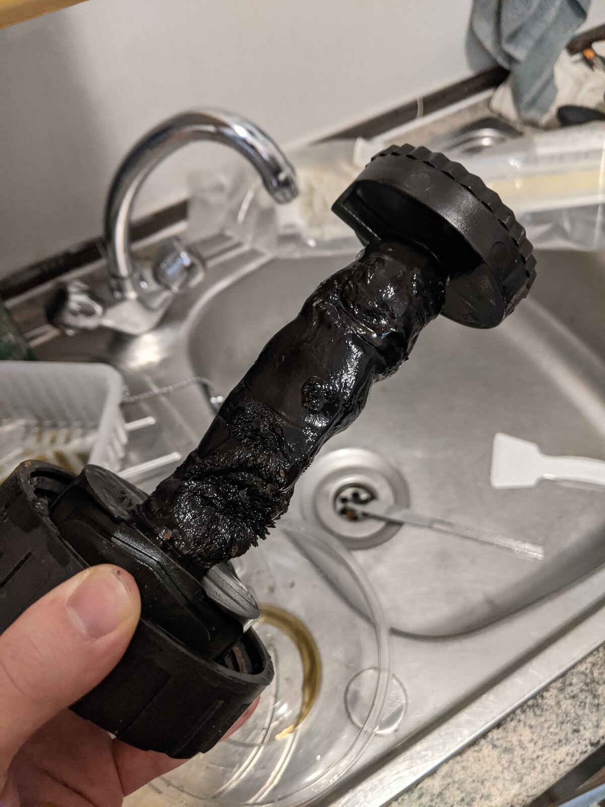

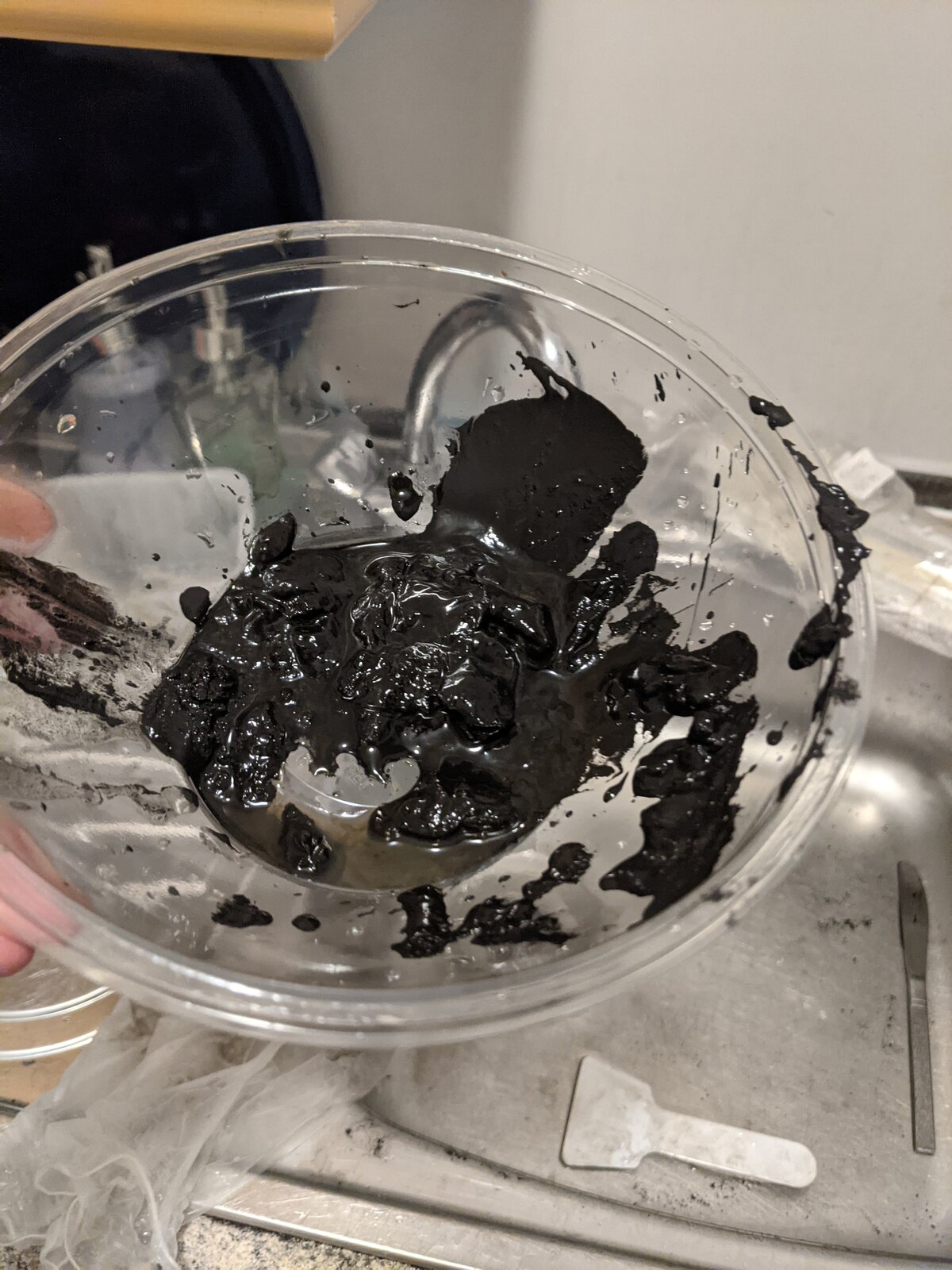

I've cleaned out the magnaclean, not sure how clean I'm supposed to get it but took the sleeve off and scraped off all the crud and gave the rest a good rinse and a wipe down with plenty of tissue. I've attached some photos of the filter and the stuff I scraped off.

There's just a thin layer of what looks like the same sludge type stuff as what came off the filter in the dish, no mud
That is a fair bit of sludge, inhibiter should be checked every year. Maybe you have built up quite a bit.

that's quite a fair amount of black sludge. Do you know when it was last cleaned? If it has not been done since the boiler was installed, it's understandable.
Put it back and have another look in a month or so. If there's only a smear, that's OK.
It should be sufficient to check it around once a year, there should be nowhere near as much as you found.
The black iron oxide arises when the steel radiators corrode in the presence of air.
