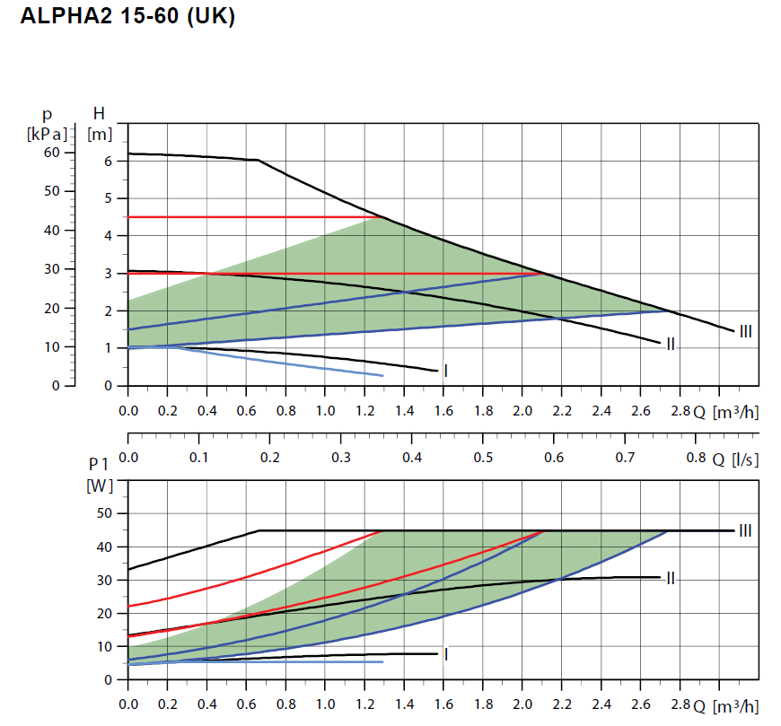

I think this might be the chart for your version of this pump. The newer version seems to use fewer watts (max 35W). @Johntheo5 will be able to explain it better than I can. It might be interesting to switch to Proportional Pressure 2 (PP2) briefly, just to see how many watts that gives. Ignore the lowest blue curve, that is some sort of low power night time setback setting.

From the (if your) pump curves, at 20W & fixed speed 2, you are circulating 12.0LPM (0.72m3/hr) at a pump head of 2.8M, if you change to PP2
then you will circulate 9.8LPM at 1.9M, which may be OK, the power will then fall as the TRVs are closing in, its only the press of a button.
A rad running at 75C/63C, dT 12C, will give almost full output, if you reduce the flowrates still further to give 75C/55C/dT 20C, then the rads will still ouput 87% of their rated output, the TRVs (if) throttling down) will then keep reducing the rads&boiler return temp to give greater boiler efficiency.
It can be quite difficult to get a dT of 20C by throttling the L/S valves, if you leave them as they are now (dT of 12C) and just reduce the flow temp to 65C then the return temp will fall from 63C to 55C, dT 8C, but still gives the same boiler efficiency BUT the rad outputs will then fall to 75% of their rated output, probabl still OK most of the time and 65C should still be OK for heating your HW cylinder.. The TRVs will again achieve greater boiler efficiency when the outside temperatures rise requiring less rad output.
