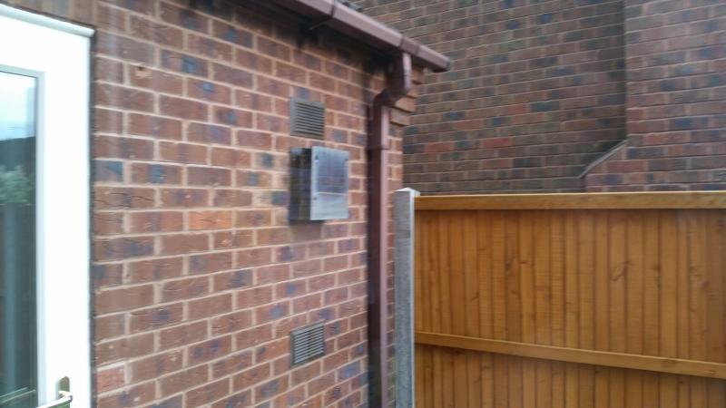

Looking at creating and semi undercover decked area to the side of our house. We want to attach a shade sail to the side of the house and garage. Unfortunately we have the boiler flue on the back of the garage and I would end up being semi undercover.
Shade sails when anchored to a surface sit about 200 mm away from the surface. So there would not be a sealed edge against the garage and house. In addition to this the two other sides would be completely open.
Would would having the boiler flue be a problem?
We would need to see exactly what is involved but usually a clear 900 mm would be needed around the flue!
