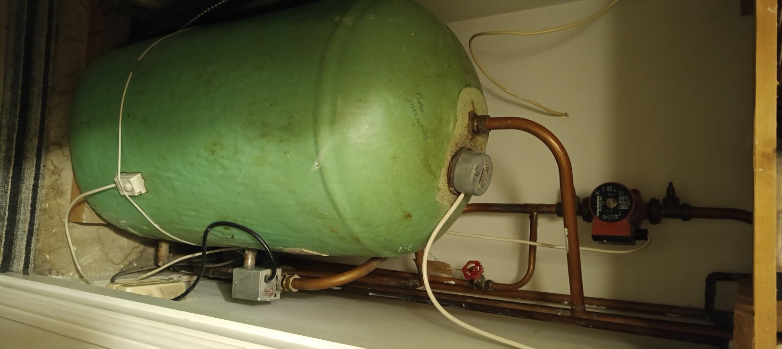

I have an Ideal boiler (ancient) with a Honeywell ST9420c control and one thermostat. I believe it is an S type system from what I have read.
I changed the control from an old Honeywell a month or so ago. The system seemed to be running as expected.
Now, the system keeps running when I don't expect it to. When the control isn't 'asking' it to run.
I've attached the airing cupboard. Well, a picture at least.
The Grundfos pump seems to be kicking in when I expect it to be off.
Any help identifying the issue would be greatly appreciated. My gas bill is getting a bit extravagant!
Hard to tell but looks like a y-plan. As above either stuck micro switch or incorrectly wired
Thanks. Am I right in assuming that, as there is no hot water when the problem occurs, it is the micro switch on the CH?

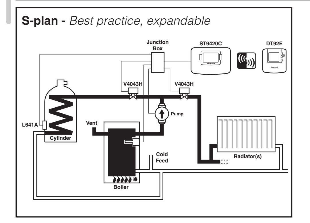

I thought it was S plan like the diagram attached as there are 2 no. 2 port valves.
I also have 2 x 2 port valves, and mine is C Plan. The plan you show is missing the by-pass valve, but is the basic S Plan. I have a spare micro-switch for my motorised valves, but changing it is not easy, I would want to swap the whole head.
