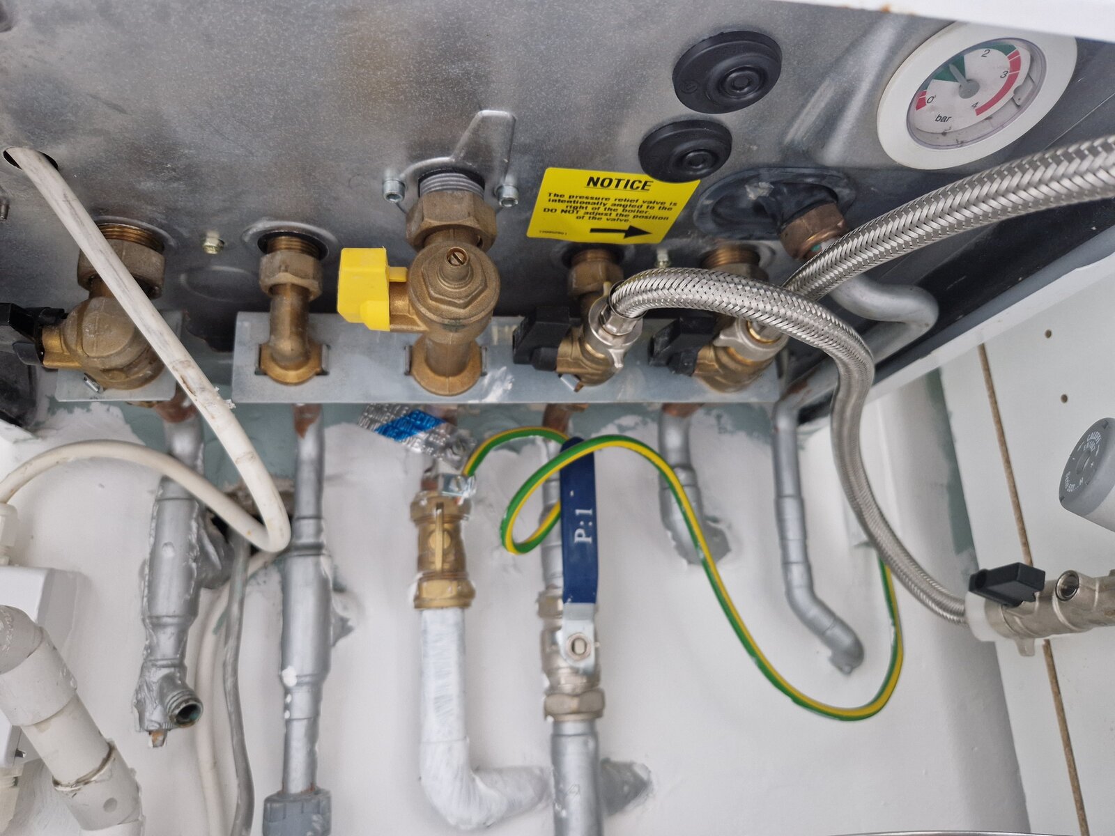

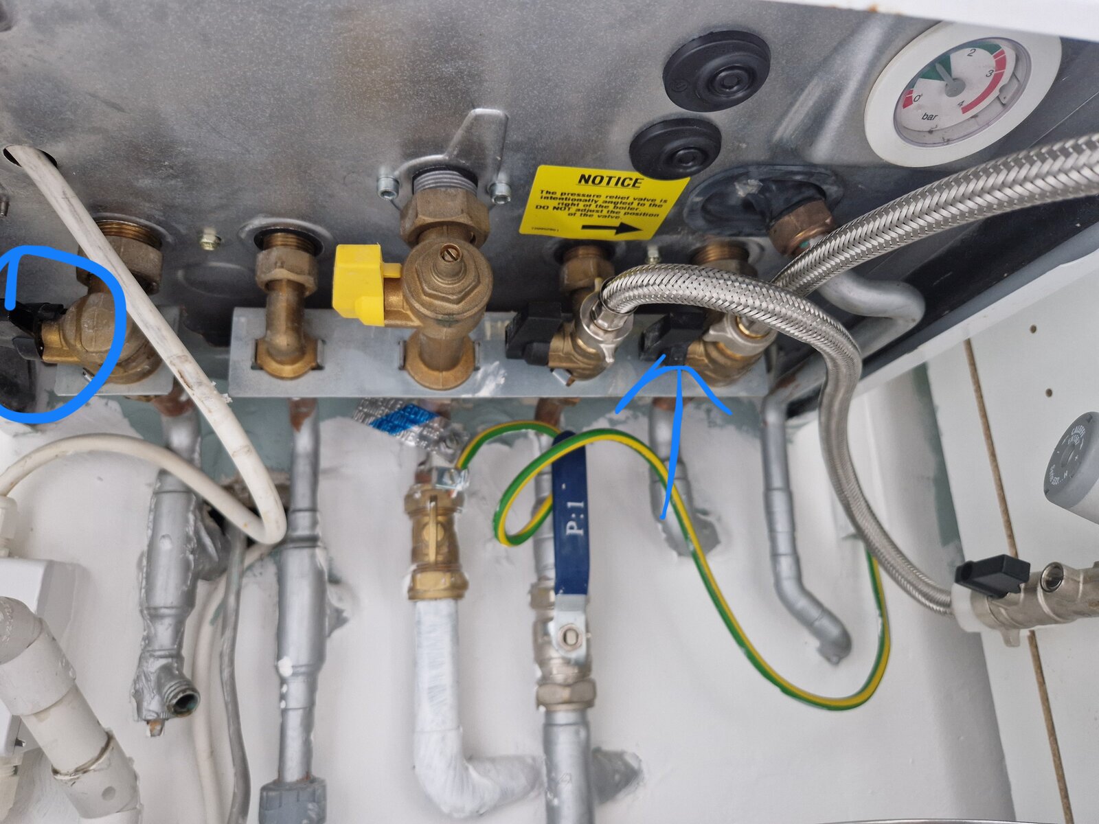

---> Can you help tell me which of these are the 1/ flow and 2/ return valves, on this photo ?

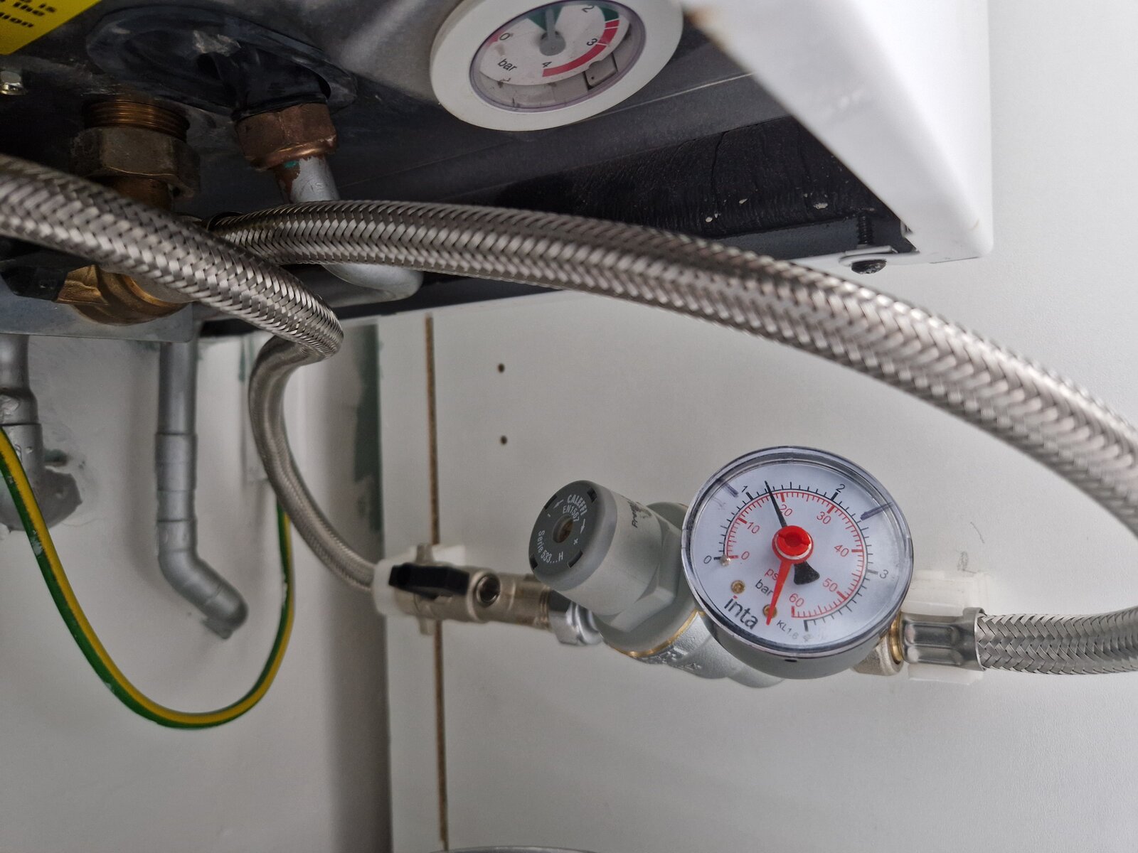

Also i am attaching what i call the "auto fill loop" (and yes, when its open, there has never been a perceptible drop in pressure, its always 1.1 bar cold, 1.5 bar hot). But i dont know if it is "designed" to stay open or not.

Have a look at this:
There you go, the installer has fitted a home made 'auto' filling loop. The flexi is coming from the cold mains inlet to a Pressure Reducing Valve (PRV) that's then connected to the return on the boiler. The PRV will be set to ~1.1bar and always open and it's a cheat IMO.
It reduces any calls backs for drops in pressure and will mask any issue with leaks/weeps. What it can also do, if there is a leak/weep present, is continually fill the system with fresh oxygenated water which will dilute any inhibitor and promote and accelerate corrosion.
You need to get an experience installer/engineer on board who is knowledgeable in UFH and advanced CH systems and get him to sort that out. It needs to be isolated from that 'auto fill' and then the system pressure drop identified and fixed. You have an extensive and advanced CH system and it needs set up properly.
