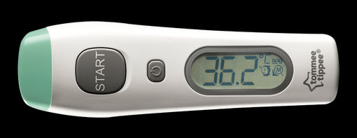

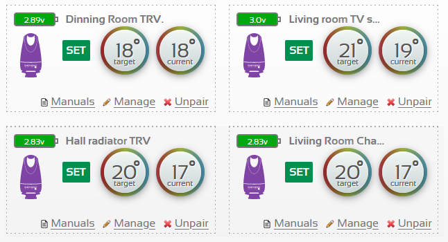

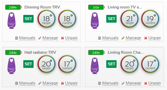

I tried to use an aim at surface type of thermometer. thermometer.jpg It did not work, I have a differential thermometer, but I have lost the sensors, and with electronic TRV heads, I really don't need to measure, 4 TRVs-1.jpg it shows target and current, and unless there is some other form of heating, current should never exceed target, so if it does, I just throttle back a little on the lock shield valve.
We balance radiators when using TRV heads for two reasons.
1) So with all radiators heating, each radiator gets its fair share.
2) So the radiator heats up slow enough for the TRV to react in time to stop any hysteresis.

I tried to use an aim at surface type of thermometer. View attachment 403933 It did not work, I have a differential thermometer, but I have lost the sensors, and with electronic TRV heads, I really don't need to measure, View attachment 403934 it shows target and current, and unless there is some other form of heating, current should never exceed target, so if it does, I just throttle back a little on the lock shield valve.
