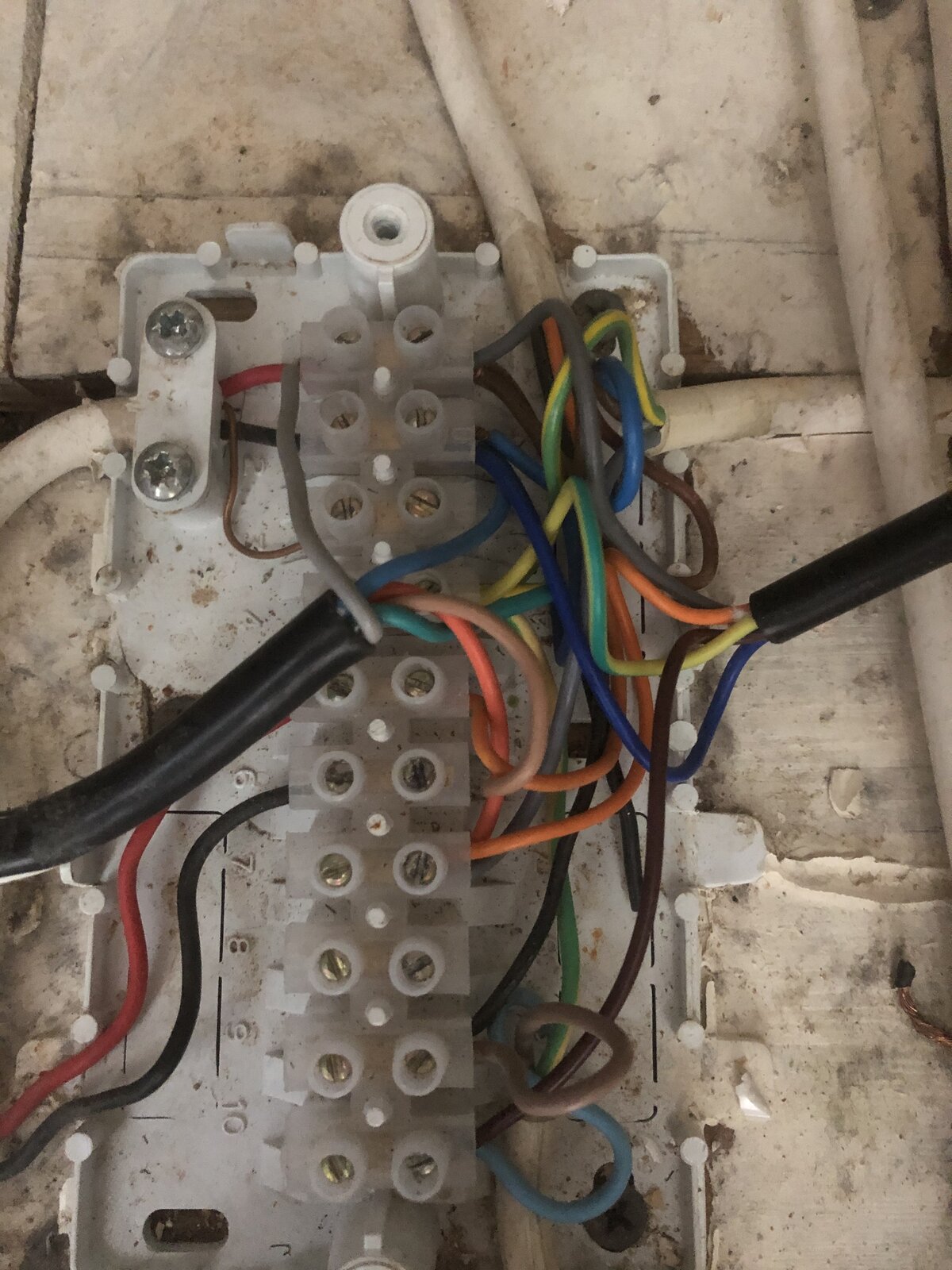

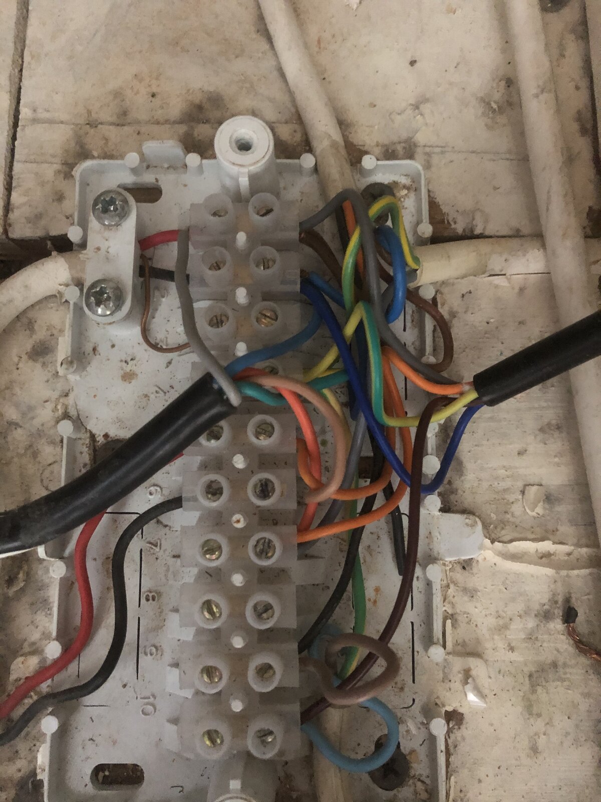

one thing though- my underfloor heating has decided to not come back on after the power was restored. Got to figure that out now!!
Ufh on another zone? Thermostat up?
In the bathroom next door. The extractor fan too isn’t working either. I can only think that the wires in the room next door where the boiler is are feeding into the bathroom and something must have been nudged. I did check them all to see that the wires were firmly in.
Everything else seems to work so I’m scratching my head here.
There’s neutral wire doesn’t look fully in, I’d say it must be a wiring issue.

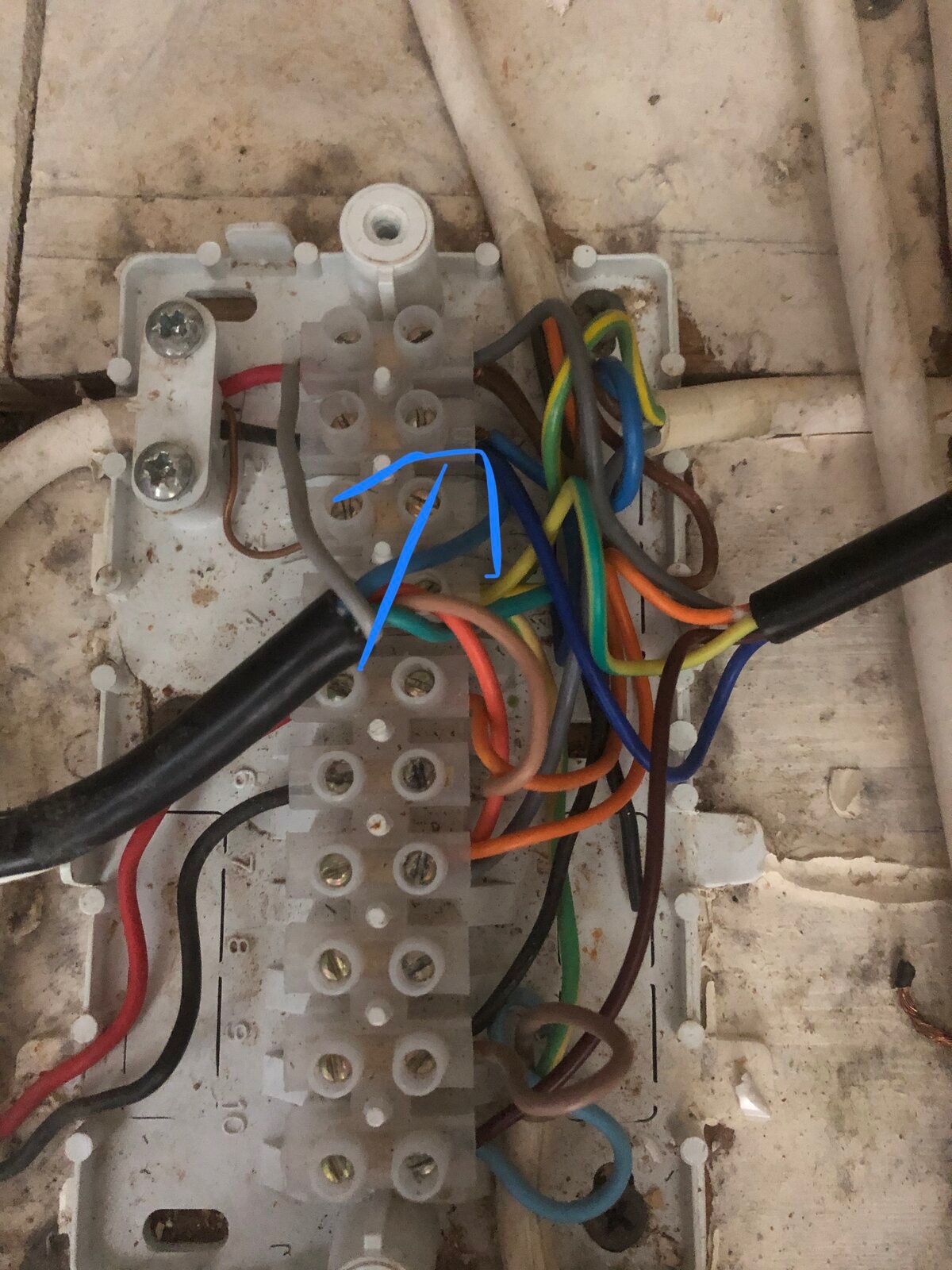

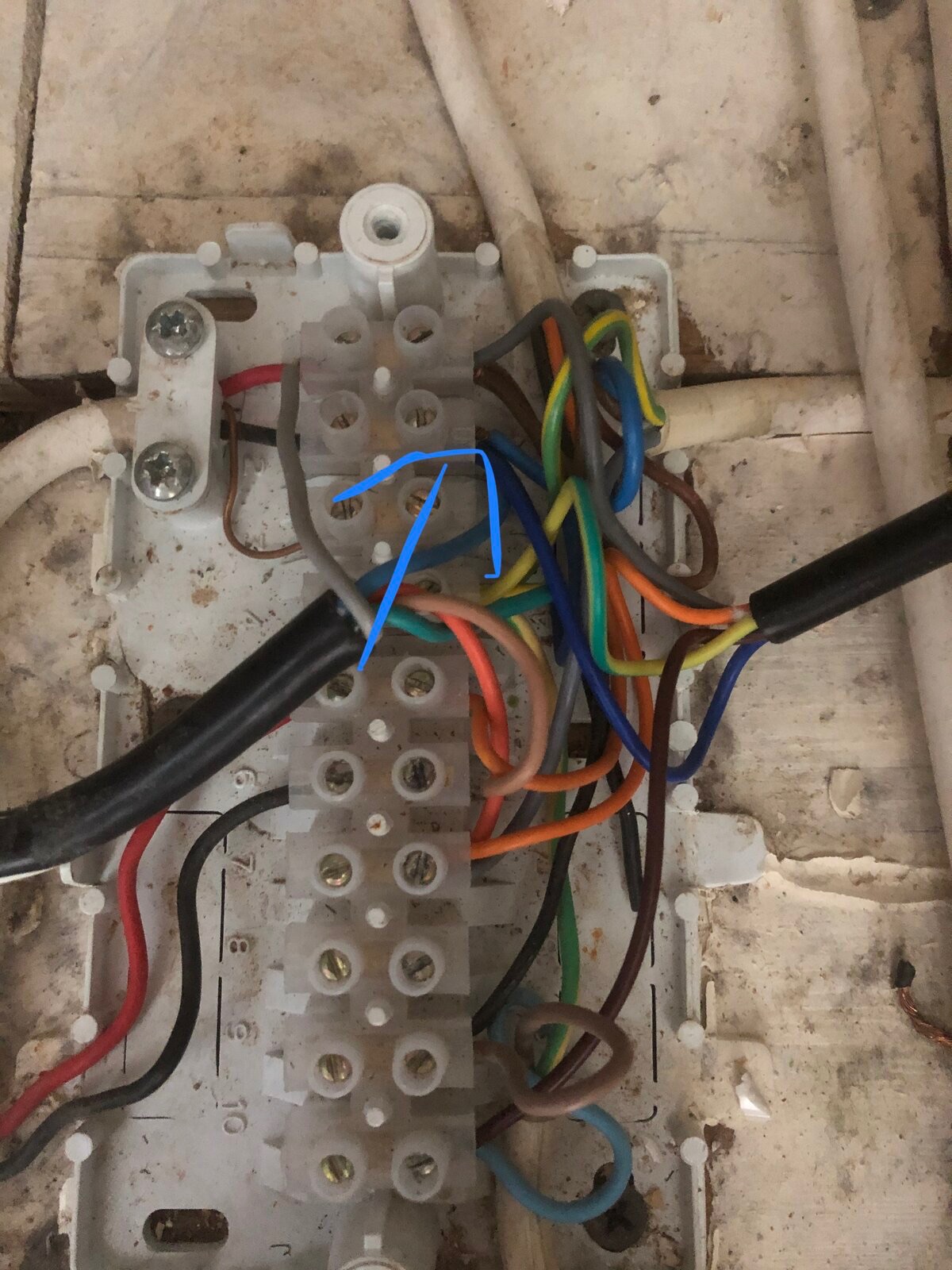

that was the original wiring. When you say neutral wire not fully in which wire/position do you mean? If you say the top left is A1 and top right is B1....
This one (marked blue)
Ah thanks. It was a bit loose but when I replaced the wires for the new valve I gave them a tug though it’s possible that there was a loose one as there were 3 in there (2 valves). Could that affect the power next door?
