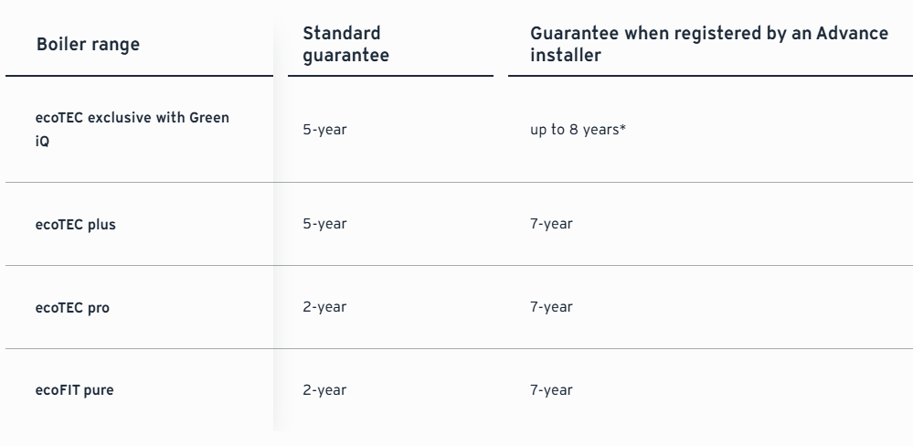

Some differences between Ecotec Plus and Pro are discussed in these posts. But this info might be out of date. The latest situation on warranties seems to be 2 years as standard for the Pro and five years as standard for the Plus. But it looks like both can be increased to seven years it seems if installed and registered by a Vaillant Advance installer. But please check this last point for yourself as it is probably the most important difference.
Ecotec Plus is an excellent boiler and carries a 10 year warranty when fitted by an Advance installer along with a Vaillant filter. Well worth investing in the sensocomfort controller as well for best efficiency, and the MyVaillant Connect gateway if you want app control. Your system needs to be clean, the method by which this is achieved will partly depend on its current state. If it's already very clean, a simple mains flush will suffice. If it's very dirty, a powerflush will be needed.
Thanks for all the advice everybody. I've found a local engineer who is also on the Vaillant installer website, he also suggests a replacement. I've chosen to replace it with another Pro, as the engineer says that the Plus might need some pipe replacement and our gas meter isn't too close, so extra cost. With him installing it I should get a 7 year warranty, but here it says I can extend that to 10 years for £150?
