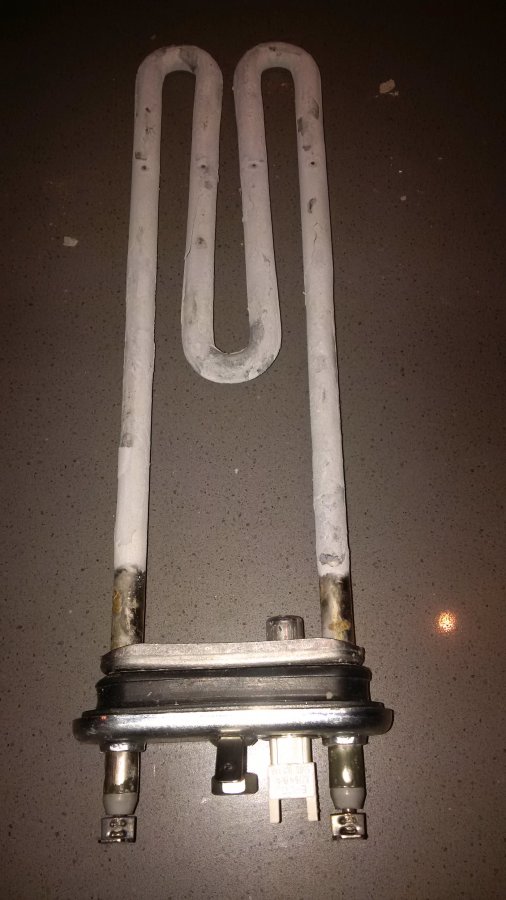

Well, I got the heater element removed and inspected it but it looks just fine.
I tested it with a multi meter and there is a resistance of around just 26 Ohms. I'd expected an open circuit but this was not the case.
Not sure where to go from here.

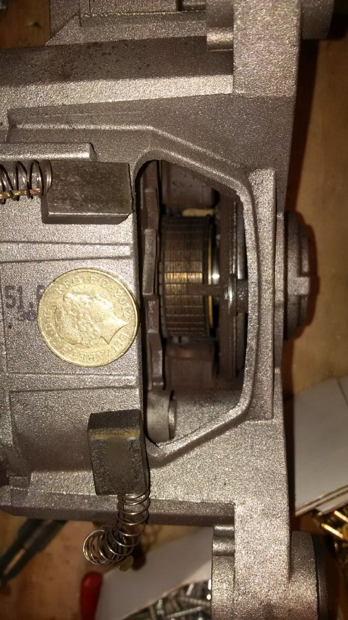

Does this look right for the brushes and commutator? I'd have expected them to appear polished.

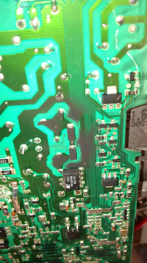

I removed the PCB and immediately could see signs of heat damage around a couple of the resistors.Thanks for
help, looks like the drum will become a planter for herbs now.
The problem with elements causing RCD to trip is because the internal heater shorts to the outer casing not because they go open circuit. This usually happens when the insulation breaks down under load so testing with a multi meter is no good, you would need an insulation tester. There is still a possibility that is the fault as I cannot see any burning in your pic.
