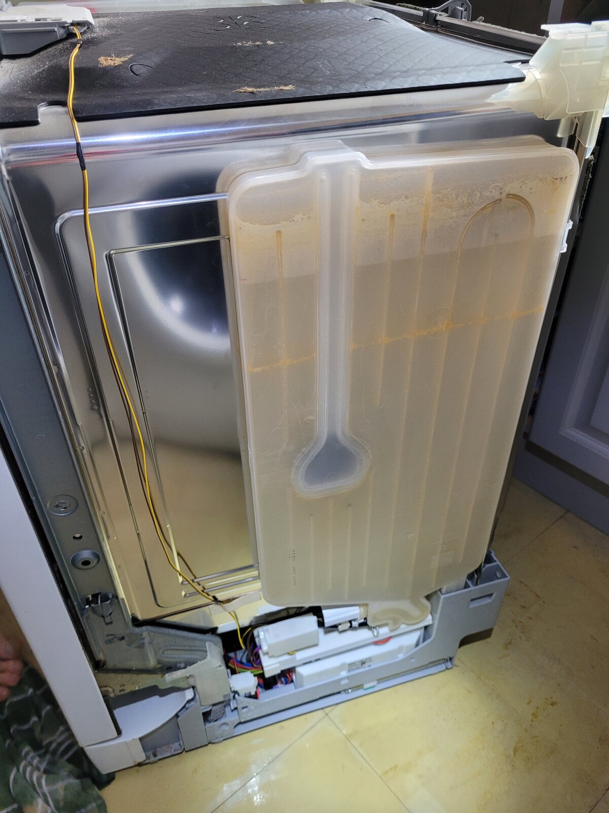

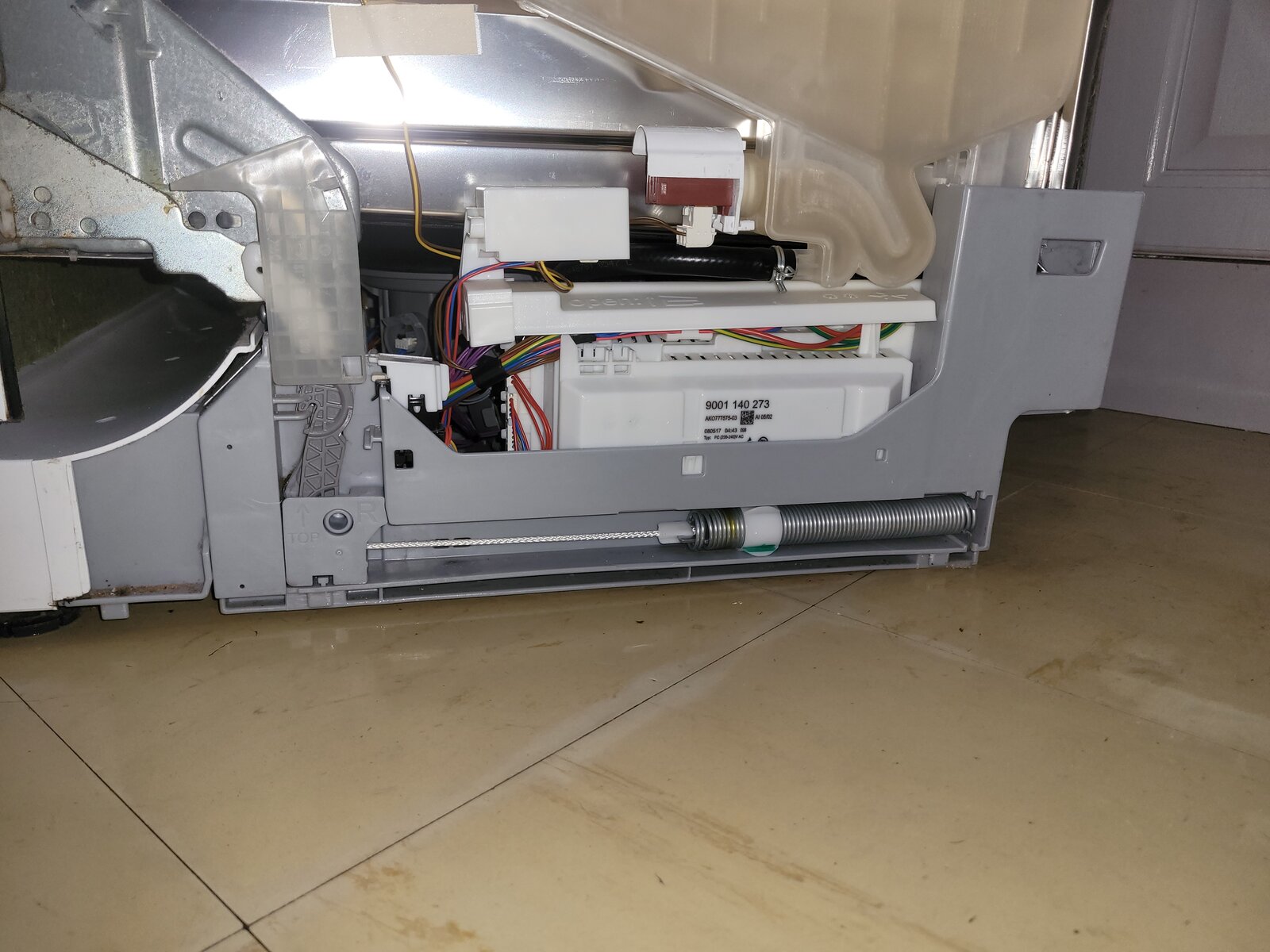

Hi, really hope you can help. We have the same dishwasher and problem and wondering if you would be able to describe how you got to the old pump to remove it. See photos of where we've got to, but now stumped at how to access it to take it out to replace it. Thanks for your time
Same question as Boschdishwasher above. Ours is a NEFF S515T80D2G, but with the side panel off it looks almost exactly the same. Thanks.
