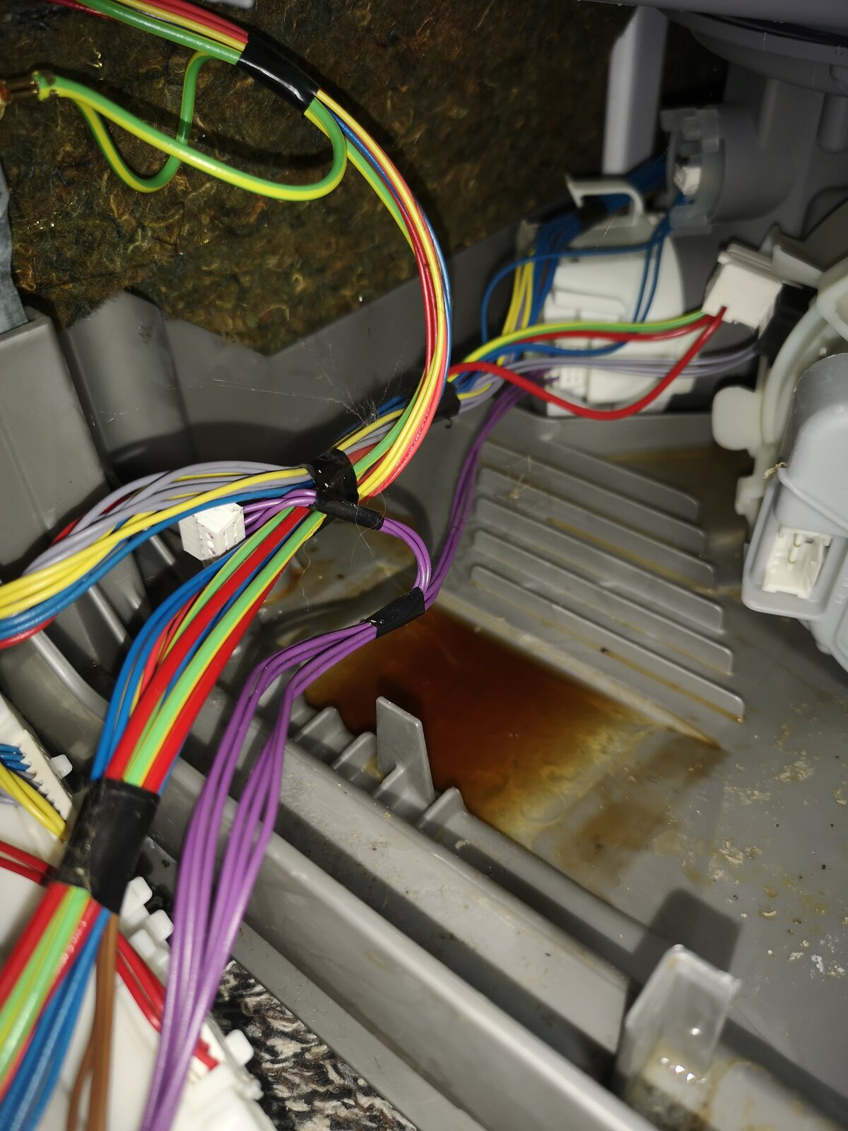

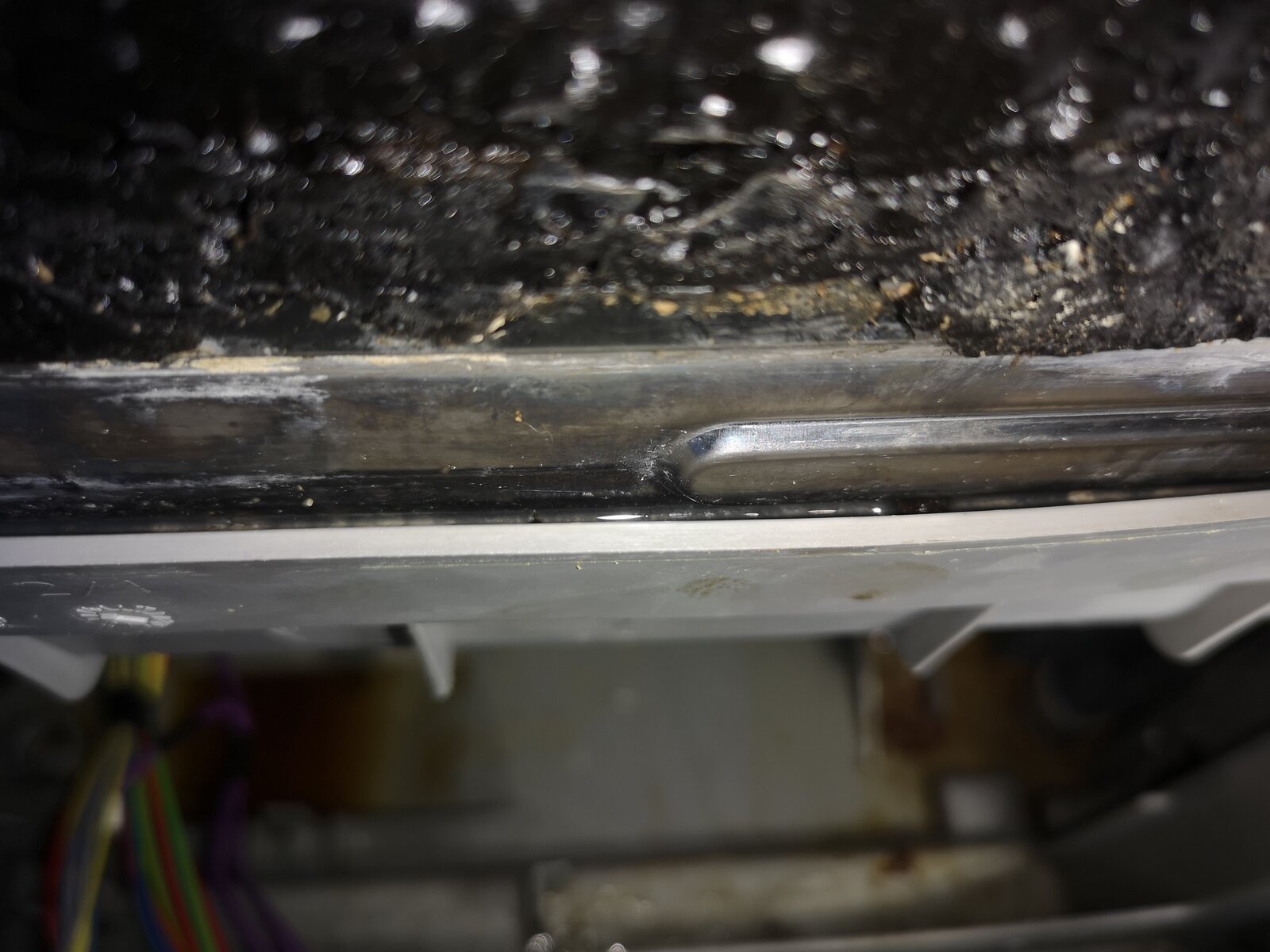

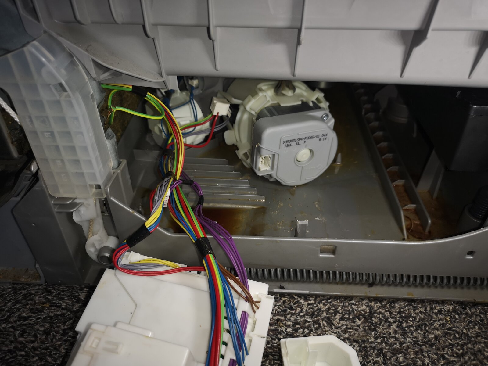

Just opened it up.
This don't look good!
This is exactly my machine.
Best video so far.
OL on heater terminals so looks like element.
Just not sure if water in the bottom is a problem? Looked grimy so maybe just a build up over time?
