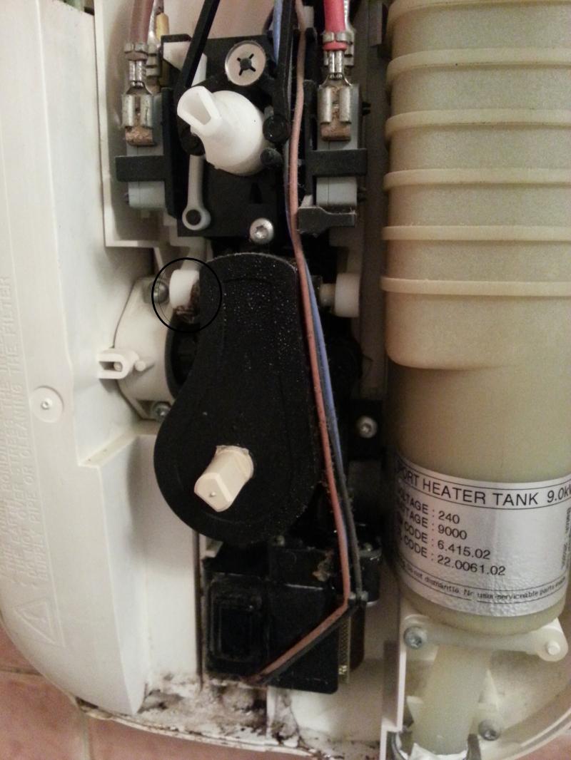

I have 2 Mira Sport electric showers and fitted Ecocamel Jetstorm showerheads to both on Christmas Eve.
Noticed water dripping from water outlet on Thursday so fitted new washers and ptfe tape for good measure - however, water still dripped from the base of the unit.

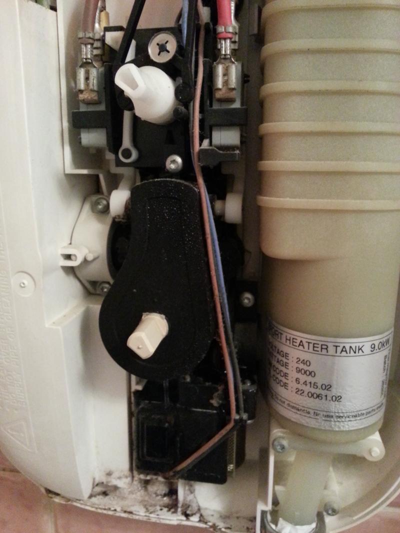

Opened it up to see water dripping down the front of the unit.
[picture 2 actually caught a drip running down the on/off switch]
It drips continuously down the on/off switch, so told my wife to use the one in the main bathroom instead.
That was on Friday. Sunday morning comes along and the other one is now doing the exact same!!
Is it sheer coincidence that both have gone the same way withing 2 weeks of changing over to the Ecocamels? I don't exactly have good water pressure - hence trying out the new showerheads in the 1st place.
Are my shower units serviceable.
Both appear to be leaking from exactly the same place [circled in picture1] and water runs down the back of the large black unit in the centre straight over the on/off switch.
Any advice appreciated
Homer
Get rid of the after market shower heads and fit the one designed for this shower.
You've restricted the water flow to much and blown the seal in the flow valve.
If it's leaking from the white arm spindle then it's a new flow valve approx £35.

The previous corrospondents are correct. Fitting a Non Mira showerhead to a Mira shower can cause serious performance issues such as the back pressure which caused the damage to your Mira Sport. Mira stocks a complete range of Spares & Accessories which are available to purchase either on line at www.mira.showers.com or by ringing our Customer Service Team on 0844 5715000.
