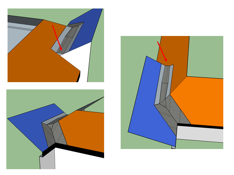

Hello,
I'm designing a box gutter for my extension, and could do with some advice.
The extension roof (shown in blue, only one pitch shown) is gabled. The extension wraps around the corner of the existing house, which has a hipped roof (shown in orange). I'm designing the box gutter and valley between the two rooves.
I'm wondering what to do about the point where the box gutter meets the gabled end of the extension (arrowed in red). I can't quite see how I can terminate the box gutter in such a way that the water won't be able to get through the cut corner of the felt. Would it be better to cap the end of the box gutter here, and slope it the other way all the way to the valley?
Any suggestions much appreciated.
Jack
Personally I'd slope towards the valley, you don't really want one roof draining onto another. Just make sure the lead where the arrow is, and down the gable that's not pictured, is dressed unto the existing tiles correctly.
The lead sheet association have a set of guides to help you with how to detail common situations, so if you read them you should get an idea of how things should fit together.
