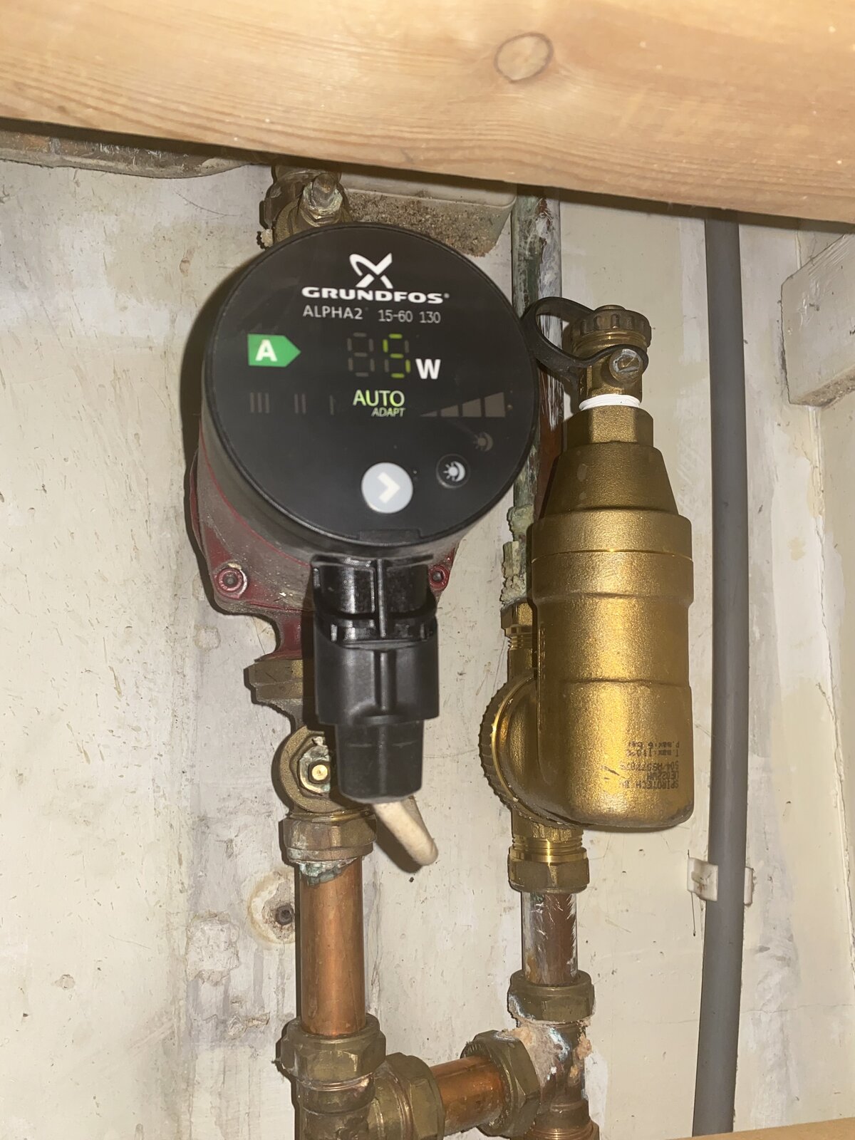

Really need help as getting burnt with hot water this summer. For over a month now my British Gas Up2 thermostat is not turning off (pic below). This is supposedly resulting in super hot water even with a slight flic to the hot side of the tap. Shower is also extremely hot (if leaning even slightly on hot side of tap) making showers unbearable.
The heating system is also connected to GRUNDFOS ALPHA2 (pic below). I don't know what it does but I've put it to the lowest setting possible, hoping it is helping keep the heating down.

BTW, in your second pic, which way is "up?"
The Spirotech filter works by particles falling, under gravity, to the bottom of the collection chamber. Has yours been fitted long?
I turned the image upside down when posting to read the letters :)
