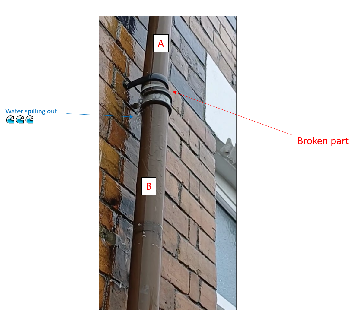

Hello guys,
Grateful for your help here.
In the image, A and B have become disconnected. What is a simple way to repair this?
Just a case of reconnecting.
Easier to remove one screw on the pipe wall brackets so bottom half slides up.
I think... Maybe.. Can't see well enough..
That's not the correct connection. Bottom should fit inside pipe with an open top.
Also you need plenty of tight pipe holders so the bottom won't drop out which I guess that's happened
I pushed it back into place last week. It appeared to work.
However, a few days later and it's back out.
Tighten the wall brackets or buy another and fit.
They clamp on pipe stopping the movement so I guess the current ones have become loose
