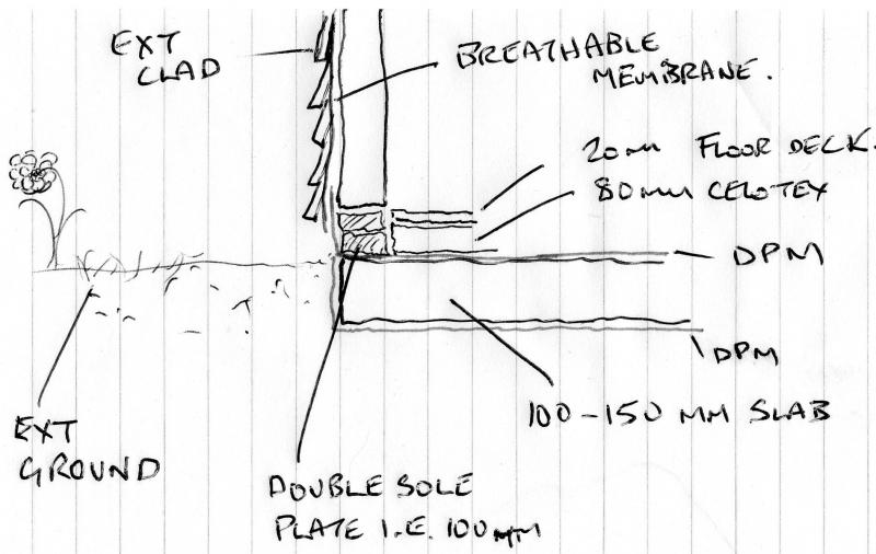

I would be thinking strip foundations and walls etc but that's because I'm a builder.
If you are going to build it all off a slab then do it robustly.
Cast the slab so that the top of the slab is level with the external ground level. Make the dimensions of the slab the exact size of the building footprint and no bigger. Use 1200g DPM.
Build your timber walls so that they are positioned on the edge of the slab. This is so that when you add the external cladding material, it is proud of the slab and is weathering it.
Allow for 80mm of Celotex plus 20mm of deck material when setting out your sole plate. Don't forget to add another layer of DPM directly beneath the insulation.
Thanks Noseall and thanks for the sketch too!
So in any and every case I should build a sole plate and make it the same depth as my floor materials? If I used strip foundations would I then just build a suspended timber floor?

Thanks for all the input so far. I've gone the concrete route and am having a foundation installed as I write: 6 piers of concrete (cast in the ground) and a 10 cm thick reinforced concrete slab on top with DPM underneath.
Looking at Noseall's drawing, should the DPM underneath the concrete slab come up the sides of the slab too or should it just sit between the hardcore and the concrete?

Concrete foundation is now laid but slightly larger than I wanted and not square :(. DPM goes up the sides of the slab. How should I best build on to it if I want to make sure water doesn't pool on the excess concrete and affect the sole pate. Should I just make the shed larger than I wanted (and overhang the sole plate where the sides are not square)?
Thoughts really apprecaited!!
thanks
Please? Anyone? Should I overhang the soleplate directly onto the concrete or add a one brick high wall for the sole plate to sit on or something else entirely??
