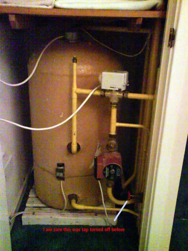

Hi I am new here and I am looking for a little advise.
I recently had a leak from the waste water pipe on my bath, at the time I did'nt know what the problem was - just water dripping through the kitchen light !
I turned off the cold water and ran the hot tap until it was running dry ( 1st mistake I think).
On repairing the bath waste my leak was cured but know my central heating and hot water system is throwing the towel in.
On turning on the hot water, my water pipes bang like mad for a few minutes. I have been into the loft and I have 2 tankls, a large and small one, both have water in them so they seem Ok.
I tried to bleed the radiators but the dont seem to have any air in them, my wife thinks I'm a muppet!

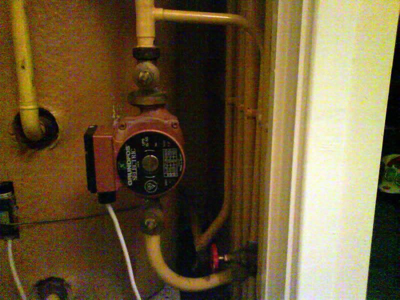

Here is my tank in the airing cupboard. It has a red valve and I'm sure this was turned off prior to the water leak, this tap is in the pipe which feeds to the top of the pump.
Any ideas you guys.?
Here are a few pics of my system.
That looks like the cold feed to the heating system and should be open.
The banging is probably lack of water and lots of air.
why was it closed and did you drain anything other than the domestic ?
Plus i notice you only have a 15mm return pipe on the HW.
Open that brass bleed and see if there is any air.

The tap in what you think is the cold water feed I felt sure was closed, there is another bigger tap higher up that is also open.

Dont know if its my eyes but from the fuzzi wuzzi piccis, that looks like the by-pass, does it not?. which would have been partially open but to the unknowing would appear closed.

clf-gas - what does the by-pass do? I have it open at the moment
With central heating only (no HW) the system seems to work OK.
allows the pump to keep a sufficiant flow through the boiler should the TRV's on the rads close down.
Fully close it and then open about 1/4 turn.

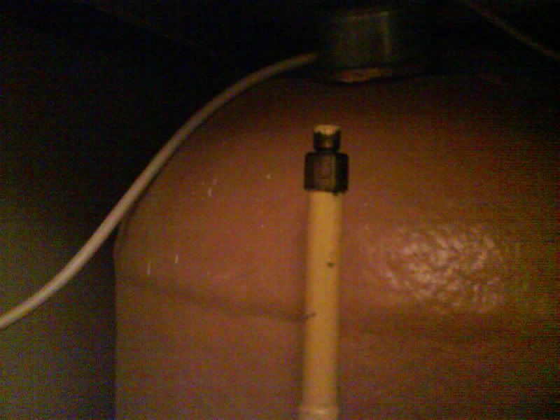

Sorry a litle drunk now, but reading your posts you have air in the system, this needs bleeding out.
EDit, ps bleed with towel to hand and boiler/pump runnig
Bleed all the rads sterting down and working up, then with the aid of a partner ask them to switch over to hot water demand whilst you have the air vent open at the cylindeer towel in hand.
excuse the typos fingers aint doing wot the stella and JD is tellin um :lol:
Thanks Craig - what does the air vent at the cylinder look like - is it like this?
Thats the fella, unscrew the top but dont take it right off.
