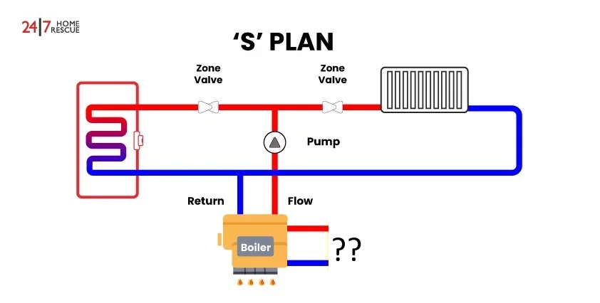

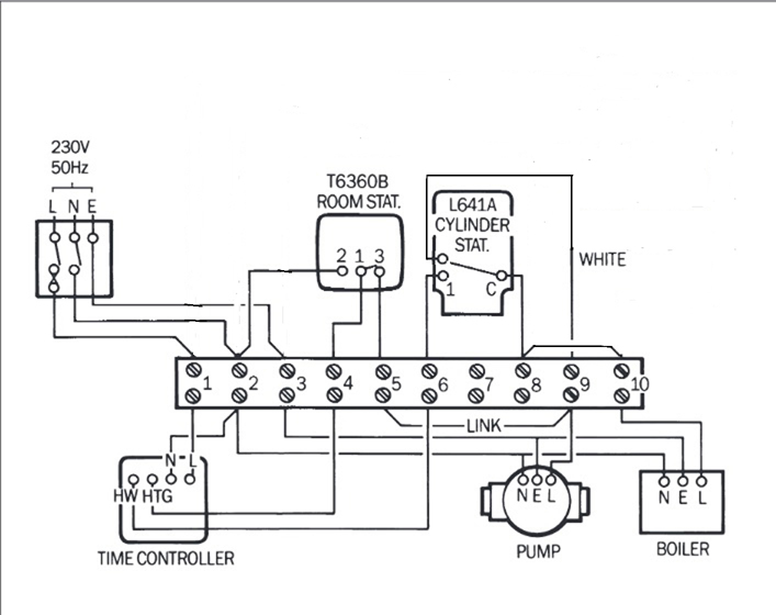

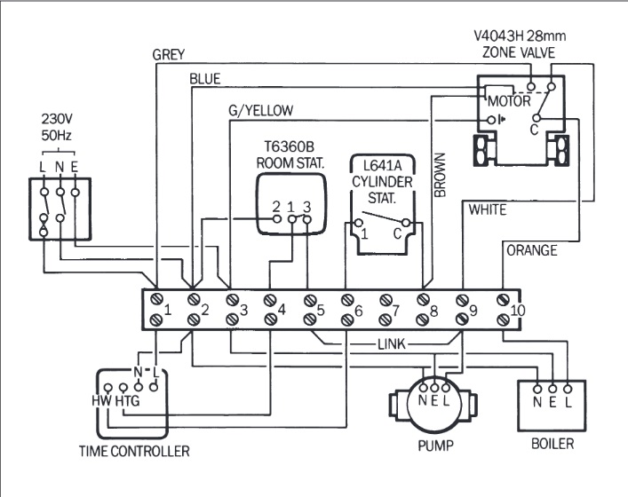

Mine is a vented cylinder. I am no plumber, I employed a plumber to fit the motorised valves, may have been better to have fitted non-return valves?
I have a few times wondered about having the pump on the return, which means can't really have a by-pass valve, as no pressure to open the valve, maybe others can explain, as said I am an electrician not a plumber.

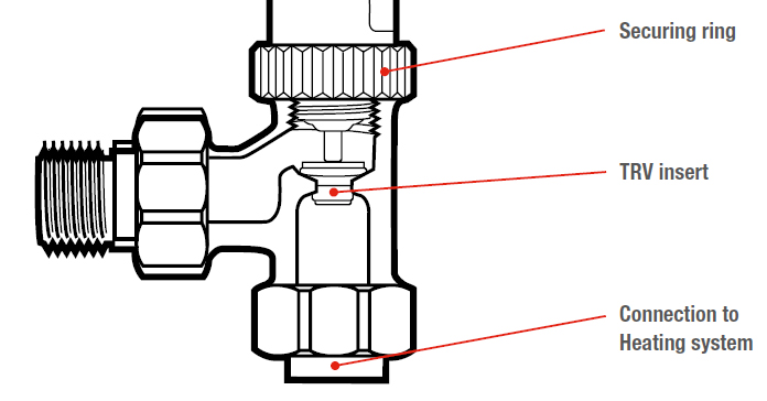

I suppose for main house, there is no real need for the motorised valve? In theory, if the TRV heads have closed the valves on each radiator, then no real need for the master zone valve to close the supply off. But the main house radiators did get warm, I look at the TRV
View attachment 395666and wonder if it can be sucked off its seat? But I found before I fitted programmable TRV heads, the old heads marked *123456 have a huge droop (the difference between fully on and fully off) so set to keep room at 20°C will still likely let some water through at 21°C.
